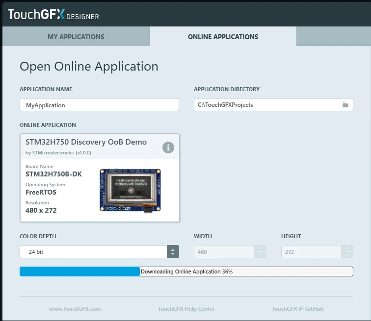

Hi @Martin KJELDSEN​
I successfully downloaded the STM32 Discovery OoB Demo using touchGFX designer 4.13.0, but it cannot be simulated. Why is this?

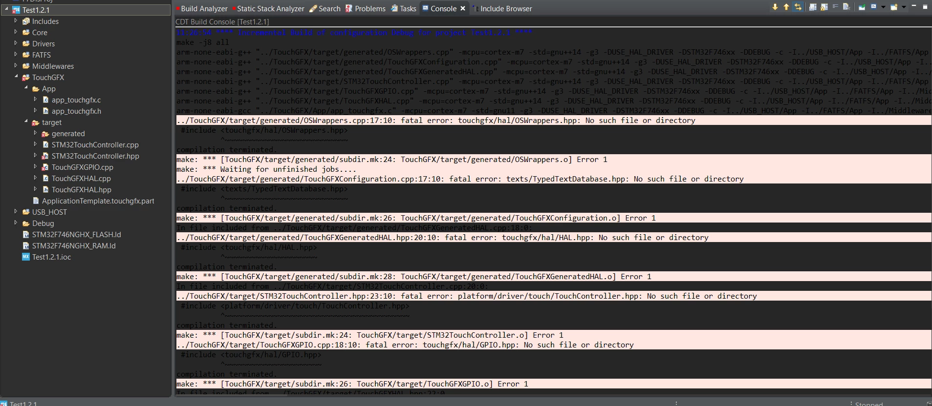

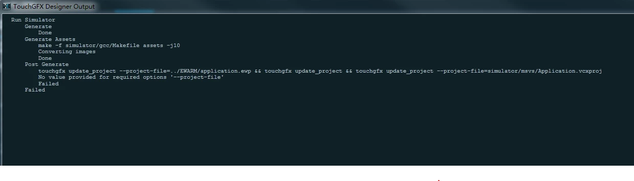

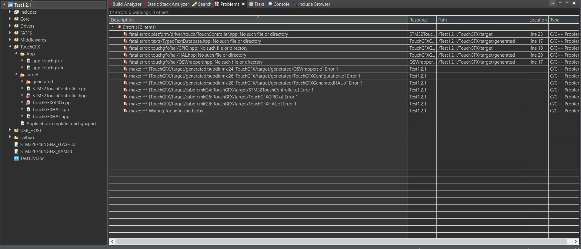

​  Hi @Martin KJELDSEN​ Thanks for posting the update. I am having some issues with the project generation . I have done all the updates. STM32CUBEIDE, CUBEMX and Touchgfx are all on latest releases, Trying to generate the project for STM32F746 Disc board using STM32CUBEIDE with Touchgfx and I am getting the following errors. Your help in resolving this is much appreciated.
Regards
