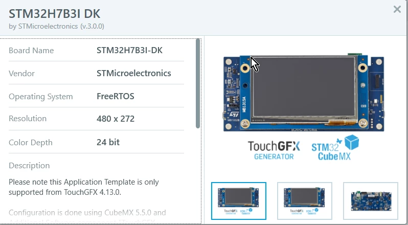

  • STM32H7BI-DK v.3.0.0 (uploaded)
  • STM32F746-DISCO v.3.0.0 (uploaded)
  • STM32F769I-DISCO v.3.0.0 (uploaded)
  • STM32H750B-DK v3.0.0 (uploaded)

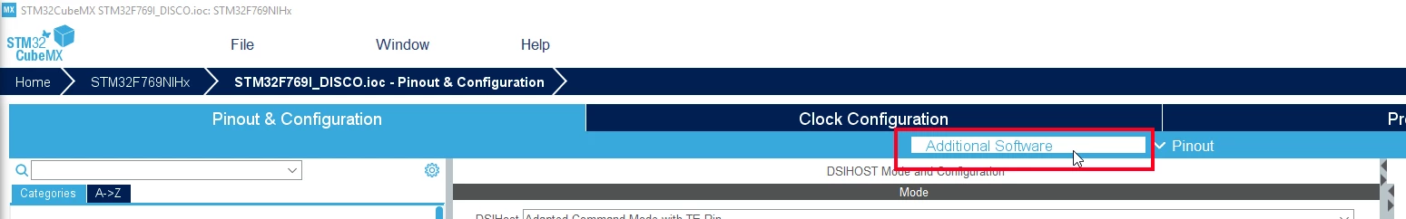

"After installing TouchGFX Generator through CubeMX or manually (See "installing TouchGFX"), users can now enable the TouchGFX Generator for almost any MCU in CubeMX. TouchGFX Generator is activated through "Additional Software""
Where is this "Additional Software" option in CubeMX?
Thanks,
Eyal
Anders Nedergaard PETERSEN
Senior II
January 8, 2020
Hi @egoltzman​,
The "Additional Software" option is located at the top of CubeMX
Best Regards
Anders
Martin KJELDSEN
Principal III
January 8, 2020
Hi Eyal,
That's the most asked question so far, so we'll go ahead and update the live documentation to explicitly mark where "Additional Software" is actually located.
/Martin

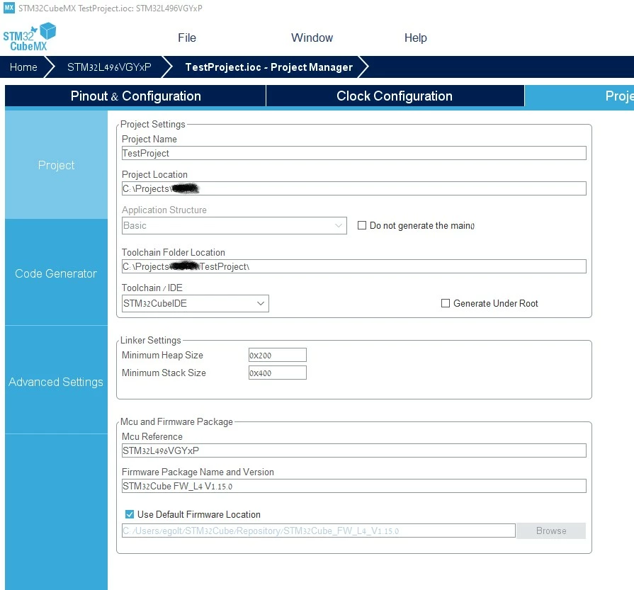

After following the list of actions I generated a project for STM32CubeIDE (attached) but was not able to get a project that can be loaded to the CubeIDE.
I guess this is an issue related to the CubeIDE\CubeMX group, is it?
Any pointer? Idea how can I solve this?
Thanks,
Eyal
Martin KJELDSEN
Principal III
January 8, 2020
You don't seem to have generated a STM32CubeIDE project (it's not present any way).
Please try selecting "Advanced structure" and do not "Generate under root" when generating your project in the "Project Manager" tab.
Ensure you have 64-bit version of Java installed, or you won't be able to generate CubeIDE projects either. I know this is something CubeMX team is looking into.
/Martin

Try selecting the Advanced application structure in a new project and try again.

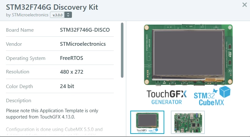

CubeMX does not care about board related stuff. SDRAM CAS Latency, QSPI Memory mapped mode, etc. Only MCU configuration. I doubt it ever will. As long as you have your code in USER CODE sections, it won't get overwritten. There's an application template for F746G-DISCO using the new generator available through the 4.13.0 designer.
