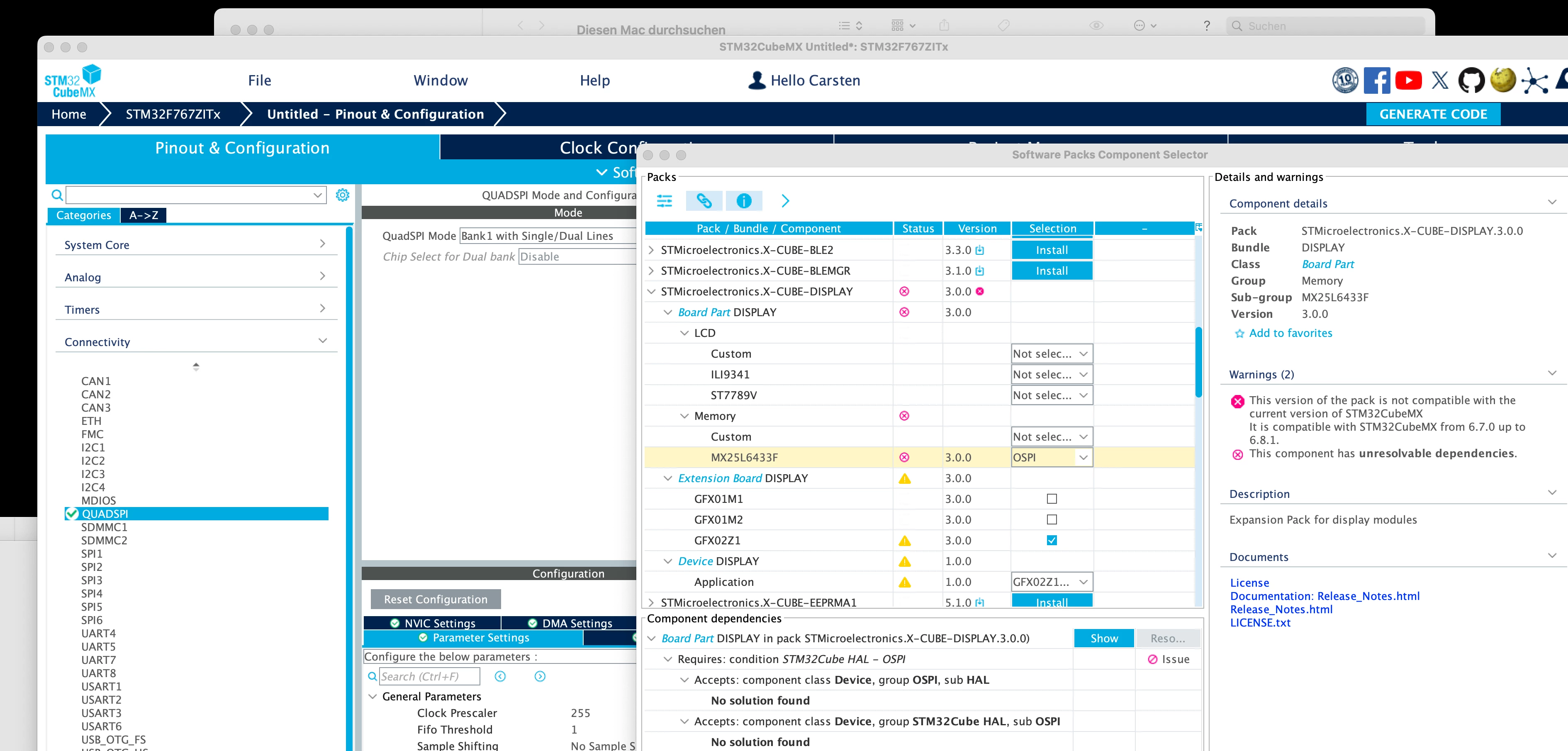

Nucleo-f767zi and x-nucleo-GFX02zi CubeMX and HelloWorld
I am new at the STM32 World.
I started to buy a nucleo-f767zi and it worked fine.
I was not able to get the debug Console running. Like other too.
Because of that I bought the extension Board  x-nucleo-GFX02zi which should be working fine with the F767ZI.
Now I tried with CubeMX to installed the Hello World Example provided.
But now I get the Message that these Packets is not Support with CubeMX 6.11. It should be support by Version 6.7 until 6.8.2.
I tested 6.8.2 and 6.8 but without any changes. It seams like the SPI does not fit together. Always I got no solution found.
Does the GFX02zi can be used with the F767ZI? Or do I have to everything new.
I am going a bit crazy.
Is there anyway a working step by Step intruduction for Add a Display to a STM32.
Thanks for any help
best regards
Carsten

Hello @Carsten73 and welcome to the community!
So you are trying to use the "Hello World" example from STM32CubeMx?
I am not a STM32CubeMx expert, it seems like using an older version of STM32CubeMx should have solved your problem but it did not :| .
I recommend you to create a new thread clearly stating your issue related to STM32CubeMx on the sub forum specific to STM32CubeMx : stm32cubemx-forum
Yes, the STM32F767 nucleo board is compatible with the GFX02z1, see this link : x-nucleo-gfx02z1
Yes, we made multiple guides on our documentation : TouchGFX documentation
There is specific documentation about how to "create a custom board" : development-introduction
Keep in mind that starting on a new environment is not easy at first (especially in the embedded world) but I personally think that ST made a great work keeping it as simple as possible and as clear as possible.
Also, doing graphics in embedded systems is another difficulty because of the limited resources of embedded devices. Here at TouchGFX we did the heavy lifting, but there is still some specific setups to do.
To help adding your display to the STM32h767, the easiest could be to Download TouchGFX and create a new project that is using a GFX02Z1 (the only ones we have are using a STM32U575 or a STM32H563). By doing that, you will have a working project that could be flashed into the mentioned boards, this is what we call a TBS (TouchGFX Board Setup). You can use this TBS to setup your own board (STM32F767) as it would be similar in some ways.
Finally, to learn about STM32 in general, I would recommend you to watch the Digikey Youtube series : Digikey STM32
and to look at the ST Academy : ST Academy
I hope this helps you, if it does, I invite you to select this comment as "best answer".

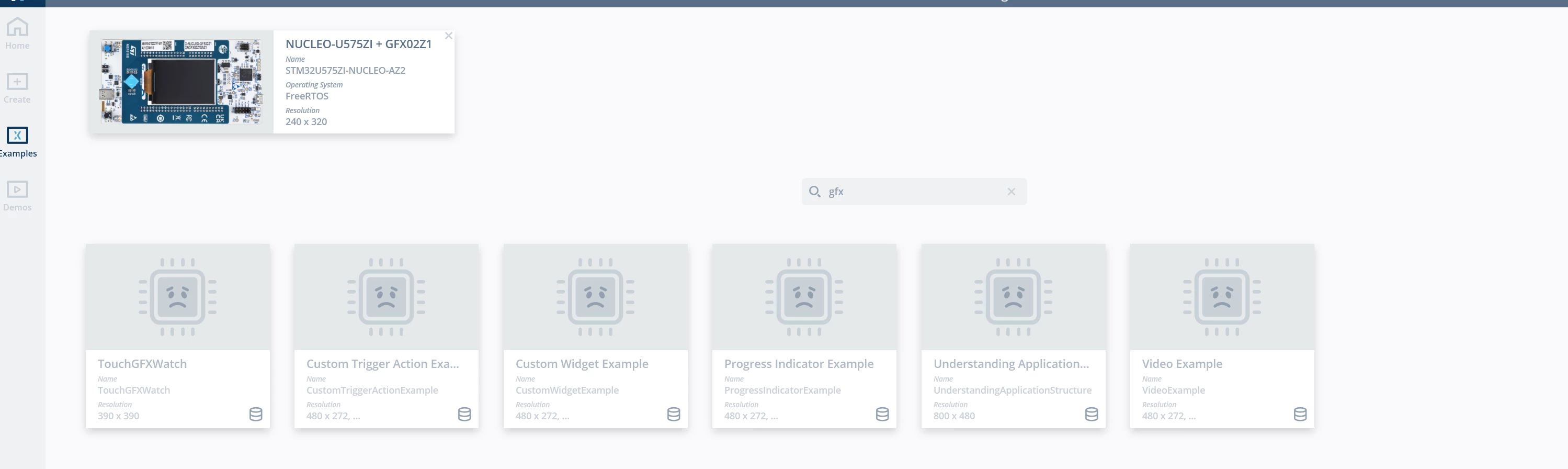

Carsten73Author
May 17, 2024 7:01 PM UTC
Hi Gaetan,
I followed your guidance to use Touchgfx instead and use the starting Point of a existing Example for the LCD Board with STM32U575.
See the image attached. If i go in detail, no example is available. The resolution does not fit and I am not able to choose one to move forward.
Thanks
Carsten
GaetanGodart
May 21, 2024 9:00 AM UTC
Hello @Carsten73 ,
Yes, we don't have examples for 240*320 pixels screen.
You should be able to create a blank UI :
From there you can add elements in Designer.
If you really want to see how examples work, you can just select them without selecting a board but instead selecting the simulator.
Regards,
Gaetan GodartSoftware engineer at ST (TouchGFX)
