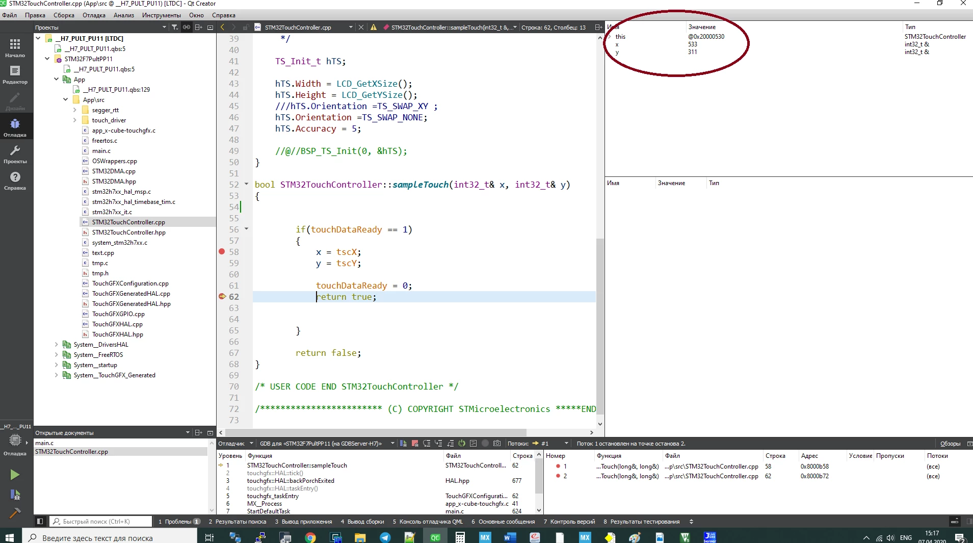

I have my own development board on STM32.
TouchGfx 4.13.0 is ported to it.
Displays box, button, scrollbox and text.
The coordinates of the touchscreen I pass to
bool STM32TouchController::sampleTouch(int32_t& x, int32_t& y)
 if(touchDataReady == true)
 x = tscX; // tscX is correct and given from I2C4 STM32H7BIT6
 y = tscY; // tscY is correct and given from I2C4 STM32H7BIT6
			touchDataReady = false;
 return true;
 return false;
This function is permanently called from the TouchGfx kernel.

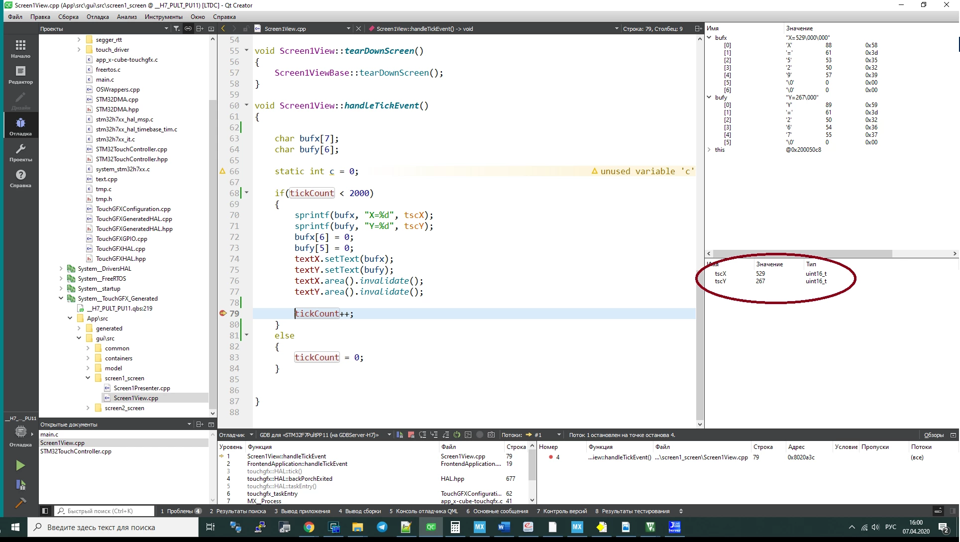

On "View", the overrided "handleTickEvent()" works well, but my overrided
"handleClickEvent()" not called.
The screen does not respond to clicks.

I'm assuming you're not posting all your code from the sampleTouch() function.
Are you able to break inside the sampleTouch() function following the condition if(touchDataReady == true) ? (this code will only execute once since touchDataReady is set to "false" immediately after.
/Martin

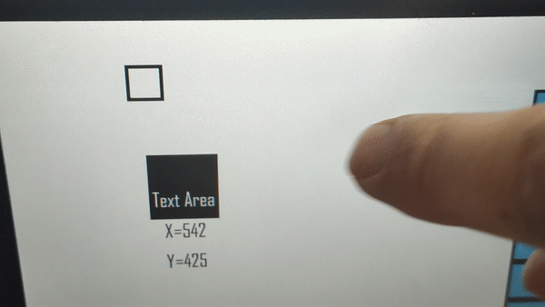

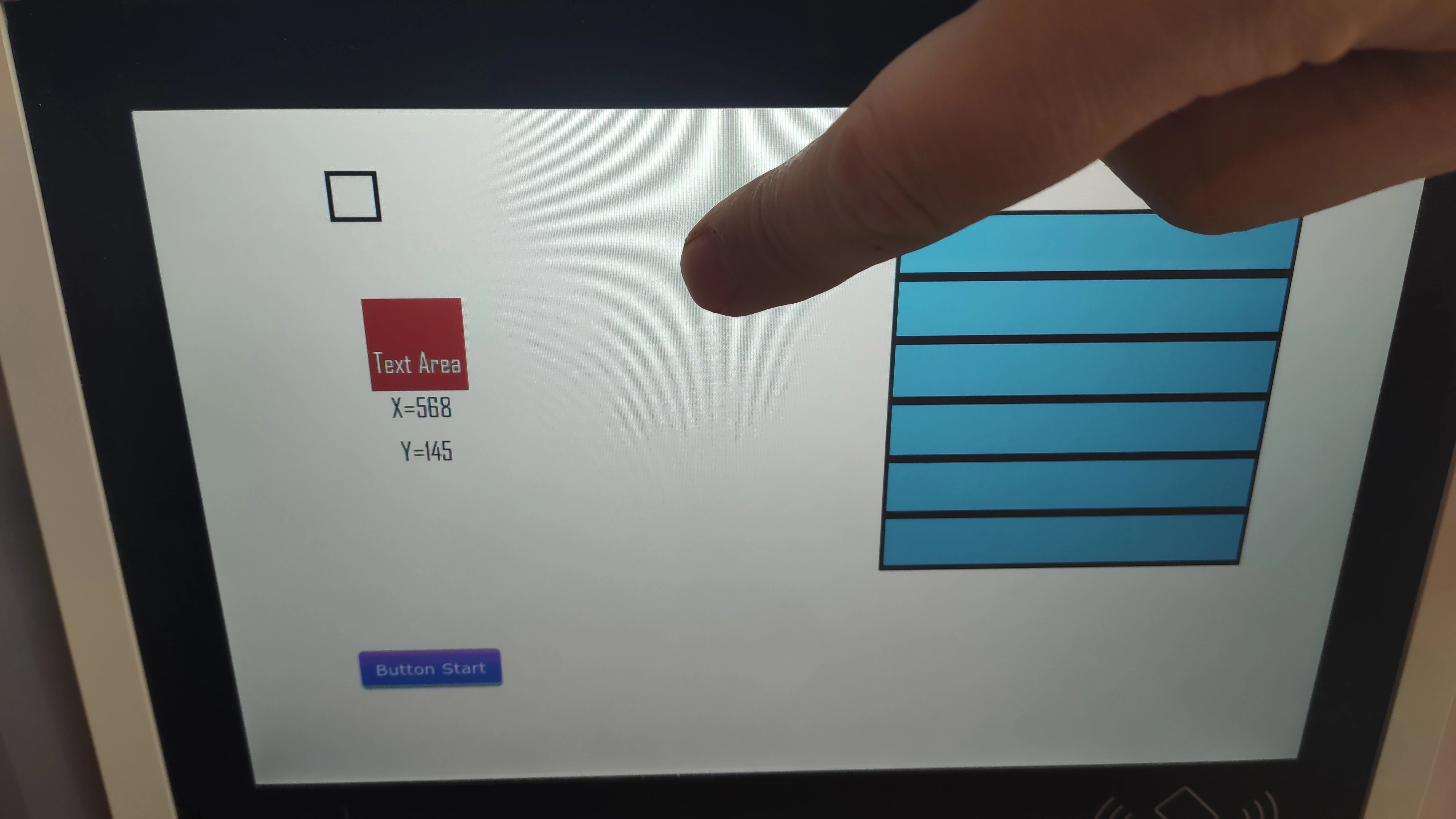

Thanks for the answer Martin!
Variable touchDataReady sets true in I2C Interrupt,
when touch-panel data occured from I2C bus and translate to display-coords 1280x800
X=568
Y=145
is the real coords of my finger.
This coords Im passed via handleTickEvent.
They smoothly changed follows up my finger.
TouchGfx not take this coords from internal mechanics.
This is bool STM32TouchController::sampleTouch(int32_t& x, int32_t& y) function,
as i was always sure.

But can you hit a breakpoint where x and y are assigned? When returning true, the touchgfx engine will distribute the coords. Thanks
ANapa
ANapaAuthor
April 7, 2020
The breakpoint in this function always triggers

I can transfer all coordinates to handleTickEvent manually.
They change smoothly across the screen.

Suddenly, unexpectedly, the touch events began to work !!
Thanks to all! Thank you very much, Martin!
I will understand what happened.
