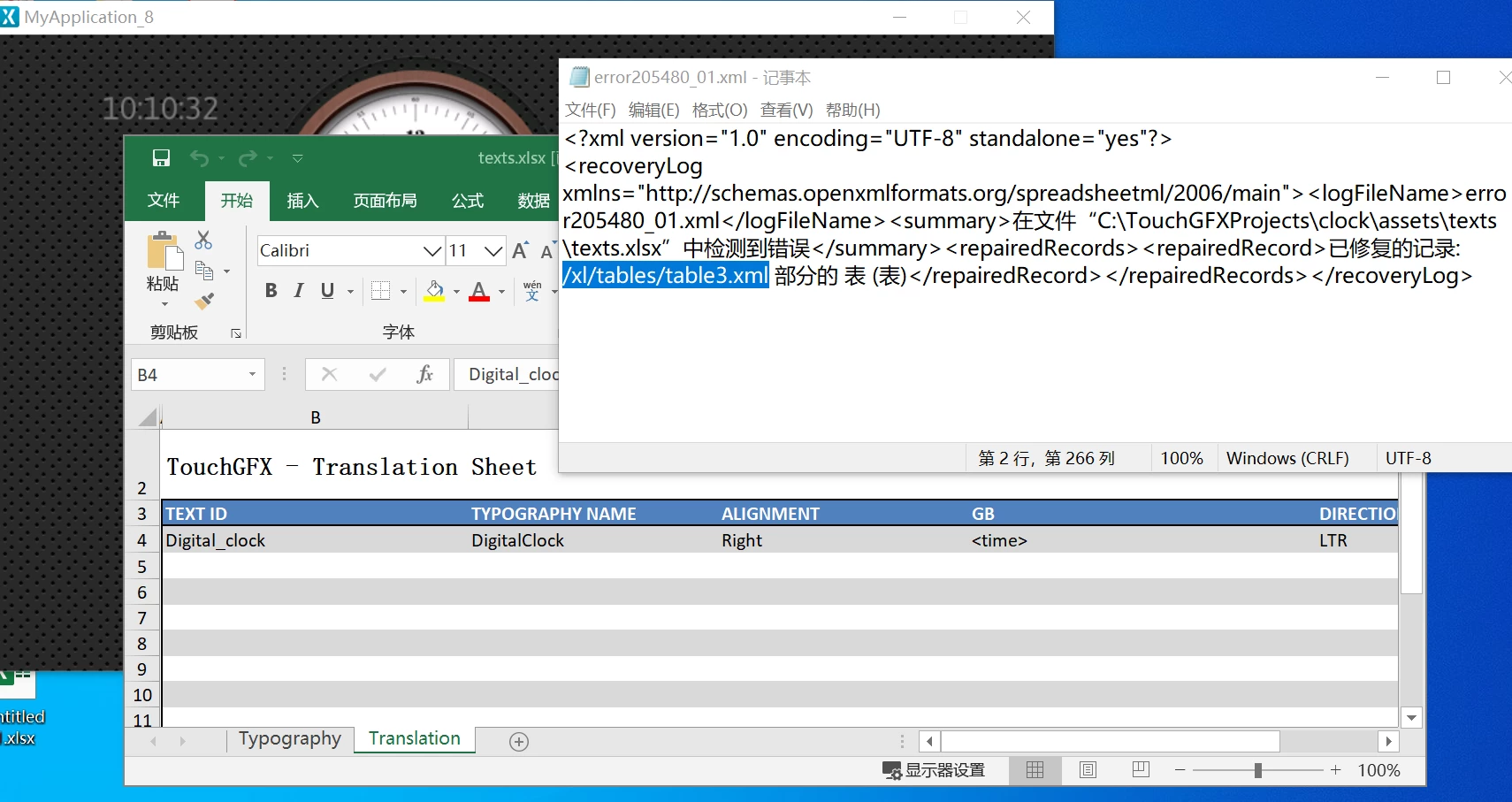

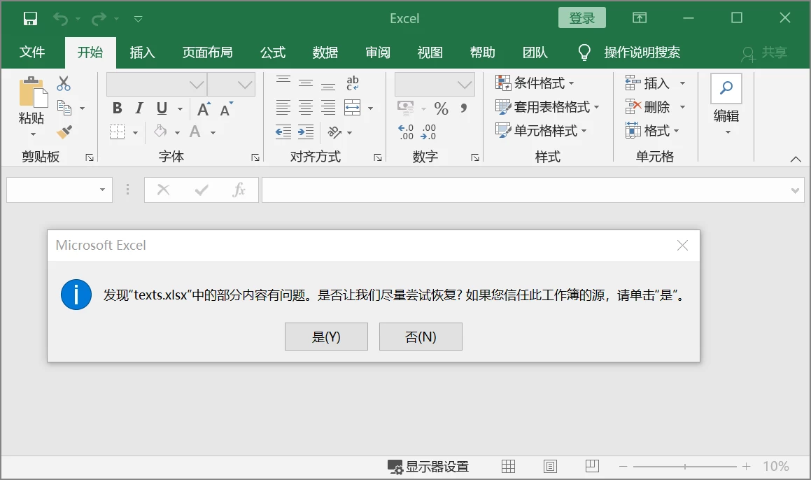

the chinese message is: some content has problem, shall I recover it?
If I select yes, designer will failed to load it.
if I select no, ms excel will failed to open the file.
even if I open the original file from your demo example, same error message is shown.

0693W000000VN8yQAG.pngevery demo are failed, this is screen shot of analog clock.
there are 3 sheets in file? I see only 2, the error message looks like "xl/tables/table3" has error and is removed
