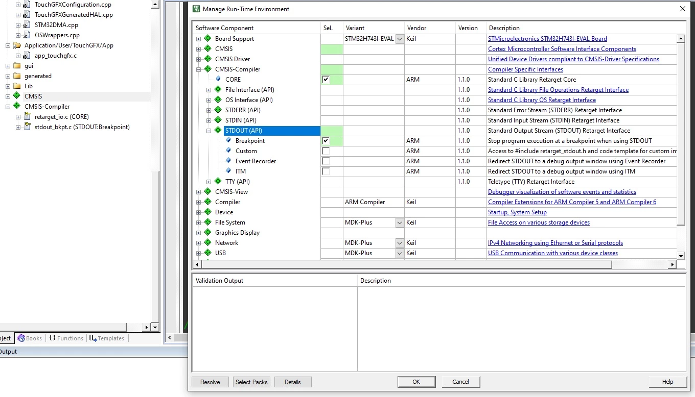

hi
when i use Keil V5.39 and generate project by STM32CubeMX, program run whitout any problem but when i do same work by Keil V5.40 or V5.41 program dont run
when i debug in V5.40/5.41 step by step program dont inter main function
STM32CubeMX 6.12.1
TouchGFX 4.24.1
STM32H743ii

Sep 30, 2024 3:04 PM UTC
hi
problem solve by adding "returget.c" file
for more information refer to this link
https://developer.arm.com/documentation/ka002219/1-0/?lang=en
first test all 4 file in 3614.zip. one of them must solve problem
This is my final setup
hi
