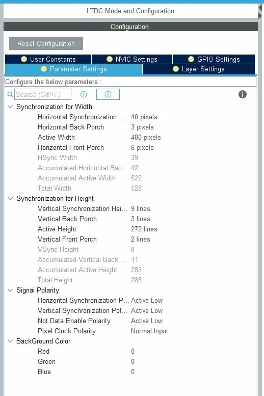

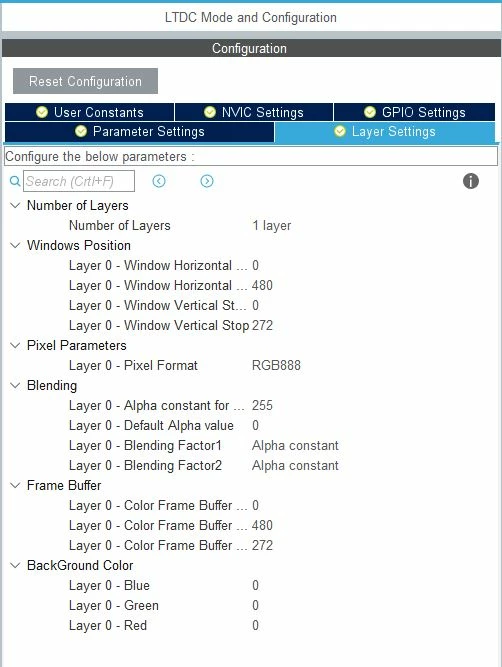

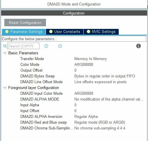

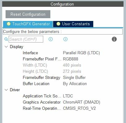

So from cubemx i choose these options:0693W000002ldu5QAA.jpg0693W000002ldu0QAA.jpg0693W000002ldtbQAA.jpg0693W000002ldsxQAA.jpg
shouldnt these configurations generate a .part file for a screen size of 480x272

Yes, the part file should reflect these settings. Do they? Post it.
No, you don't need to configure things you don't need.

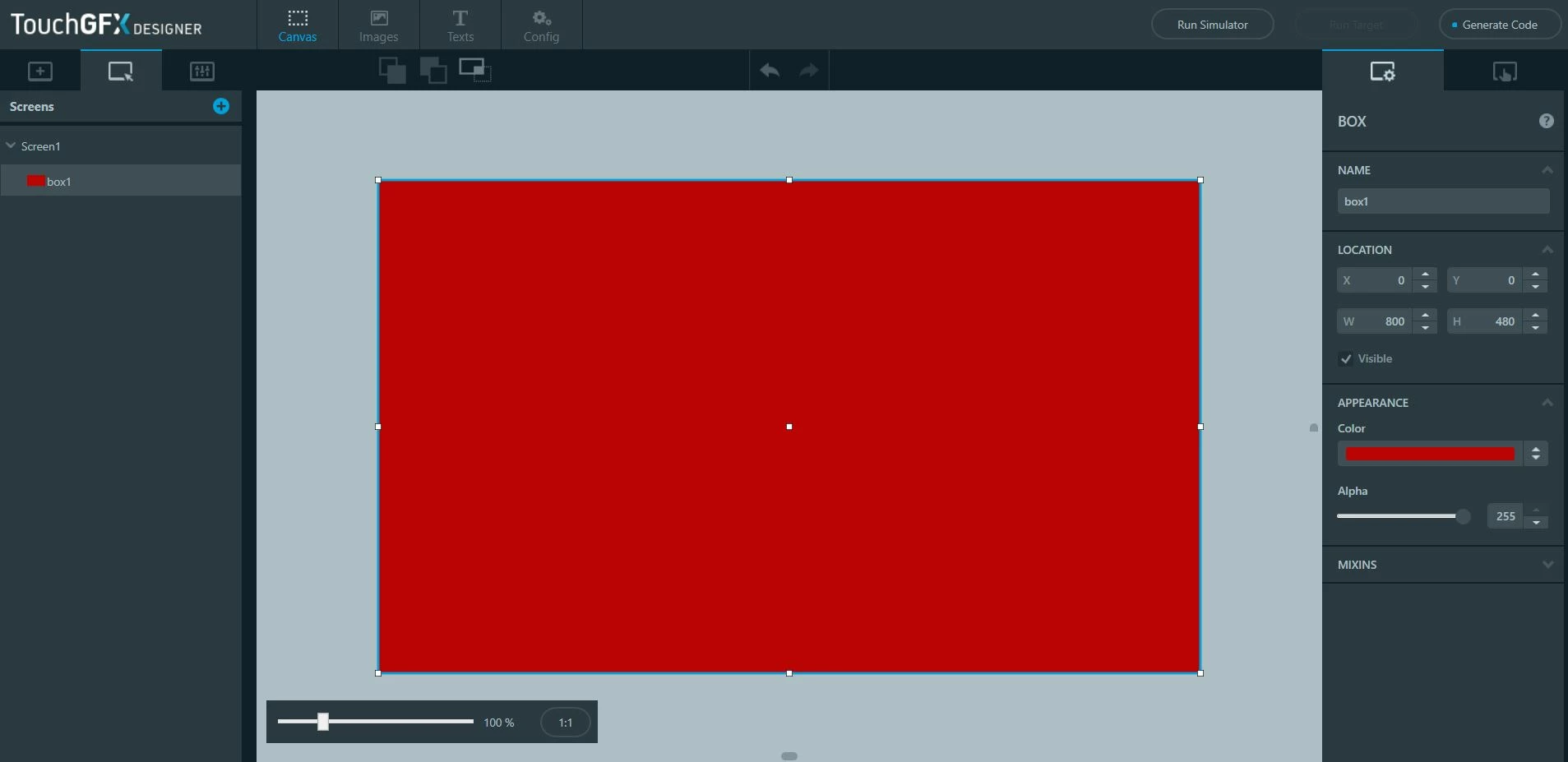

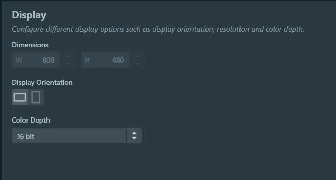

I can not change the Width and Height parameters on the TouchGFX also. And the color depth automatically set to 16 bit.
