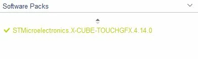

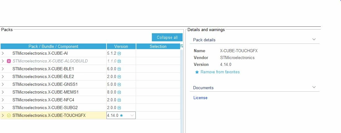

Okay so i found another problem. My CUBEIDE AND CUBEMX was working on version 4.14 and updated itself from 4.13 automatically but the TouchGFX designer app remain in v4.13 0693W000002lej3QAA.jpg0693W000002leitQAA.jpg Should i delete the app and download the latest version again?
