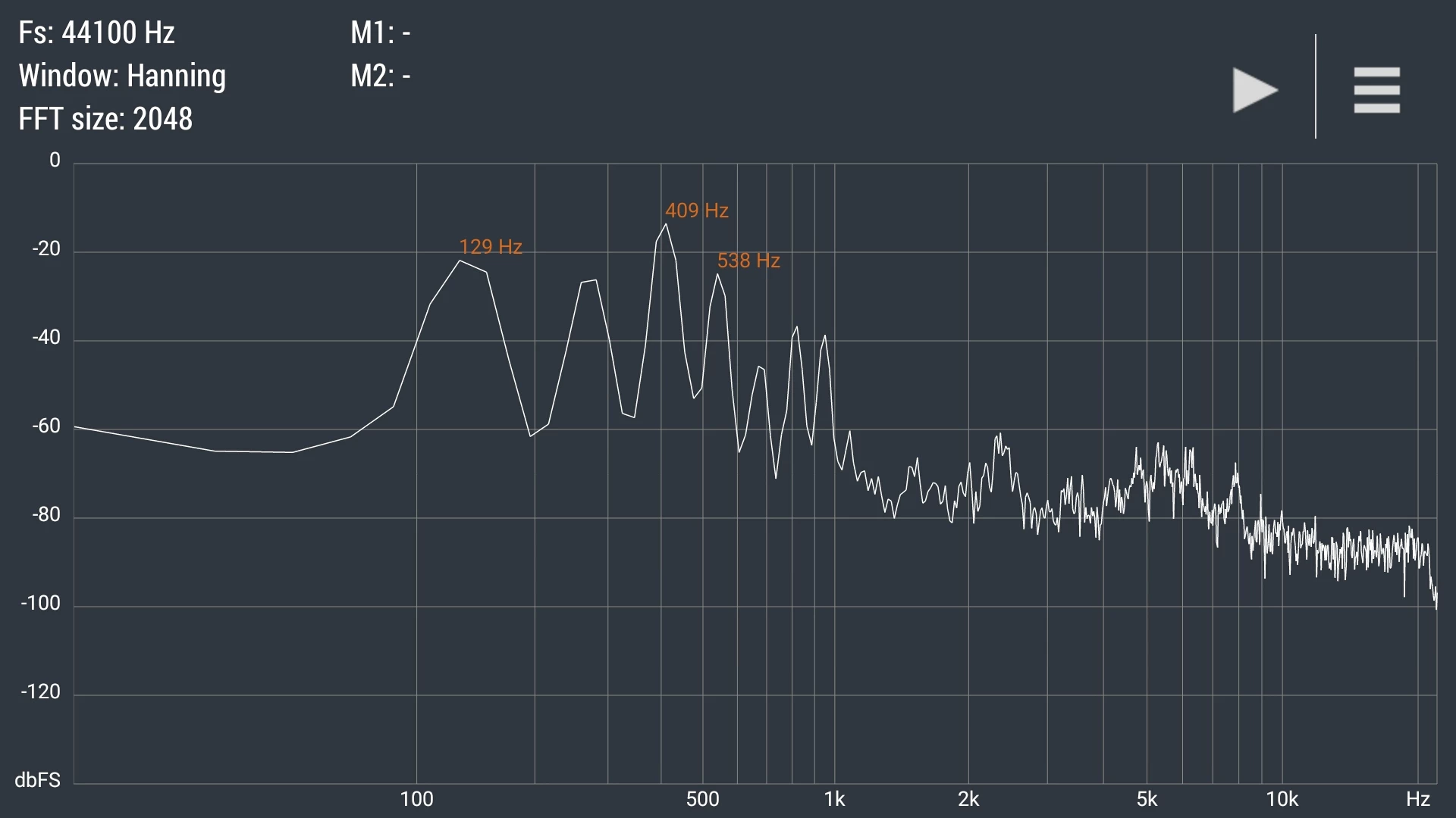

What I'm referring here is just a simple display of a waveform on a TFT or similar LCD display of size say 720x480 pixels that of any smart phone or even smaller sizes (similar to that you find STM32F746 Discovery Kit's LCD)
For example, we might want to display the live spectrum of an audio signal using an FFT and plot the Frequency Vs Magnitude using TouchGFX's canvas. This has to be live meaning continuously update the display waveform without any flickers or tearing, may be using double frame buffer scheme.
(see the attached snapshot of a similar live waveform display captured on a smartphone)
Since many STM32F4 & F7 devices have TFT LCD controllers as well as ChromeART 2D DMA capabilities, I'm sure it should be quite easy to implement these functionalities like how a Graphics Processor does.
I don't see any sample project implementing some thing like this using double frame buffering scheme in a STM32F4/F7 discovery kit (with reference to example projects by TouchGFX).
Would be great to have such a sample application using these schemes in TouchGFX say for a STM32F746 Discovery kit.
