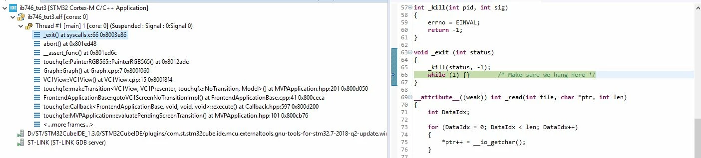

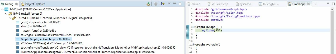

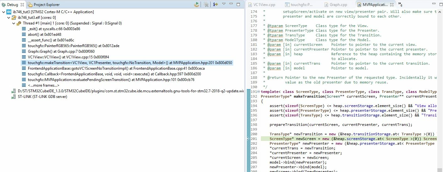

IB.1
April 14, 2020
Hi @Martin KJELDSEN​
Thank you for reply.
Very good point on modifying "generated" files, at this point I just want to get it running.
here the screen shot from debugger when application ""crashed"
Tracing it back:
While was typing I was thinking should I place any canvases or any other "UI elements" on screen while generating tuch GFX project?
Anything else I can provide you with? Please advise...
Thank you for all the support
Regards,
IB

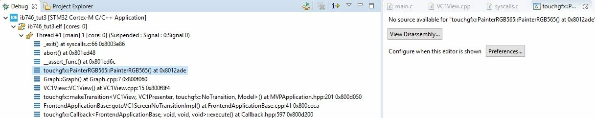

Dejan Nedeljkovic
April 15, 2020
Hi
Did you adapt the painter to your system?
I had a similar behaviour and then I changed from PainterRGB565 to PainterRGB888 in Graph.hpp.
It depends on your TouchGFX settings which painter class to use.
Regards
Dejan
Martin KJELDSEN
Principal III
April 15, 2020
This is also a very good point. The LCD class will assert if the format is not correct. People tend to copy the Graph from project to project without considering the pixel format.
/Martin

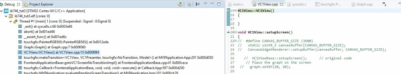

IB.1
April 15, 2020
Hi @Martin KJELDSEN​ @Dejan Nedeljkovic​
This is definitely helps and I can see simple graph on the screen... Thank you for all your help.
Question what I have, how would you recommend to declare frame buffer without modifying "generated" files (TouchGFXConfiguration.cpp)
ie
void touchgfx_init()
 Bitmap::registerBitmapDatabase(BitmapDatabase::getInstance(), BitmapDatabase::getInstanceSize());
 TypedText::registerTexts(&texts);
 Texts::setLanguage(0);
 FontManager::setFontProvider(&fontProvider);
 FrontendHeap& heap = FrontendHeap::getInstance();
 (void)heap; // we need to obtain the reference above to initialize the frontend heap.
 hal.initialize();
#define CANVAS_BUFFER_SIZE (3600)
static uint8_t canvasBuffer[CANVAS_BUFFER_SIZE];
CanvasWidgetRenderer::setupBuffer(canvasBuffer, CANVAS_BUFFER_SIZE);
Thank you very much for all your help and support.
Regards,
IB
Dejan Nedeljkovic
April 15, 2020
You can set the canvas buffer size in TouchGFX.
Select the Screen where your graph should be drawn and then you can set the canvas buffer to another value:
IB.1
April 15, 2020
Thank you Gentlemen for all your Help
