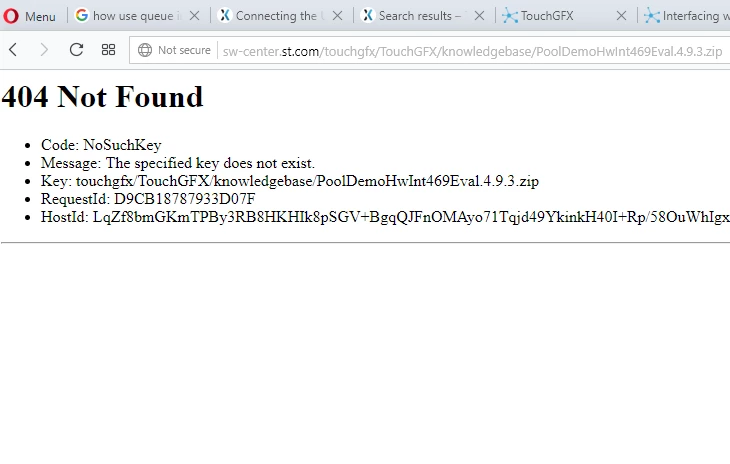

hello
i can't download the sample code (Error 404)..
I'm working on stm32f469ni-discovery
and trying to connect model.cpp to Main.cpp with Queue ..
with help my .. I really like to work on TouchGFX

Hi @smoha​,
We're in the process of migrating files to a different server. I will fix this first thing tomorrow and let you know, allright?

Try now.

still not..(Error 404).... but i found a sample code for STM32F746 and used it for STM32F469 .. and its working ..

Can you please provide the full link that isn't working for you? (in text, not a screenshot)

thank you. its working now

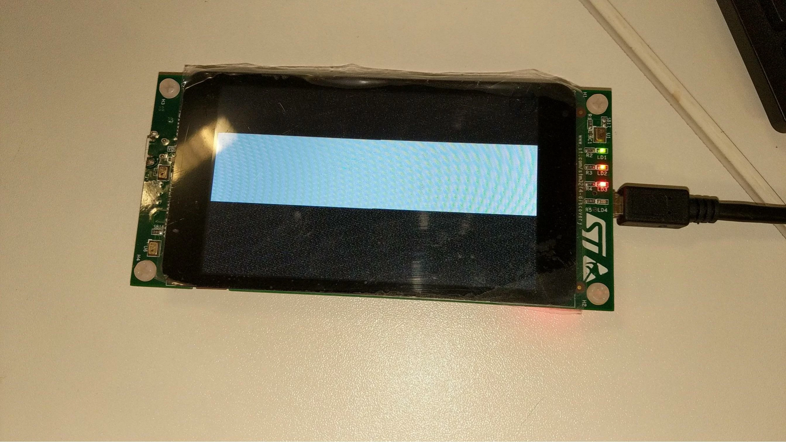

Thanks for the quick reply. I am using STM32469I-DISCO board and trying to replicate the results from the video. Referencing from the project file you pointed out, I was able to resolve most of the errors (I had to make a change in the makefile as well). I think I am almost there, the last piece of code I am stuck at is the following error:
C:\Users\pjain\Desktop\MyApplication1/target/main.cpp:107: undefined reference to `led_task'
collect2.exe: error: ld returned 1 exit status
When I disable the xTaskCreate for led_task in main.cpp, the code is compiled and uploaded to the MCU (without any hw integration). I am not sure why am I getting this error. I have defined void led_task(void* params) in ledtask.h and also included the ledtask.h in main.cpp
PFA my project for your reference. Please let me know if you have any solution/workaround to this error.

The task definition is in a seperate file. Are you sure you're compiling this file? It's in the target/ folder and is called "ledtask.c"
/Martin

Thanks for pointing that I out, I forgot to include ledtask.c in Makefile!
Also, I had to add $(application_path)/target in the include path as well on line 171 of Makefile (I don't know if it's the right thing to do it but without it, ledtask.h is not being recognized in Model.cpp file).
Now, I am able to compile my code :) but the display is not working properly (PFA the image). If I disable the led_task, the display works fine (without hw integration). I even tried disabling the code inside the led_task but the issue is persistent. I don't know if it's something to do with the Makefile. PFA my project for reference.0690X000008iqJ4QAI.jpg
