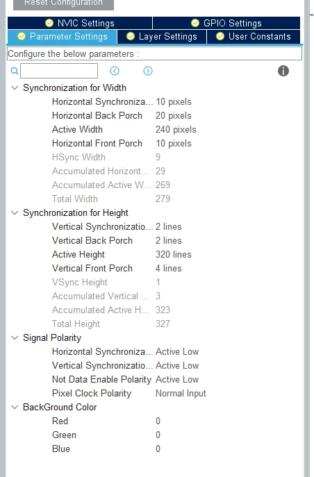

Incorrect Total Width size at LTDC / CubeMX 6.0.0 / FW_H7_V1.8.0
  • August 3, 2020
  • 1 reply
  • 1145 views
This is from CubeMX 6.0.0 / FW_H7_V1.8.0
Total Width is same as Horizontal Front Porch

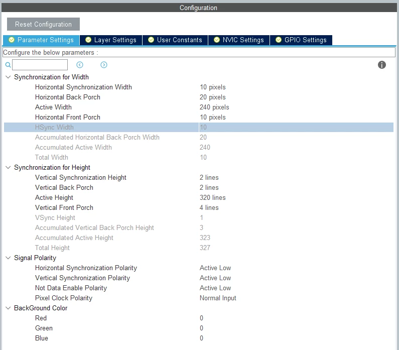

and this is for CubeMX 6.0.0 / FW_F4_V1.25.0 with the same parameters
(everything looks good here)

Hi @Panchev68​ ,
Could you please precise the selected device? You can also share your .ioc so it will be easier to reproduce issue.
I tried with STM32H743VGTx as device and settings are different for LTDC.
-Amel
PS: Please submit your question under STM32 MCUs Q&A space and add relevant tags, otherwise it will have less chance to be reviewed if you submit it under Bug-Report.
