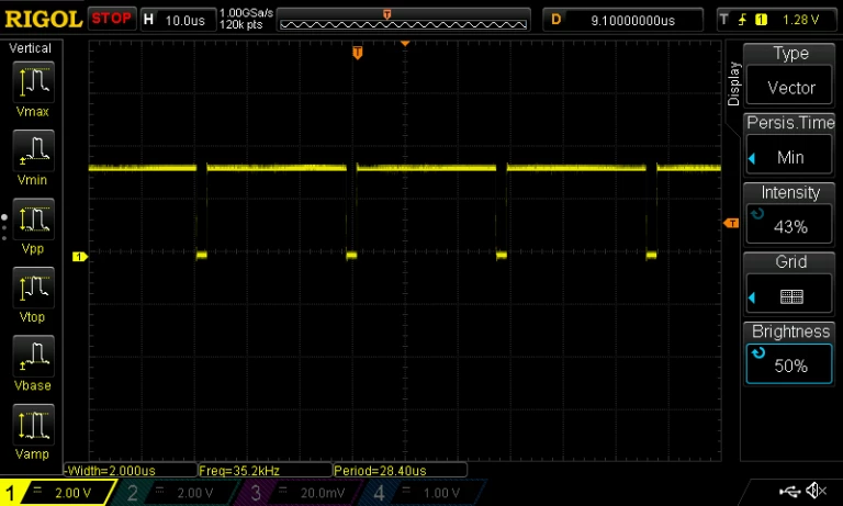

Elektraglide
December 4, 2021
0693W00000HnXDYQA3.pngAll my PWM calculations are based on a 72MHz timer and the scope confirms I get precisely what I expect (2us pulse width), so I believe APB2 is running at full speed.
waclawek.jan
December 4, 2021
We have no idea what do you display on that scope.

This code fragment sets up PB0 to be output of TIM3_CH3 and has TIM3 timer period of 2048 and CH3 as PWM mode.
Since TIM3 is on APB1 I would expect the period of the PB0 output to be 2048/36000000 = 56.8uS
What I measure is 28.4uS (see scope trace). I am clearly misunderstanding something.

[Apologies for answering my own question, but I now think I understand the STM32 behaviour]
Much of the docs refer to APB1 and APB2 and the different clock rates. Specifically, TIM1 & TIM8 being on APB2 (72MHz), other timers being on APB1 (36MHz).
I am sure I am not the only person to read this as being that, say, TIM3 is going to be clocked at the rate set by APB1.
This is not the case.
In the example code above, because the TIM3 CH3 PWM is driving the GPIOB (on APB2), the timing of TIM3 is also at 72MHz.
The same code using TIM1 driving GPIO with PWM, has the same 72MHz timing as TIM3. Now I know! Is that explained anywhere?
