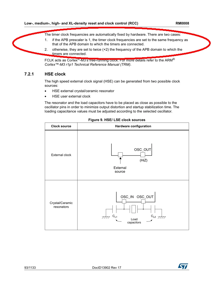

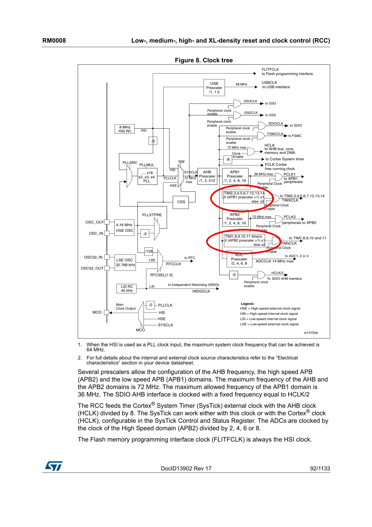

> The same code using TIM1 driving GPIO with PWM, has the same 72MHz timing as TIM3. Now I know! Is that explained anywhere?
Ah, the "timers clocked at twice the APB if APB is divided" gotcha.
Also, see Table 2 in RM0008. Btw, AFAIK this table is only in the 'F1 manuals.
