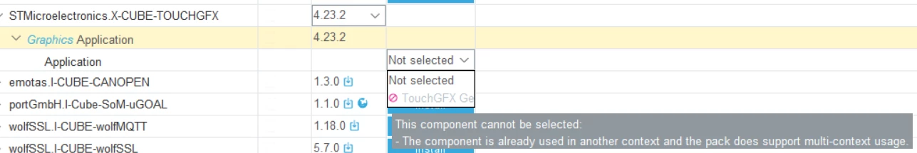

I am working with H747-DISCO (dual core) board and the issue is that I cannot choose the specific core which touchgfx runs on. It works well on M7 core but I need to use other software packs such as cube-ai on M7. So is it possible to manually switch to M4 core?

By the way,  my toolchain is TouchGFX 4.23.2 + CubeMX 6.11.0 + Keil MDK
