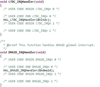

KM L.1
KM L.1Author
August 28, 2020
Martin KJELDSEN
Principal III
August 28, 2020
Are you hitting the LTDC interrupt handlers? What's your application doing? Is it running but nothing displayed? Crashed?
KM L.1
KM L.1Author
August 28, 2020
ya its running but nothing is displayed
