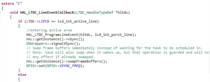

I'm working on BOE varitronix LCD with HX8277B LCD Driver . I need to integrate this with stm32h743 controller and need to display image using touchGFX . I have written initialization code to the LCD and trying to display but nothing is working so what may be the issue?

Show me that you're hitting the TouchGFX LTDC handlers

where exactly i need to hit the LTDC handlers

HAL_LTDC_LineEventCallback
Defined inside Touchgfx/target/generated/TouchGFXGeneratedHAL.cpp of your project (generated file because you chose F7 + LTDC).

we choose H7+LTDC.
