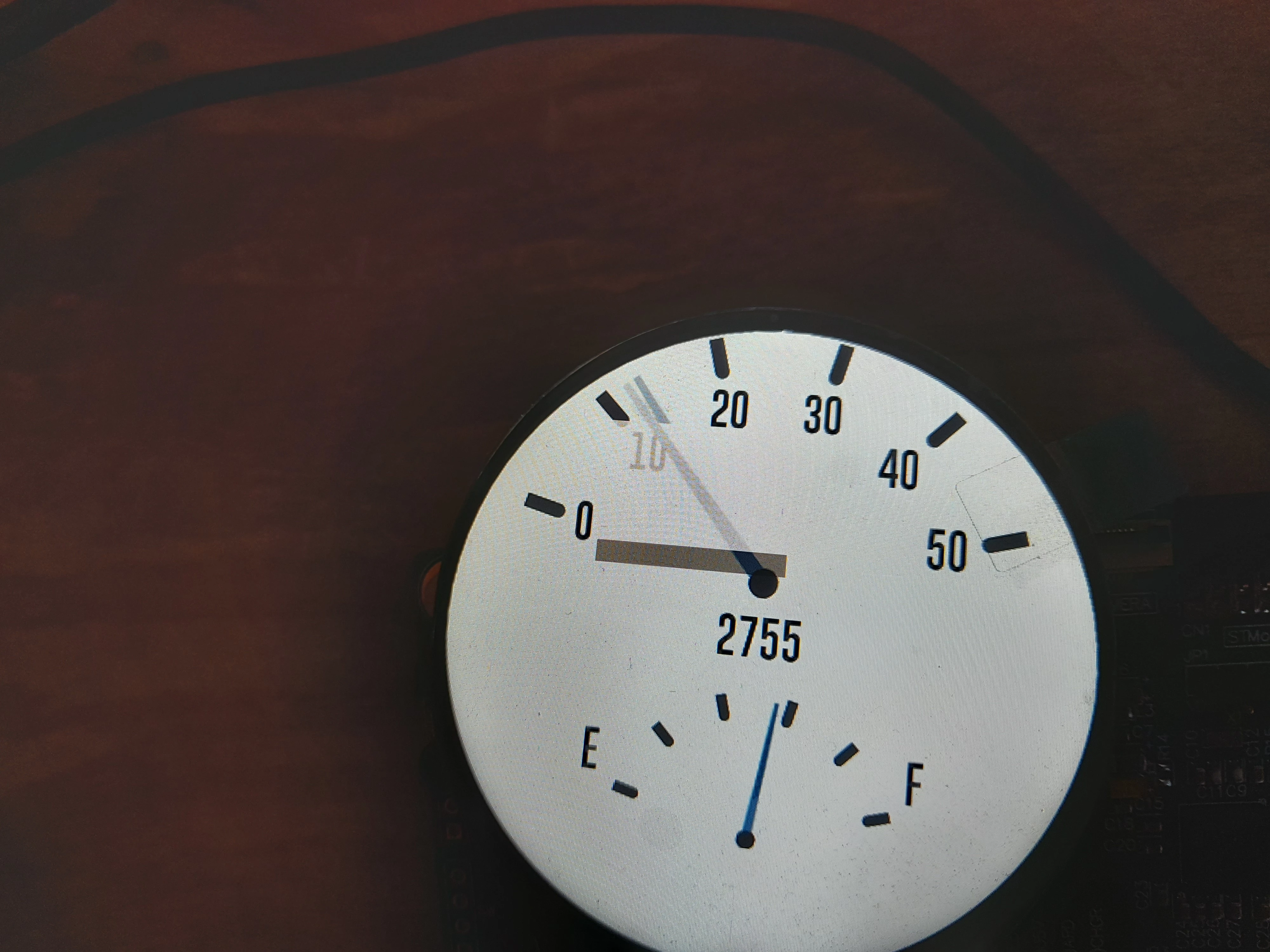

Attached is an example of the flicker - I think the framework has invalidated the speedo needle region and is part way through writing to the framebuffer when the LTDC does the read. Synchronization is provided by the following generated code for DSI video mode:

 I have varied many parameters to try and get rid of the flicker. They do change it, but not remove it completely. I think this is an intrinsic artifact of a single framebuffer in DSI video mode - the LTDC will be reading it at 60 Hz and there's no guarantee that a framework redraw can be done atomically between LTDC frame reads?

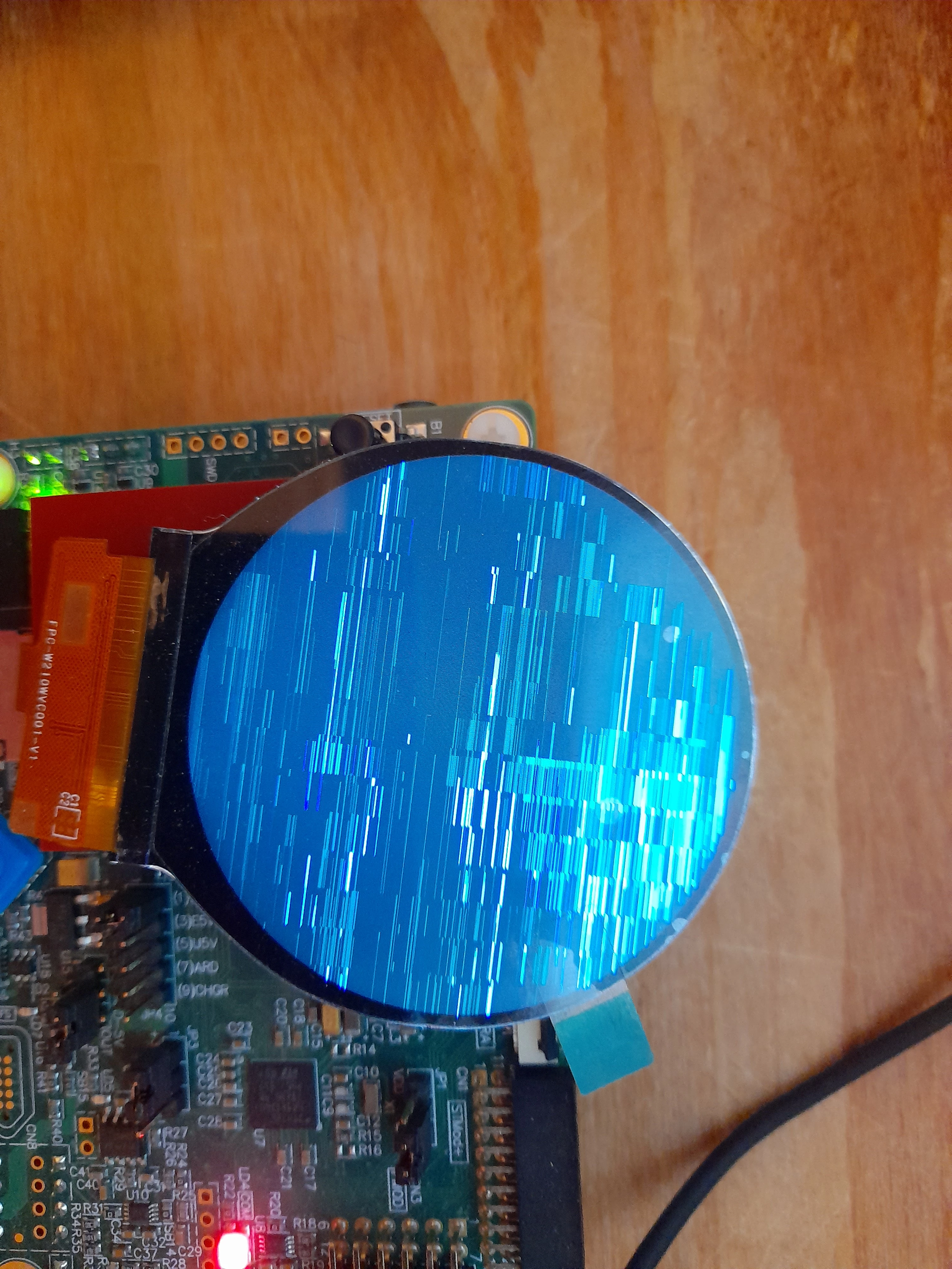

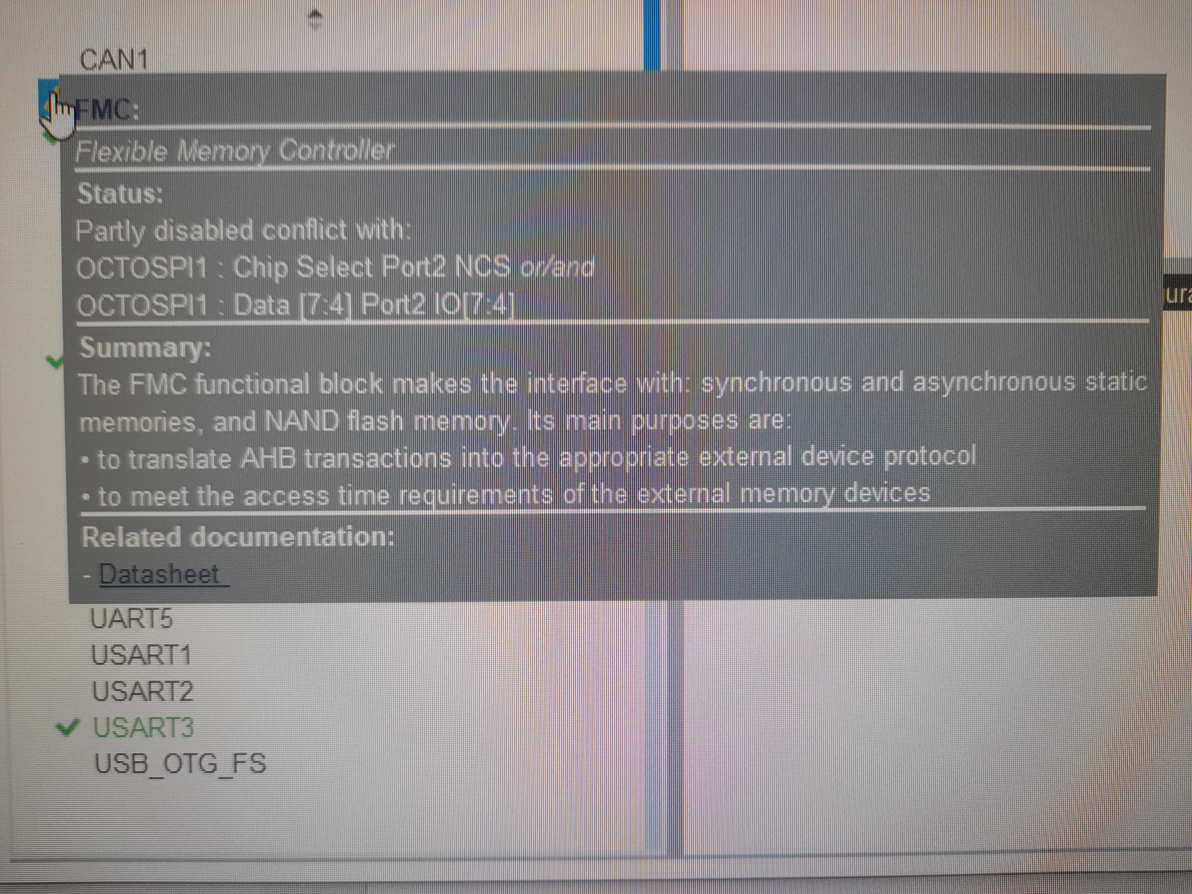

This is the conflict STM32CubeMX reports when I try to enable FMC (for external ram), with OCTOSPI (for external flash) configured per the example code for this board. It suggests that external ram cannot be used if external flash is in use, but that can't be right.
OLync.1

Apr 23, 2022 7:11 AM UTC
This is the generated code when I enable PSRAM via FMC:

And this is the display when I set the GFXMMU to point to the external ram - I'm pretty sure that the image is there, buried in the noise
