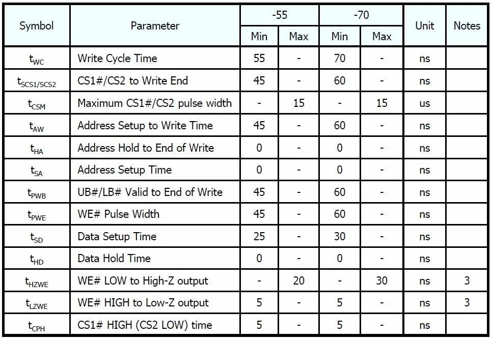

Things have substantially improved - I found settings from a HAL file for the board and the display is almost there. FMC settings:
 hsram1.Init.NSBank = FMC_NORSRAM_BANK1;
 hsram1.Init.DataAddressMux = FMC_DATA_ADDRESS_MUX_DISABLE;
 hsram1.Init.MemoryType = FMC_MEMORY_TYPE_PSRAM;
 hsram1.Init.MemoryDataWidth = FMC_NORSRAM_MEM_BUS_WIDTH_16;
 hsram1.Init.BurstAccessMode = FMC_BURST_ACCESS_MODE_DISABLE;
 hsram1.Init.WaitSignalPolarity = FMC_WAIT_SIGNAL_POLARITY_HIGH;
 hsram1.Init.WaitSignalActive = FMC_WAIT_TIMING_BEFORE_WS;
 hsram1.Init.WriteOperation = FMC_WRITE_OPERATION_ENABLE;
 hsram1.Init.WaitSignal = FMC_WAIT_SIGNAL_DISABLE;
 hsram1.Init.ExtendedMode = FMC_EXTENDED_MODE_DISABLE;
 hsram1.Init.AsynchronousWait = FMC_ASYNCHRONOUS_WAIT_DISABLE;
 hsram1.Init.WriteBurst = FMC_WRITE_BURST_DISABLE;
 hsram1.Init.ContinuousClock = FMC_CONTINUOUS_CLOCK_SYNC_ASYNC;
 hsram1.Init.WriteFifo = FMC_WRITE_FIFO_DISABLE;
 hsram1.Init.NBLSetupTime = 0;
 hsram1.Init.PageSize = FMC_PAGE_SIZE_NONE;
Timings:
 Timing.AddressSetupTime = 1;
 Timing.AddressHoldTime = 0;
 Timing.DataSetupTime = 5;
 Timing.BusTurnAroundDuration = 1;
 Timing.CLKDivision = 2;
 Timing.DataLatency = 2;
 Timing.AccessMode = FMC_ACCESS_MODE_A;
But I don't think they match the device timings (attached). I've experimented with many values and what I have is close to working but not quite there. Can anyone with a better understanding of PSRAM timings advise?

Hi Olync,
I'm not an expert on PSRAM but digging around, there does look to be an example FMC project for your disco on the ST repository.
The example uses the following timing:
 SRAM_Timing.AddressSetupTime = 5;
 SRAM_Timing.AddressHoldTime = 1; /* Min value, Don't care on SRAM Access mode A */
 SRAM_Timing.DataSetupTime = 3;
 SRAM_Timing.BusTurnAroundDuration = 1;
 SRAM_Timing.CLKDivision = 2; /* Min value, Don't care on SRAM Access mode A */
 SRAM_Timing.DataLatency = 2; /* Min value, Don't care on SRAM Access mode A */
The clock is the example is configured at 80MHz or (12.5ns period) so these settings seem reasonable compared to datasheet specifications.
