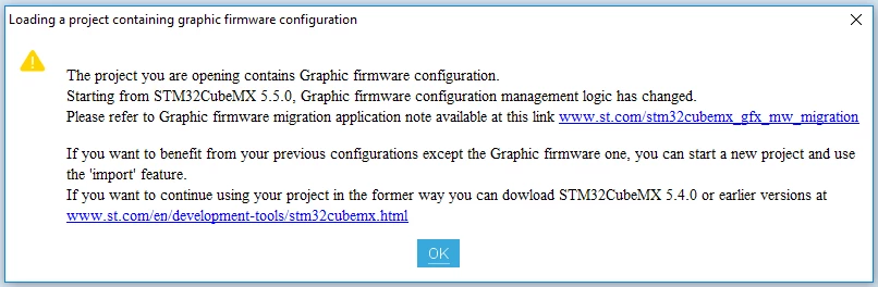

How do I migrate STM32 project based on CubeMX5.4.0(WithTouchGFX 4.12.3, on custom hardware) to CubeMX5.5.0 (TouchGFX 4.13.0)
When I tried to open my existing project for the first time in CubeMX 5.5.0, it gives me a pop up window (See attached)
But I can't click the link that is refered in the window "Stm32cubemx_gfx_mw_migration) note.

Since the document is restricted internally, i've adapted it to suit this community software:
Please note that this is only in the event that you have a CubeMX 5.4.0 project (which has the TouchGFX middleware component) and you wish to updgrade to CubeMX 5.5.0 (Which does not have this component). I think migrating from 5.4 to 5.5 with no TouchGFX MIddleware would work fine.

Migrating a Graphics Middleware projects from CubeMX 5.4.0 to CubeMX 5.5.0
As of CubeMX version 5.5.0 “Graphics Framework�? options are unavailable from the Middleware section of CubeMX. This document describes how to migrate CubeMX 5.4.0 projects that use the Graphics Middleware (STemWin or TouchGFX) to CubeMX 5.5.0 which, in the case of TouchGFX, requires the X-CUBE-TOUCHGFX “TouchGFX Generator�? to be installed and activated separately through “Additional Software�?. STemWin is no longer supported directly through CubeMX.

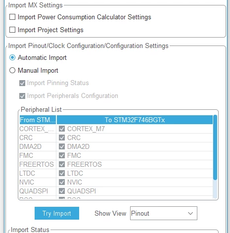

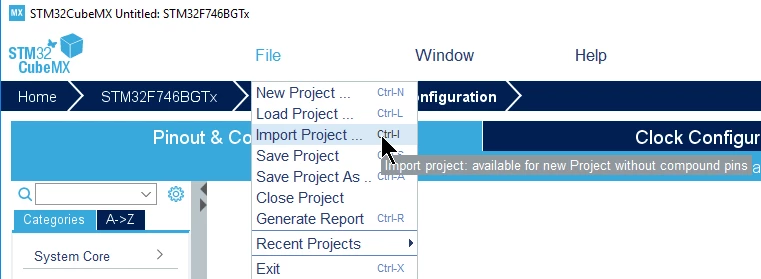

This message instructs you to “import�? the Peripheral Configuration of the 5.4.0 project from a new CubeMX 5.5.0 using the same STM32 Micro Controller as the 5.4.0 project (A warning will be issued otherwise).
Navigate to the 5.4.0 project using the Import function after which a list of available Peripherals is presented. Once the desired peripheral configurations are imported, follow the instructions for either TouchGFX or STemWin in the sections below.

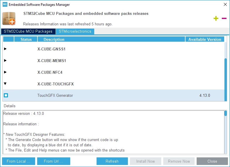

After importing the peripheral configuration install the X-CUBE-TOUCHGFX package from “Help�? -> �?Manage Embedded Software Packages�?, STMicroelectronics tab. See the article on Installing TouchGFX for further details.
