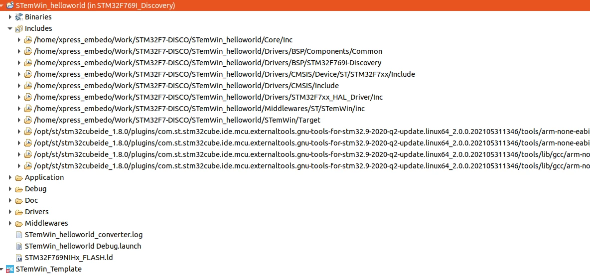

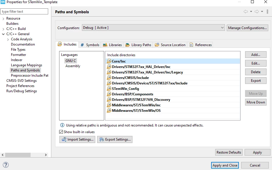

Hello Everyone,
I need help in building the project as I am facing some issues.
As we know we can't configure the STemWin from CubeMX/STM32CubeIDE and to use the STemWin library we have to add it separately in our project.
I created a simple project using CubeMX/STM32CubeIDE which is auto-generated and then I took the reference from the example STemWin_HelloWorld present in the CubeF7 package.
I think I did most of the steps, by comparing these two projects, but I am getting the error.
../STemWin_Config/GUIConf.c:54:10: fatal error: GUI.h: No such file or directory
 54 | #include "GUI.h"
compilation terminated.
But in my project this file is present and added to the project, even the path is also updated in the project settings, I don't know why I am getting this error, that this file is not present.
One strange thing which I have noticed is as shown below, here in include section I can see most of the include paths related to STemWin are disabled/greyed out, I don't know what is the reason.
0693W00000Hqo0NQAR.pngWhile the example project which is working fine, this is not greyed out/disabled.
0693W00000Hqo1BQAR.pngMaybe the issue is related to this.
I am using STM32F769I Discovery Board, and STM32CubeIDE 1.8.0.
I have attached the complete project ziped with this post, please help me in resolving this.
I think the issue might be very simple which I missed due to lack of knowledge.
Thanks in advance.
xpress_embedo
xpress_embedoBest answer
Jan 7, 2022 9:33 AM UTC

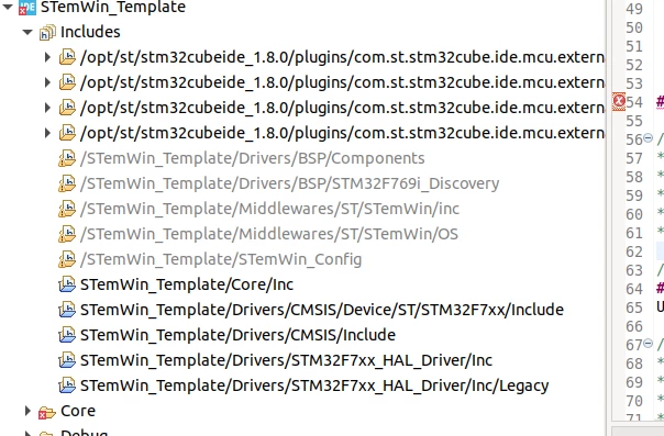

Okay, I was able to solve this problem (I am still getting some other build errors, but not related to this, which I will fix in sometime).
I observed properly and found that when I added path they are added as "/STemWin_Template/...." but if we see other include paths which are not greyed out, it's without the project name, so I just removed "/STemWin_Template" and I am not getting this error again.
So I updated as below.
0693W00000HqqoeQAB.pngNow I have few other issues which I will try to resolve. Thanks
PS: The screenshot attached on the original post are from Ubuntu machine and this screenshot is from Windows, but the project is same.

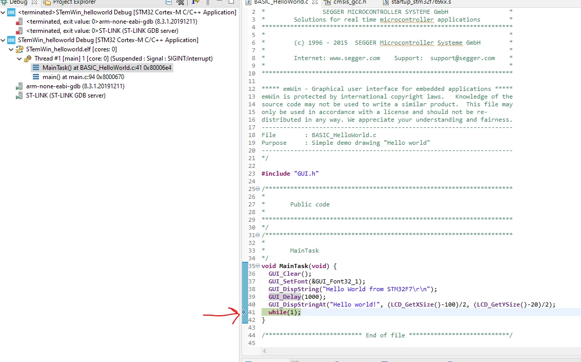

So the good thing is my project is up and running, but I have one issue which when I checked on original project directly opened from CubeF7 example.
The issue is as below, if I single step while debugging my project, nothing gets displayed on the display. But if I press F8 (run) then it works fine.
void MainTask(void) {
 GUI_Clear();
 GUI_SetFont(&GUI_Font32_1);
 GUI_DispString("Hello World from STM32F7\r\n");
 GUI_DispStringAt("Hello world!", (LCD_GetXSize()-100)/2, (LCD_GetYSize()-20)/2);
 while(1);
Another issue is that, if I put a delay like HAL_Delay(1000) or even GUI_Delay(1000), and now even I press F8 (run), then nothing gets displayed after that delay, while control reaches while(1), example is given below

  • When I used single step debugging I can't see anything on the display, but if I pressed F8, I can see the text on the display.
 GUI_Clear();
 while(1);

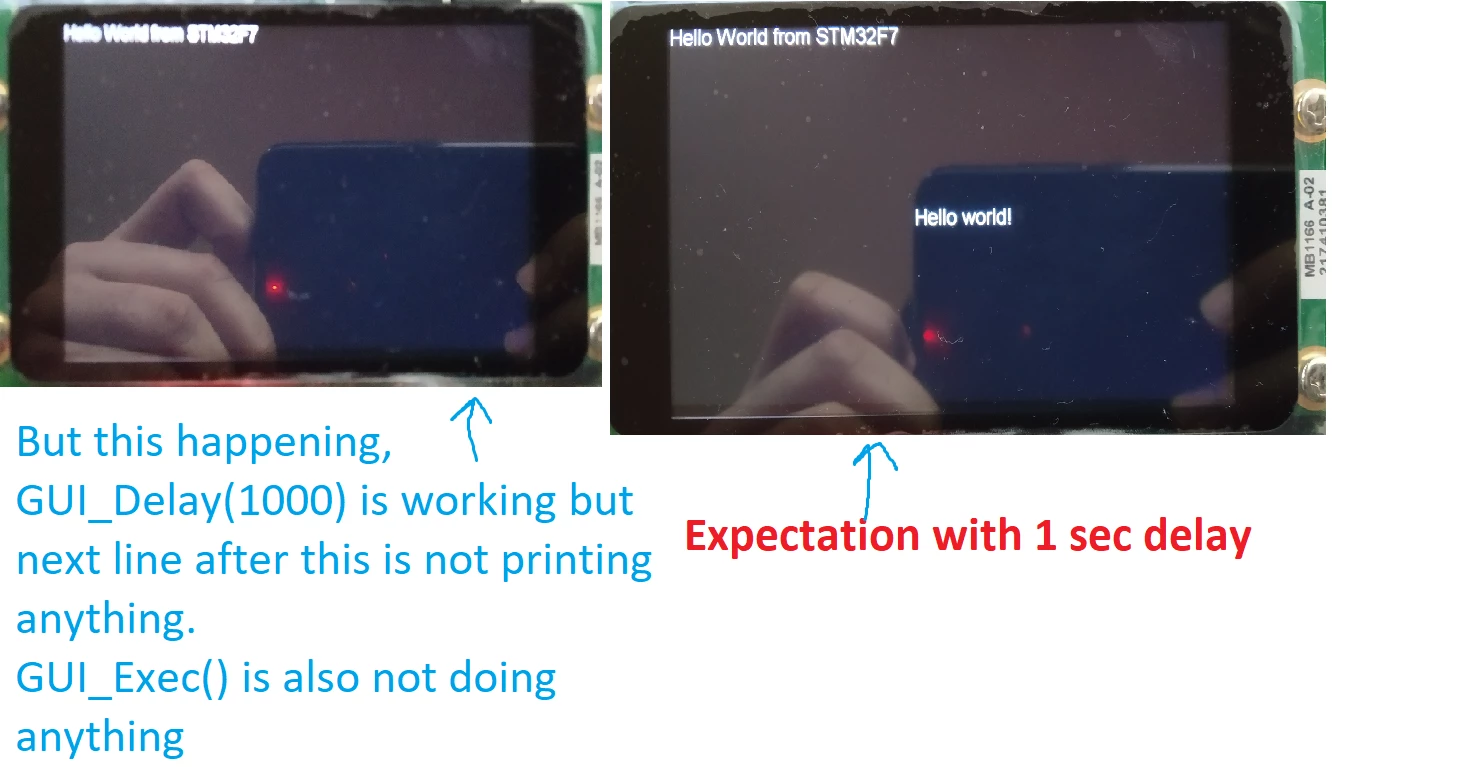

  • When GUI_Delay is used, there is delay but nothing after the GUI_Delay Works. So Let's say, I used the below program and started debugging, and then pressed F8 to run the program freely.
 GUI_Clear();
 GUI_Delay(1000);
 while(1);
I can see "Hello World from STM32F7" but not the "Hello World" on the middle of the screen. I have attached the picture also.

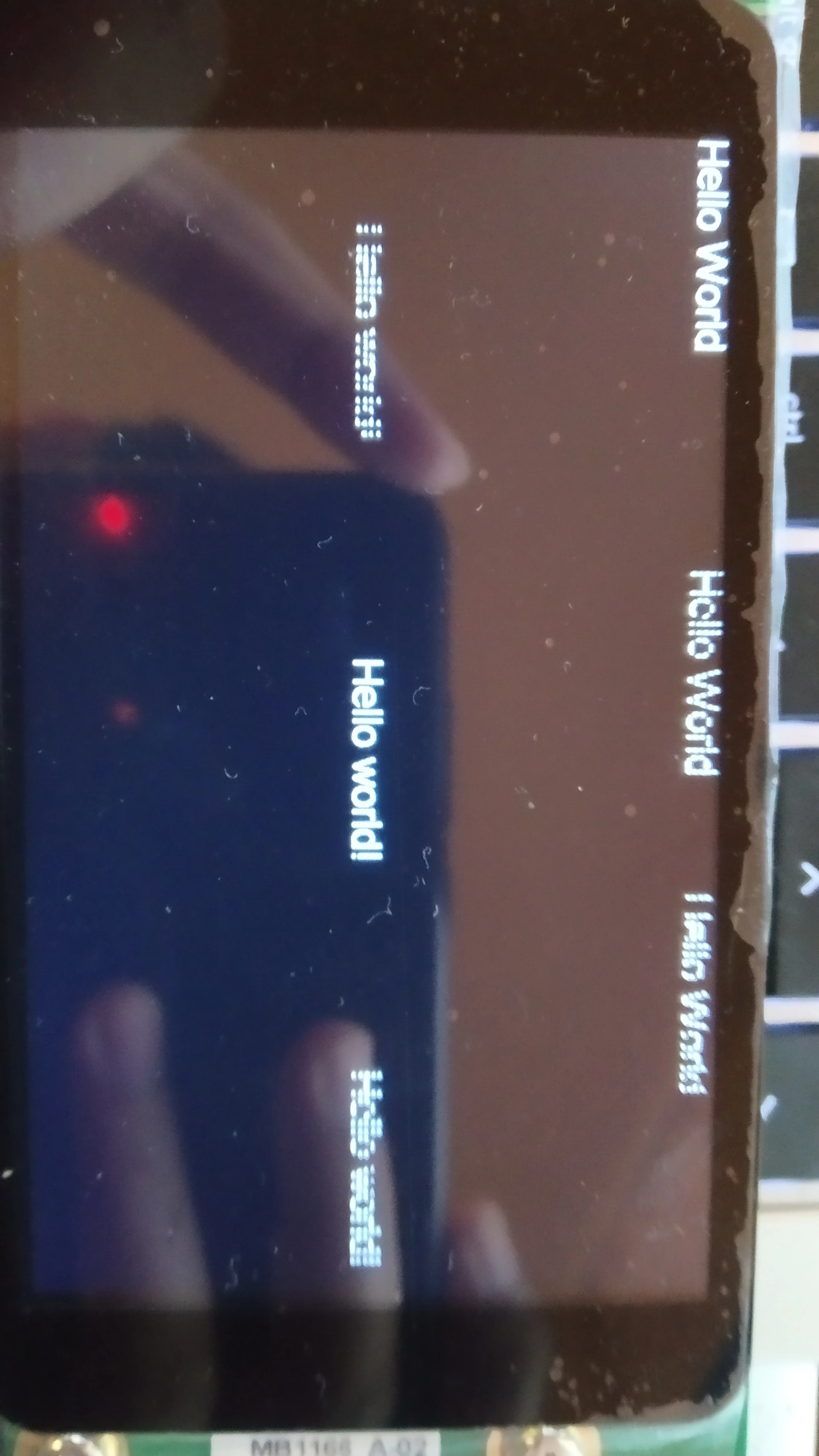

0693W00000HqtA8QAJ.pngRight Side image is when I didn't used GUI_Delay and didn't use single step debugging.
Left side image is when I used GUI_Delay, GUI_Delay is doing it work can be seen from the below screenshot, my control is reaching the while(1), so it means GUI_Delay is not blocking the GUI_DispString function call.
Also regarding the points you mentioned that GUI_Init must be called and CRC should be enabled is already done. And since this is the example from CubeF7 package, I just modified it to include Delay and another Display String line.
Do you have some suggestions here now?

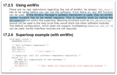

Did you try the Windows Manager?
“GUI_Delay�? API calls internally “GUI_Exec�?. The call of “GUI_Exec�? regularly is recommended to update the modified windows.
“GUI_Exec�? API send notifications to STemWin callbacks and update all invalidated windows.
I would say I tried but not whole heartedly, and when I tried it also doesn't work properly, maybe I can spent some more time on this but I am curious why a simple program with delay is not working. Earlier I was using the emWin windows simulator and I don't have any problem in the simulator window, GUI_Delay was working fine there, which means that this is supported by library and should also work on STM32F769I-DISCO board. Anyways I know that you guys will find the solution for me, many thanks for that.
Thanks for detailed explanation, my understanding was that GUI_Delay uses GUI_X_Delay and GUI_Exec functions internally. And I will share one scenario with you.

They checked on STM32F769-EVAL board and the demo works fine.
So, I opened the STM32F769I-EVAL STemWin_helloworld example, and without analyzing took the risk to compile and program on my board.
And guess what happen I can see two times string with some 1 second delay, which I programmed.
The below is the program I used.
 GUI_Clear();
 GUI_DispString("Hello World\r\n");
 GUI_Delay(1000);
 while(1);
The output is not perfect, I can see some strangely printed text ("Hello World"), which I assume for the obvious reasons because they have some different pin-outs (I checked this later by comparing LCD configurations of both projects).
0693W00000HrIKwQAN.jpgI requested them to re-check on the STM32F769I-DISCO board and not on STM32F769I-EVAL board.
