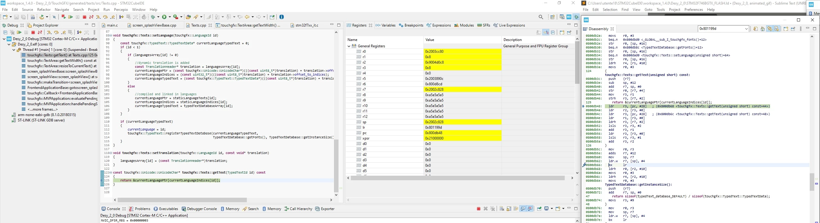

0693W000007Cqv6QAC.jpgHi Tesla,
I did find that returning from the function
touchgfx::Unicode::UnicodeChar* touchgfx::Texts::getText(TypedTextId id)
inside Touchgfx/generated/texts/src/Texts.cpp
jump to an odd flash memory address, I don't know if that can be the cause, but before that call all the disassembly steps goes right into pair address.
after that call an instruction "bx lr" jump to an odd address due to the fact that inside the LR register there is an odd address.
The address range is correct and pointing to the right back function .
At the same time the debugger became instable and is more and more difficult to proceed stepping the code.
If left run, the code goes suddenly into an hardfault.
All the function used are from library and/or auto generated code, so it's very strange.
All the text pointer into the external memory seems corrects. I can see the offsett of every string I'm using.
I think to a wrong aligned code but how it can be verifyed ? since the code is precompiled?
thanks.

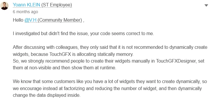

Are allocating GFX widget on a Heap in e.g. in GFX::View constructor or GFX::View::setupScreen () and adding pointer to eg Container::add () ?
I am asking because I saw in few places that this is not recommended to do eg comment by @Yoann KLEIN​  here:
0693W00000aJ2jyQAC.pngI am not sure wherher to go new/delete path as implementation of GFX could change and cause application crash later in the project.
I work in Qt/emWin. Not being able to new/delete widgets is quite a change in a design paradigm/way of thinking - this is not a complaint, just a statement.
Thanks

class FastEditScreenView: public FastEditScreenViewBase {
 private:
 touchgfx::MoveAnimator<touchgfx::TextAreaWithOneWildcard>
 letter_boxes[LETTER_COUNT];
 touchgfx::Unicode::UnicodeChar letter_buffers[LETTER_COUNT][LETTER_BUF_SIZE];
void FastEditScreenView::setupScreen() {
	FastEditScreenViewBase::setupScreen();
	int16_t temp_width, temp_height;
	temp_width = 20;
	temp_height = 20;
	for (uint8_t i = 0; i < LETTER_COUNT; i++) {
		letter_boxes[i].setXY(18 + i * 14, 88 + 3 * i);
		letter_boxes[i].setHeight(temp_height); // before setTypedText !
		letter_boxes[i].setWidth(temp_width);
		letter_boxes[i].setColor(touchgfx::Color::getColorFromRGB(255, 255, 255));
		letter_boxes[i].setLinespacing(0);
		Unicode::snprintf(letter_buffers[i], 2, "%s", "W"); // before setTypedText !
		letter_boxes[i].setWildcard(letter_buffers[i]);
 letter_boxes[i].setTypedText(touchgfx::TypedText( T_RESOURCELETTERWC));
		letter_boxes[i].resizeToCurrentText();
		add(letter_boxes[i]);
		letter_boxes[i].invalidate();
It is really more comfortable to create controls in Designer and hide/show them as needed. But if you really-really eager such strange things, you can look in your ...ViewBase.cpp file and do more or less the same - new controls should be fields of your view. See also this discussion: https://community.st.com/s/question/0D53W00000ttGs7SAE/creating-textarea-programmatically-with-wildcard-and-buffer
