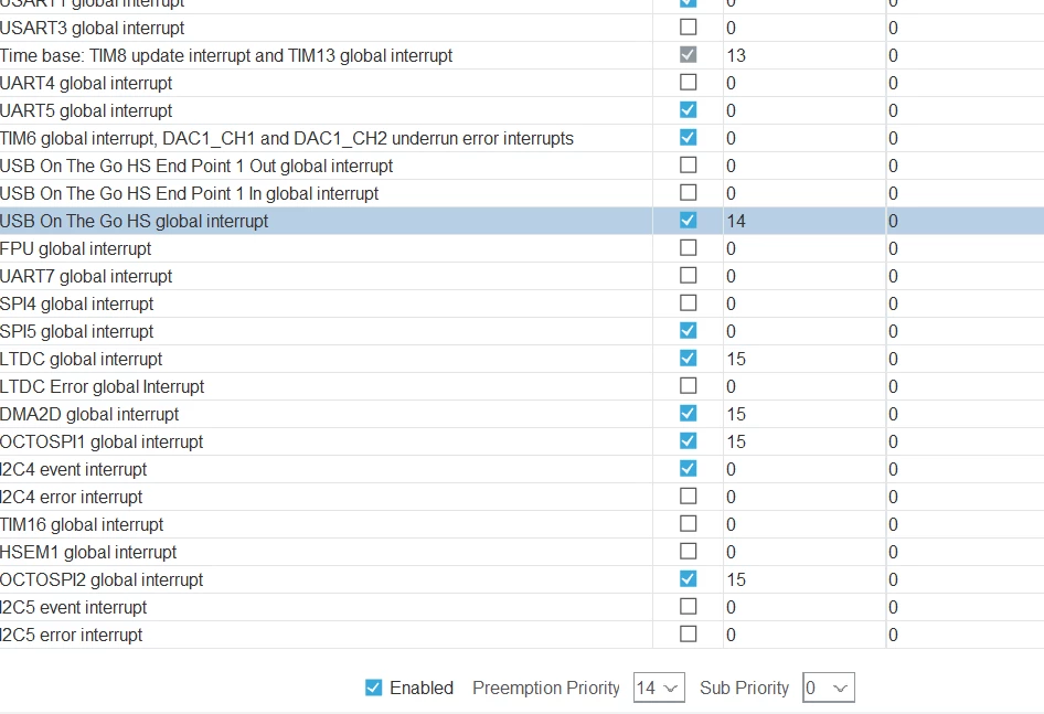

The solution has been the priority of the interrupts. Configuring them as follows:
I would like to know if this saturation is normal or if I am configuring something wrong?

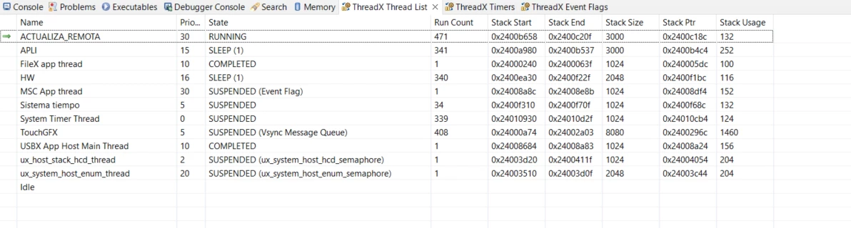

when the timeout occurs, this is the status of the tasks

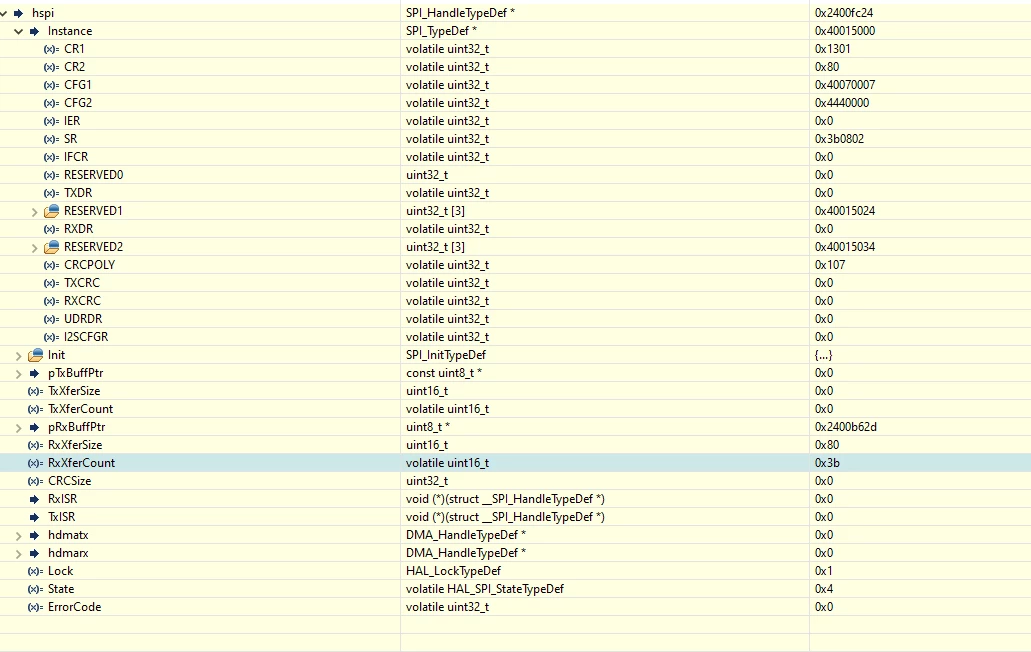

  • In the most recent code you posted, how big is "buffer_spi"?
  • Are you SURE the error you are getting is HAL_TIMEOUT?  Your code above just checks for not HAL_OK.
  • I don't know about the H7 HAL code, but in the F4/F7 HAL_SPI_Receive() there are only 2 lines that can generate a HAL_TIMEOUT error: one for 8-bit data and one for everything else.  Set breakpoints on those 2 lines and see what the SPIHandle member variables look like.  Has it received ANY data?  If so, how much?
  • You say "continually skips timeout, even if I put more time on it" - are you saying that even if you change the timeout from 1000 to, say, 10000 (10 seconds), you still get the timeout error (and you have verified it is timeout and not some other error)?
[EDIT] Maybe possibly could be a memory corruption issue, but look at the previous items before chasing this.
uint8_t buffer_spi[128];
I'm sure it's HAL_TIMEOUT, I set breakpoint when it's different from HAL_OK.

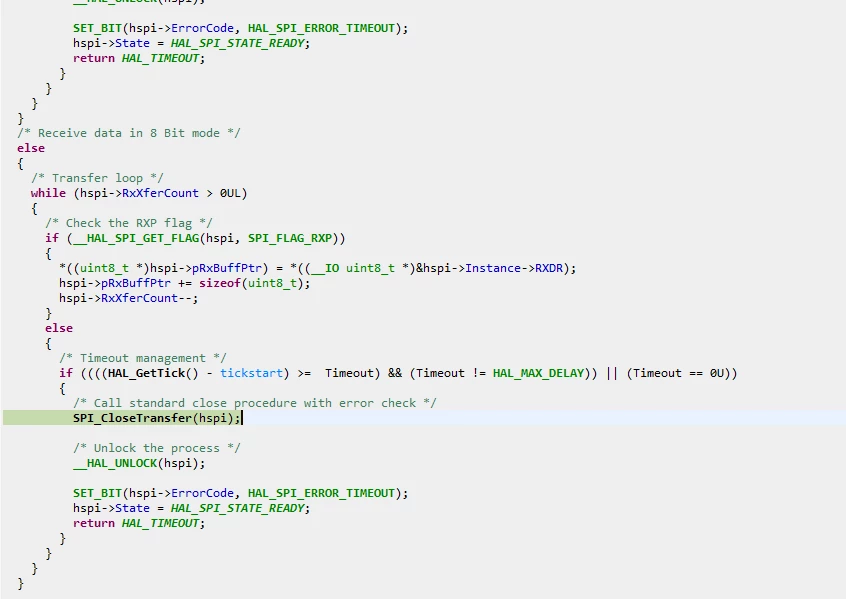

It can be seen that it has received some data.
yes, it always skips timeout.

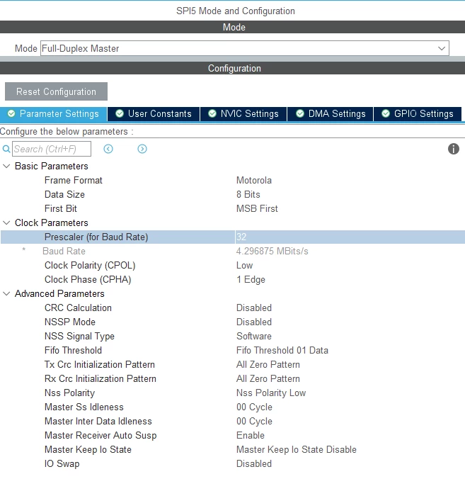

SPI configuration

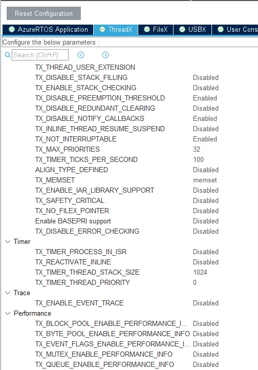

threadX configuration

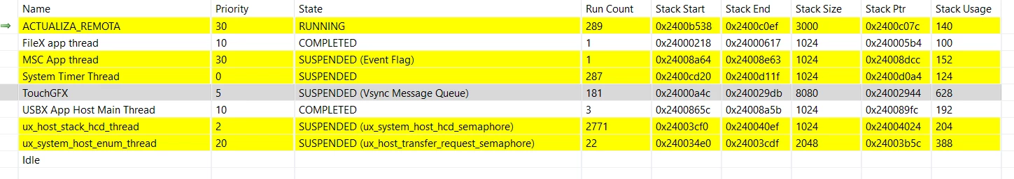

I have executed a basic project. Containing: Threadx,USBx,FILEx,touchgfx.
I'm just generating a task. And the problem continues.
I have tried. with interruption, and in this semaphore waiting for the interruption, it returns TX_NO_INSTANCE. only on some occasions.
