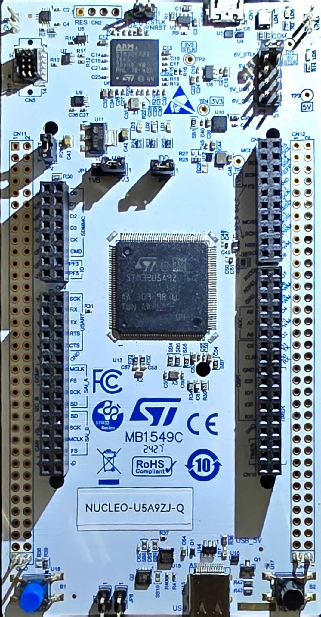

To play with Riverdi displays connected to the FMC and with the GPU2D on a Nucleo-board I use this one:
NUCLEO-U5A9ZJ-Q:
