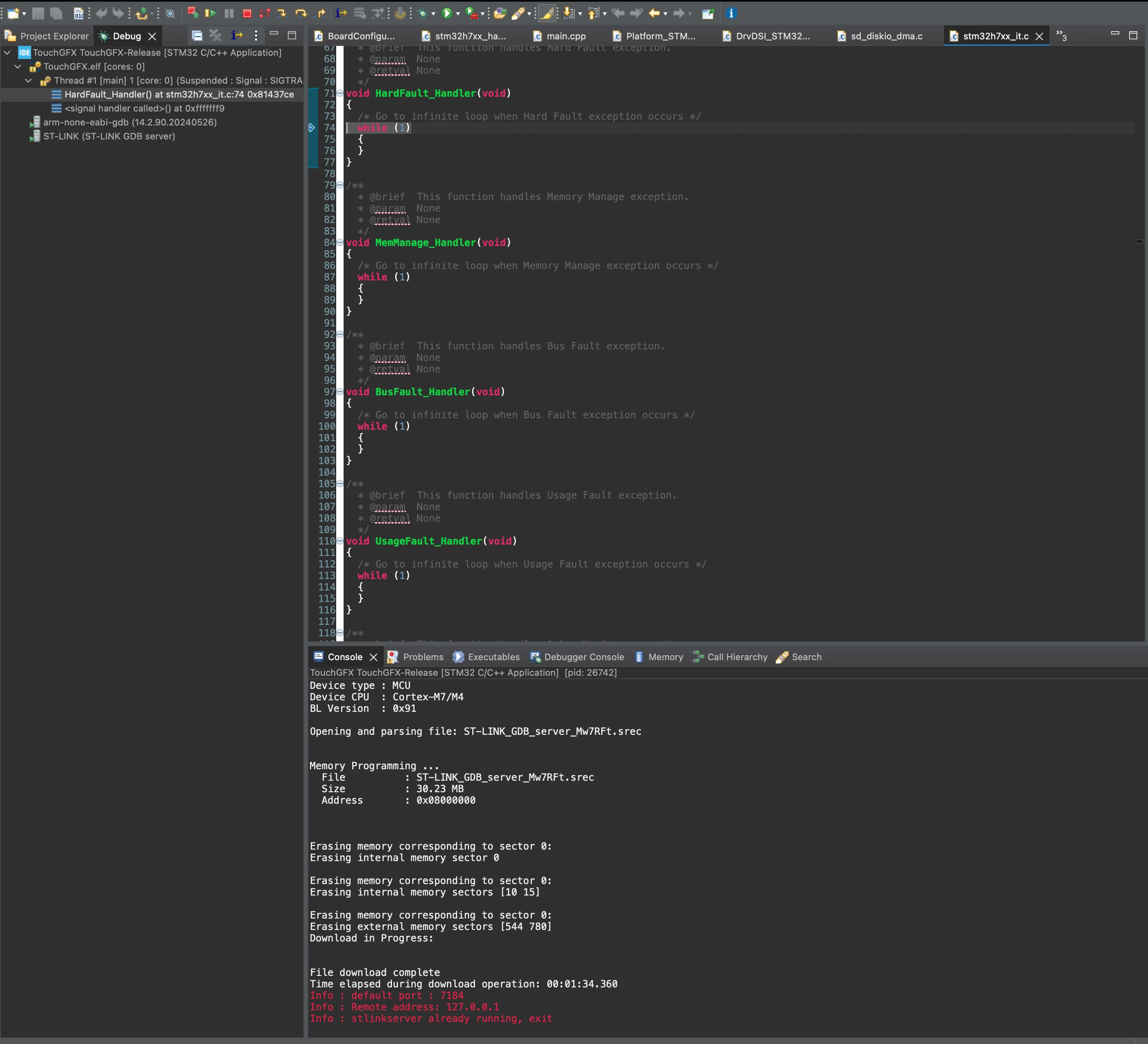

I however get a Hard Fault, sitting in HardFault_Handler(), as soon as I run. It happens before the code gets to main(). It also does not look like it is matching symbols to files correctly, because it is not showing code. I did check that Load Symbols is checked in debugger settings.

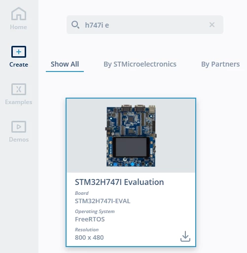

  1. Open TouchGFX Designer.
  2. Go to the "Demos" tab.
  3. Press "Select Board Setup".
  4. Select "STM32H747I Evaluation".
  5. Select "TouchGFX Demo 2" and press "Create".
  6. Press F6 or click the "Program and Run Target" button.

Could you test the TBS for STM32H747I-EVAL available in TouchGFX Designer? I believe this project should also work for STM32H757I-EVAL.

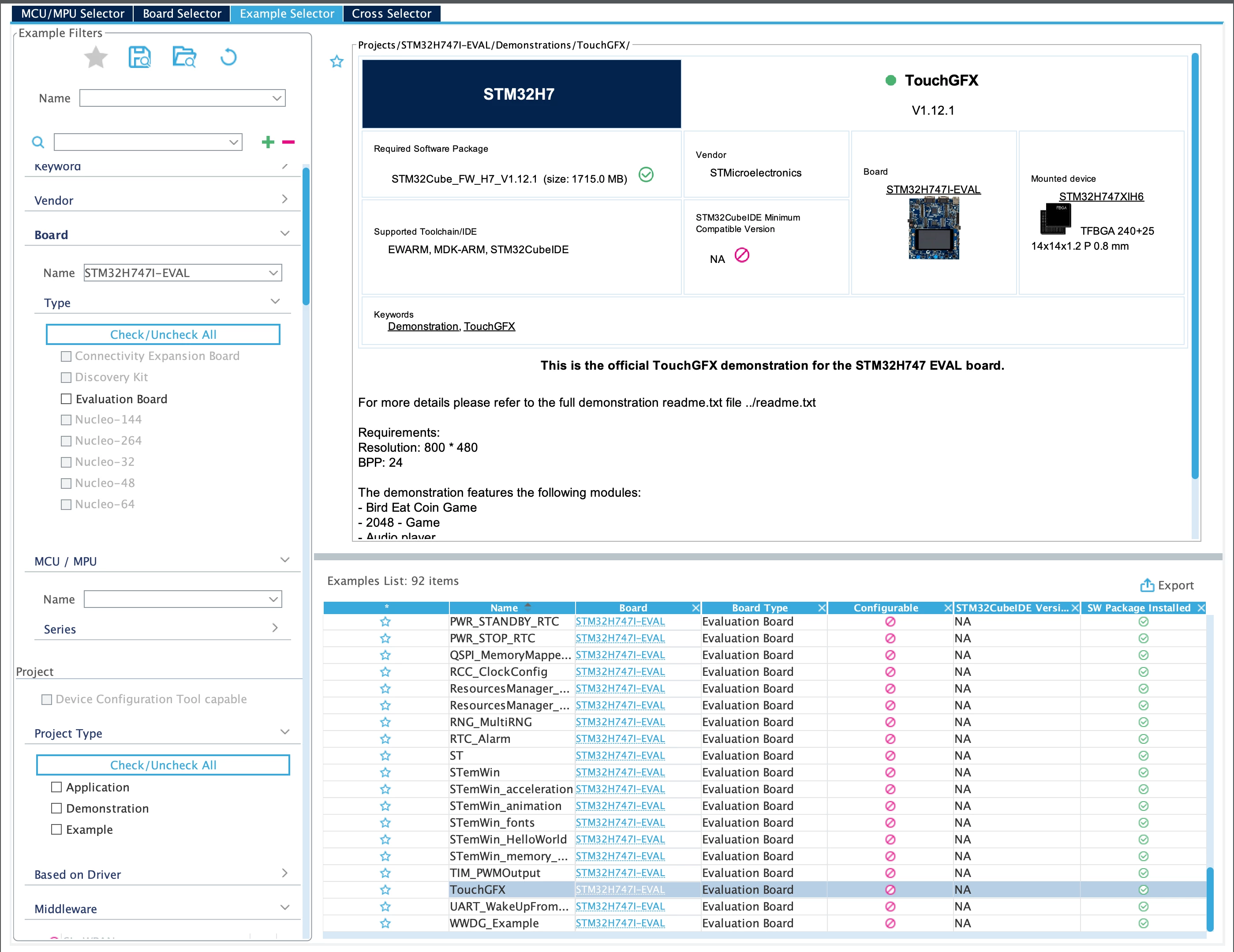

In STMCube32IDE, I followed these steps:
  1. File > New > STM32 Project.
  2. Selected Example Selector tab.
  3. Type STM32H757I-EVAL for Board, and select the TouchGFX example (see image below).
  4. Used all the default settings.
  5. Build the project.
  6. Create new debug connection to debug the TouchGFX Release that was built.
  7. Select MT25TL01G_STM32H747I-EVAL.stldr as external loader.
  8. Debug the application.
Is there something I missed or did wrong?
I've tried going into compiler options and compile with -g and -Og (to enable debugging and disable speed optimisation) but it made no difference. I can at least see the HardFault() after adding debug symbols (-g). Below is a screengrab of where it gets stuck in HardFault, and the call stack does not help me much.
