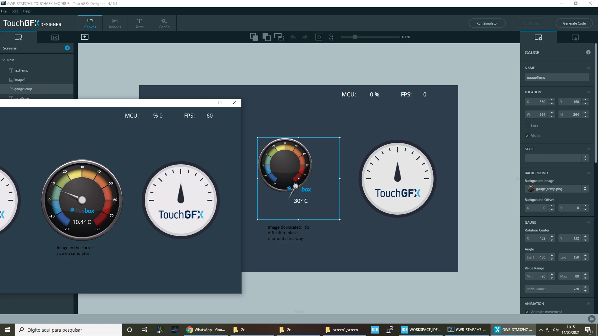

Gauge background and needle downsized on Designer
  • May 14, 2021
  • 1207 views
When I change the gauge background or the needle my custom image gets downsized on the Designer app difficulting the job of aligning and placing things. Is this a known bug?
Best answer by Alexandre RENOUX
Hello Dolence,
Yes this is a known bug. It's probably because your pixel density (dpi) is not 96 dpi. Have a look at this community post : https://community.st.com/s/question/0D53W00000TGqxM/custom-gauge-background-image-not-displaying-correctly-in-touchgfx-designer-416
A fix should be released in the near future but for now changing your image dpi is the best solution.
If changing the dpi works, please close this topic by choosing Select as Best.
/Alexandre

Hello Dolence,
/Alexandre

Hi Alexandre! Yes, it indeed worked with 96 dpi density. I'm closing it. Thanks for your response.
