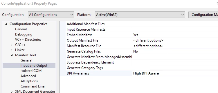

I have a high resolution PC monitor (3840x2160) and have set Windows scaling to 150% to make icons and texts in most applications readable.
Screenshots in TouchGFX simulator with F3 are pixel perfect and match what is rendered on target hardware, but rendering during simulating is done using Windows scaling, so it is not sharp (1 pixel is 1.5 pixels).
I want square pixels. So 1 pixel should be 1, 4, 9 or 16 pixels of the same color for respectively 100%,200%,300% and 400%.
I have a semi-working solution.
In Visual studio 2022 I've disabled the windows scaling like so:
This renders the simulator at native resolution. So the window can be quite small.
In order to do integer scaling I've added SDL_SCALE  and modified SDL hal. I've modified my HALSDL2.cpp file like so:

This seems to work. But I haven't fully tested it and there are some quirks.
I haven't tested if it works with portrait mode for instance.
It doesn't work well with skins. I have a skin with transparency at the outer edges. When I set the scaling to something other than 1 only the skin is rendered. If I write the skin prior to the update of the display instead of after then it does work, but then the transparent edges turn black. This is a different topic about transparent skins: https://community.st.com/t5/stm32-mcus-touchgfx-and-gui/touchgfx-simulator-skin-not-working/td-p/686222
I think it is doable to create a setting in TouchGFX designer to set scaling via a drop down menu to OS scaling(the same as now) or a specific integer scaling.
EDIT: Fixed integer scaling with skins. Added source file of modified HALSDL2.cpp

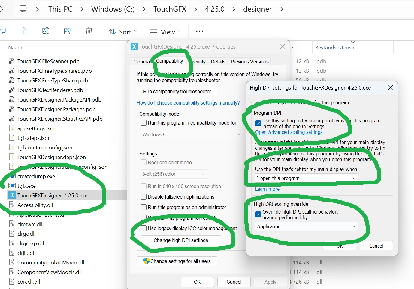

    Additionally I would like scaling for designer to be fixed too. With my previously shared workaround the simulator window works, but the render in the preview in the designer does not, it looks blurry.
    I have a workaround for that too:
    1. Right click the application (in this case C:\TouchGFX\4.25.0\designer\TouchGFXDesigner-4.25.0.exe)
    2. Select Properties->Compatibility->Change high DPI settings->
    3. check "Use this setting to fix scaling problems instead of the one in Settings"
      "Use the DPI that's set for my main display when" = "I open this program"
      check "Override high DPI scaling behavior. Scaling performed by" and set to "Application"
    5. click ok and apply
    6. set Windows system wide scaling to the desired integer scaling for TouchGFX (100%, 200%, 300%, etc.)
    7. open TouchGFX Designer
    8. open a project in TouchGFX Designer
    9. set Windows system wide scaling back to the desired scaling for the system
    Now the application will remember the scaling settings until you restart it.
