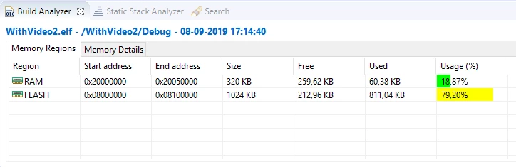

The issue is that all assets (fonts, images etc) are stored in the internal flash of the MCU. this creates quite a memory footprint even with just a few font sizes and backgrounds.
This picture shows the memory usage with just 2 screens with two different font sizes (20pt and 200pt) and a single button. We are already maxed out here!!
Next step is to edit the linker file so it allows storage in the QSPI memory.

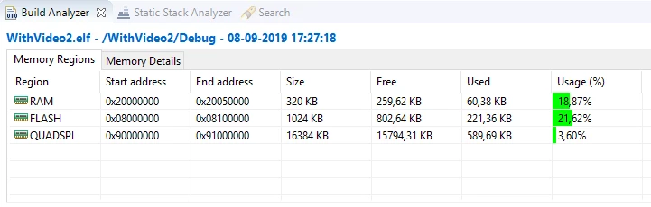

With this change in place we can do another build of the project and the memory footprint now looks like this:
A pretty radical change :) You should be able to fit almost anything into that QSPI footprint.

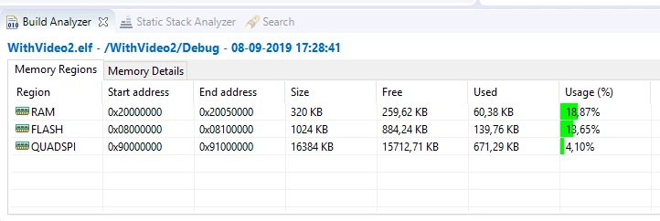

Now the result is this:
0690X00000AQtMxQAL.pngSo this is it. By adding to the linkerfiler you get muuuuuch more space in your application :)
