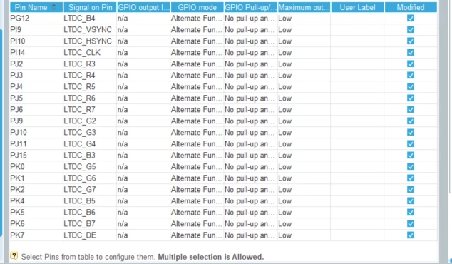

Thanks for Reply. Following the first video mentioned I created a new projet with default pin configuration as showed in video. I have tried with project in first video and it works fine (just two screen with a button each one). I copied MX_QUADSPI_Init code posted here to configure it. When enters in debug mode the screen is white but after run it get black. I checked Pins configuration with .ioc file and tried changing display type from RGB888 to RGB565 but still have back screen
Oscar_Niño
Oct 21, 2019 6:44 PM UTC
I still have the problem, to give more details, I created a template project using TouchGFX copied code from .ld file about QUADSPI section as show you below and code in MX_QUADSPI_Init function.

But checking memory on "Memory details", FontFlashSection and TextFlashSection are still on internal flash.
This is my pin configuration
And the pin mentioned on video "PI12"
And Still having black screen on debug.
A pair of things I have saw
* debug gets stuck for a long time on 93% after gets to main waiting for press button run.
* If something is modified and then genereded code; the first lines of configuration on QUADSPI init function are showed.
I hope this information give you a clue of what is wrong with my example project.
Finally I use four images as background some animated images buttons and texts
Oscar_Niño
Oct 24, 2019 8:21 PM UTC
Hi everyone
Thanks for support, I have a working project. I did everything again and know my prototype is working. The only thing I could think is "some days ago my ide was updated and my project was been created by old version" so maybe this could be the error.

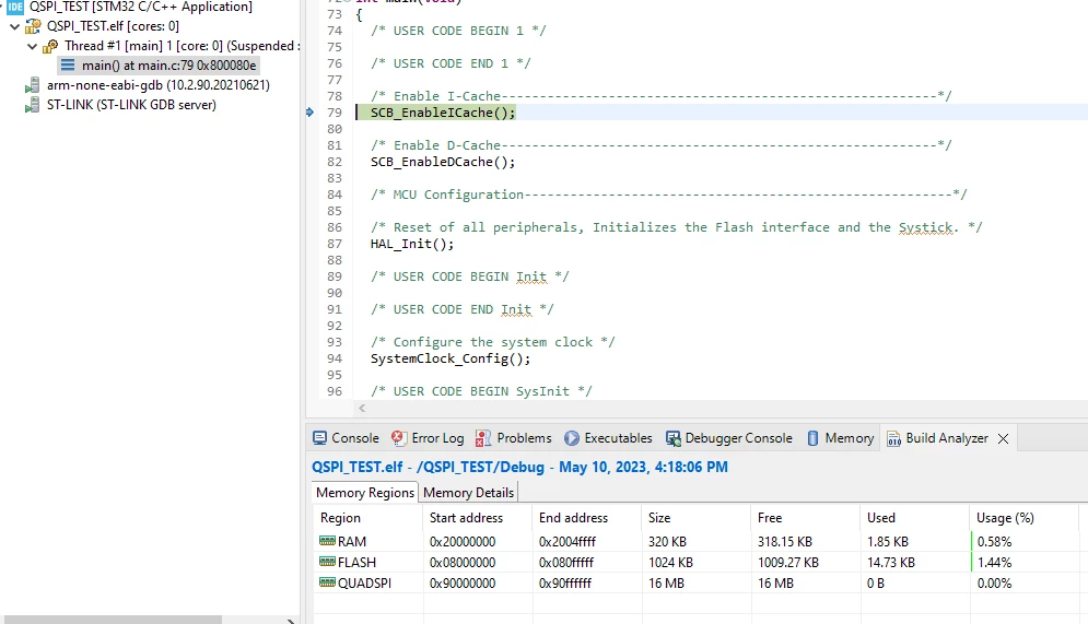

Yugenthar
May 10, 2023 10:54 AM UTC
Hai bro Still I am working in QSPI concept in stm32f746 disco board
I tried to write the data for QSPI flash memory but I can't able to write and read the QSPI flash memory i need your help bro i have attached my code and snap pls find and give any sollution are example code

HP_it
HP_itAuthor
Senior II
May 10, 2023 11:21 AM UTC
did you follow the video guide?
you should add the QSPI memory area to your linker script and configure the QSPI using the CUBE view - be aware that the default settings does not work - you need to adjust the timings for your specific chip.
if you are on the disco board you can just copy all the settings from a default tGFX demo but if you have made your own board you will need to find the timings in the appropriate datasheet.
Furthermore you need to include the memory mapped read/write functions - I took them from the discovery board codebase.
It should be in the video almost all of it.
