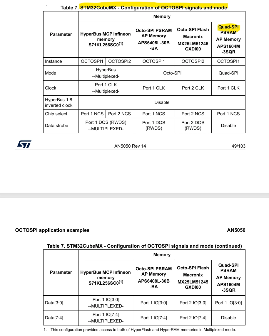

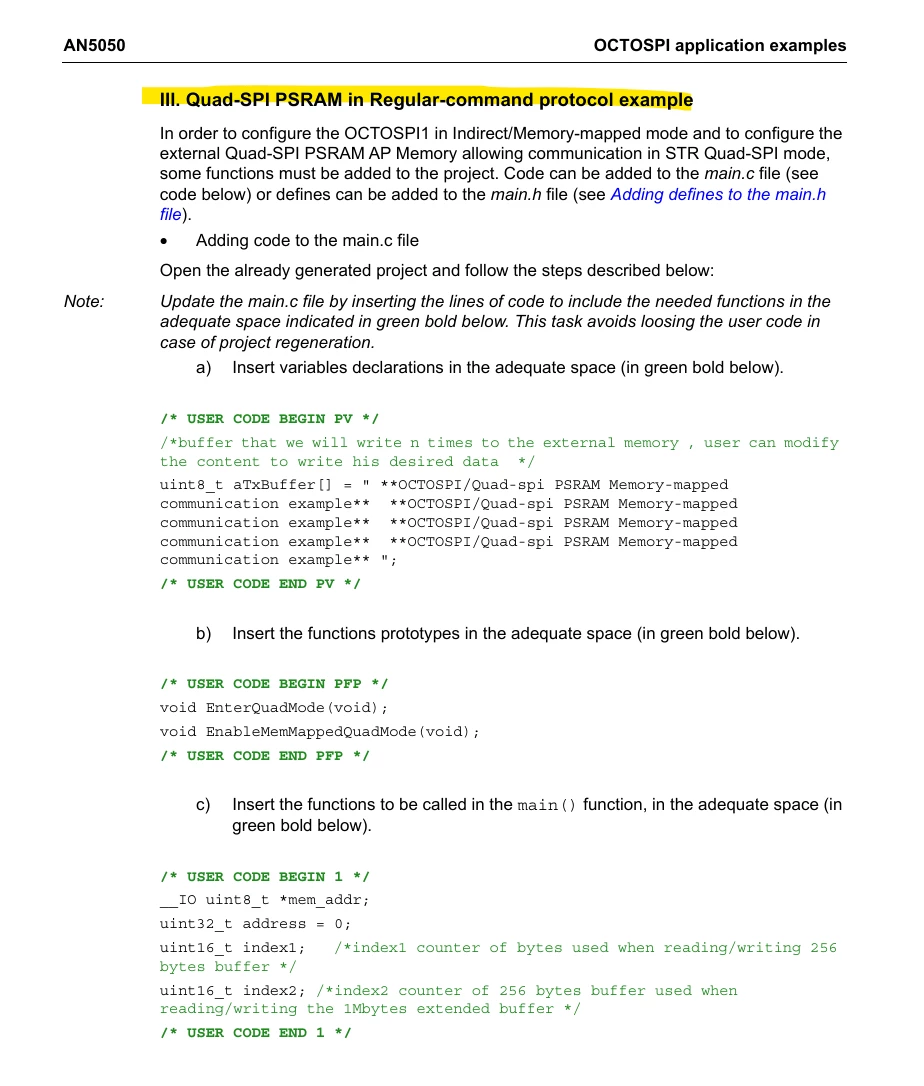

KDJEM.1
Sep 22, 2026 2:14 PM UTC
Hello ​@NAmam.2 ;
To better understand the main differences between using Quad-SPI flash memory and Octal-SPI flash, I recommend you to look at  AN5050 “Table 7. STM32CubeMX - Configuration of OCTOSPI signals and mode” and “III. Quad-SPI PSRAM in Regular-command protocol example” sections
Also, I think the BSP example can help you. This example shows how to use the different functionalities of components available on the board like as HSPI and TOUCHSCREEN.
Thank you.
