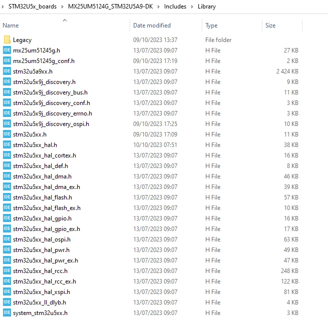

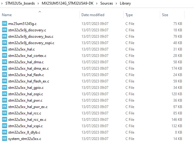

Ensure the following:
The MX25UM5124G_STM32U5A9-DK\Includes\Library folder must contain these headers as shown in the below figure:
The MX25UM5124G_STM32U5A9-DK\Sources\Library folder must contain these headers as shown in the below figure.

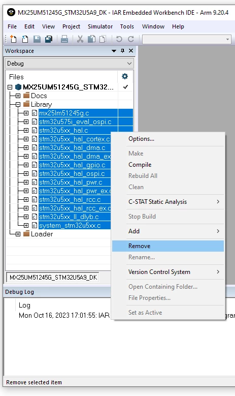

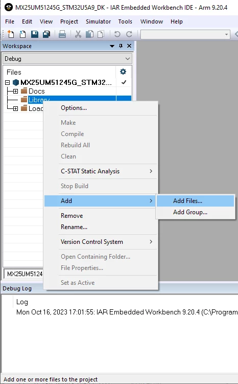

- Select all sources files in library then click right and remove them as shown in the figure below:
- Right click on Library -> Add -> Add Files, select all source files available under MX25UM51245G_STM32U5A9-DK\Sources\Library\

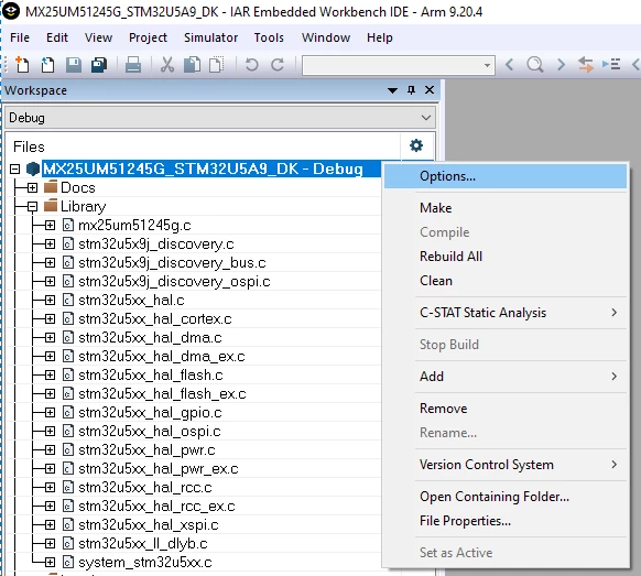

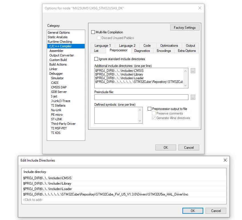

- Right click in the project then select "options" and add the include path:
"$PROJ_DIR$\..\..\Includes\CMSIS"
"$PROJ_DIR$\..\..\Includes\Library"
"$PROJ_DIR$\..\..\Includes\Loader"
"$PROJ_DIR$\..\..\..\..\..\..\STM32Cube\Repository\STM32Cube_FW_U5_V1.3.0\Drivers\STM32U5xx_HAL_Driver\Inc"

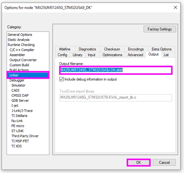

- Modify the output name:

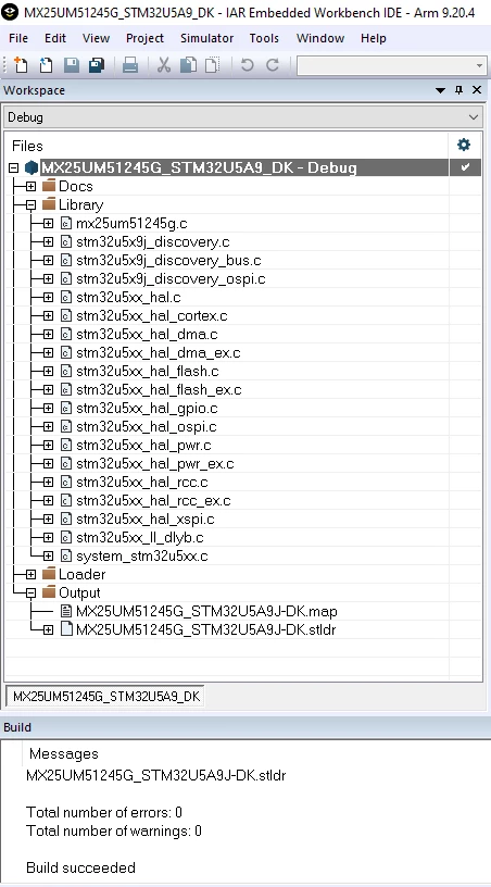

- Build the project and make sure that the built is succeeded with 0 error and warnings. An MX25UM5124G_STM32U5A9J-DK.stldr is created in the output.

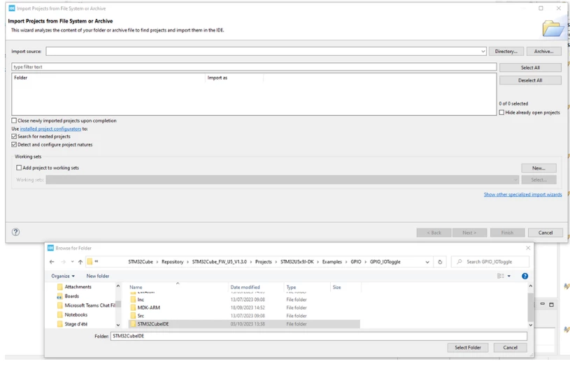

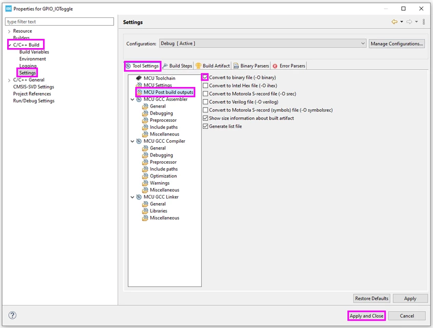

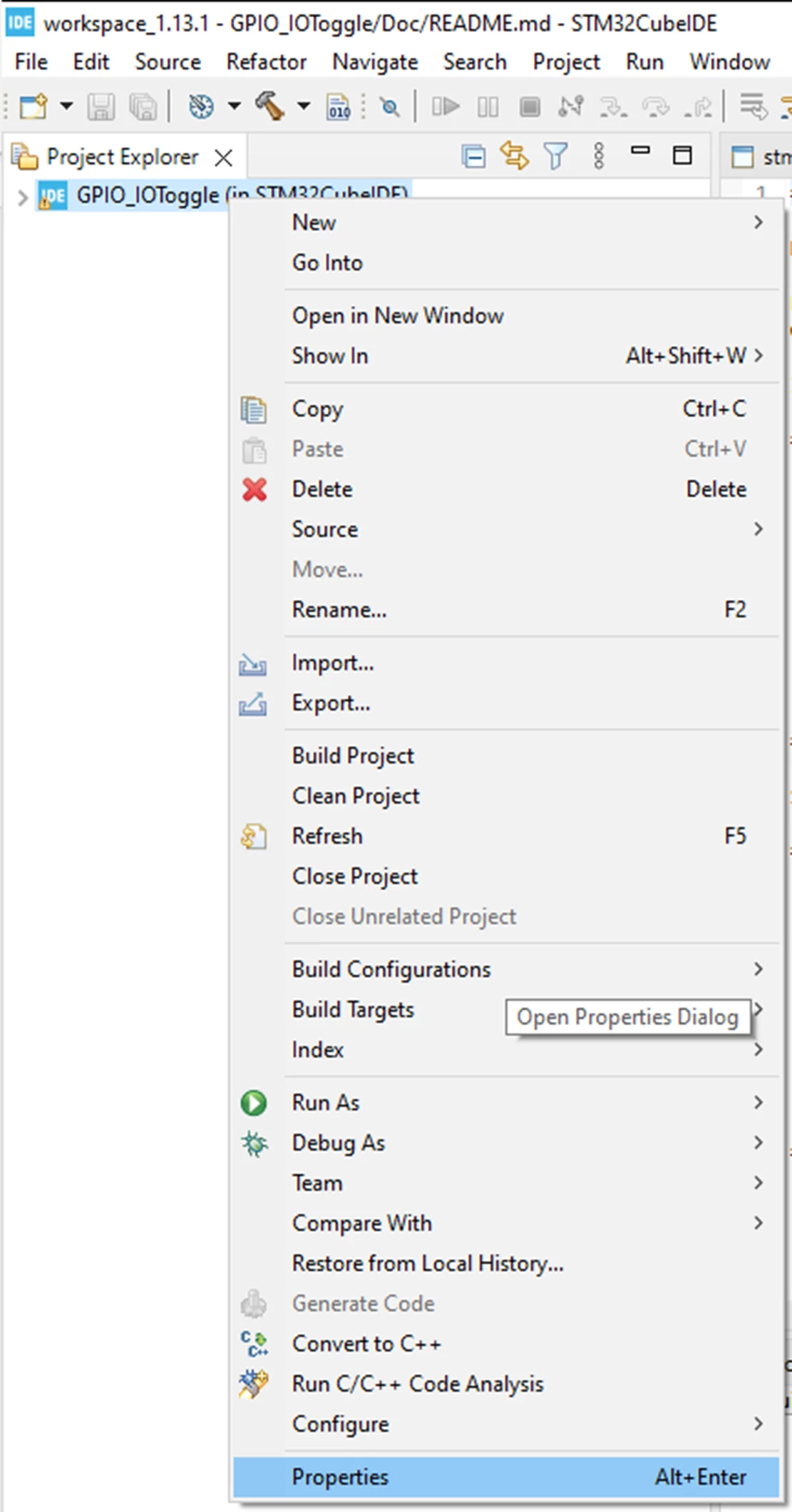

Open GPIO_IOToggle example from \Repository\STM32Cube_FW_U5_V1.3.0\Projects\STM32U5x9J-DK\Examples\GPIO\GPIO_IOToggle using STM32CubeIDE as shown in the below figure:
Right-click the GPIO_IOToggle project to modify its properties
- Select "Convert to binary file(-O binary)" to create a binary file as shown in the figure below

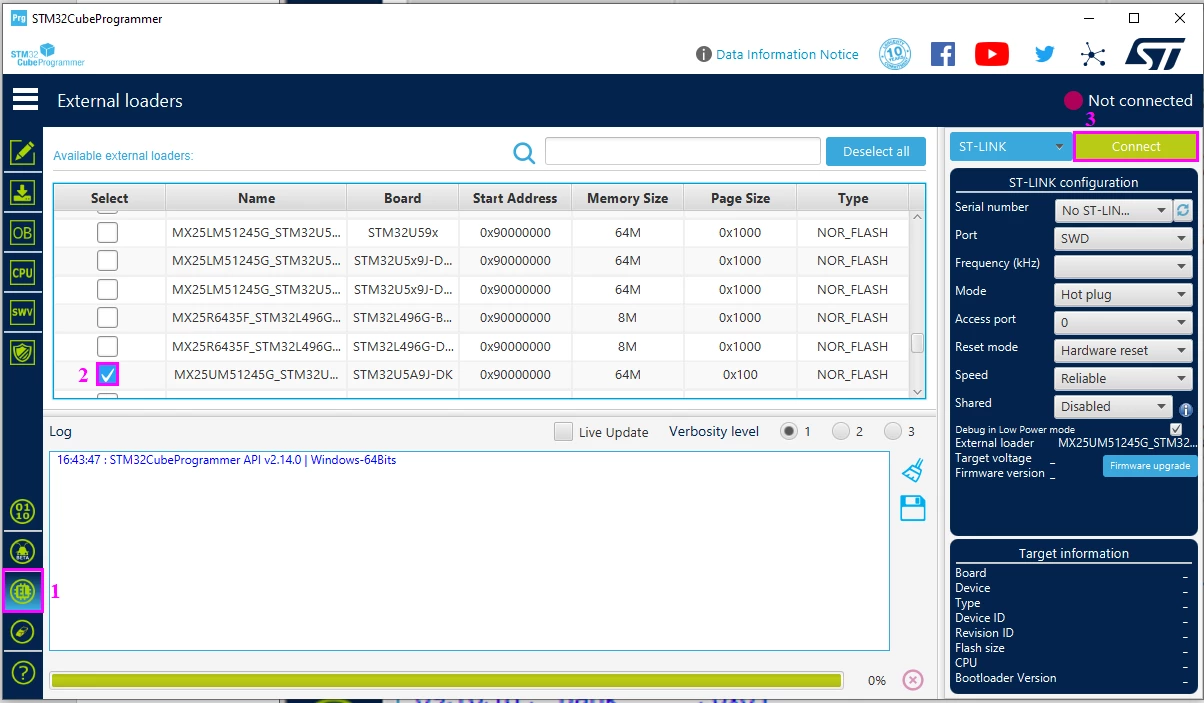

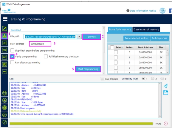

Open STM32CubeProgrammer and click to External loaders, select MX25UM5124G_STM32U5A9J-DK.stldr and click to connect as in the figure below
Click on the icon "Erasing & programming":
Browse to the GPIO_IOToggle.bin binary created previously.
Choose the "Start address" 0x90000000 and select "Verify programming" to verify the download.
Click on "Start Programming".
Please make sure that the download verified successfully. -
Click button reset and you can see LD3 and LD4 toggling.

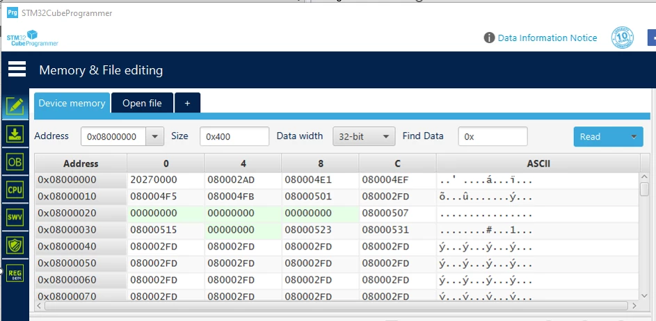

Go to "Memory & File editing" and verify the same data output in 0x08000000 and in 0x90000000.
