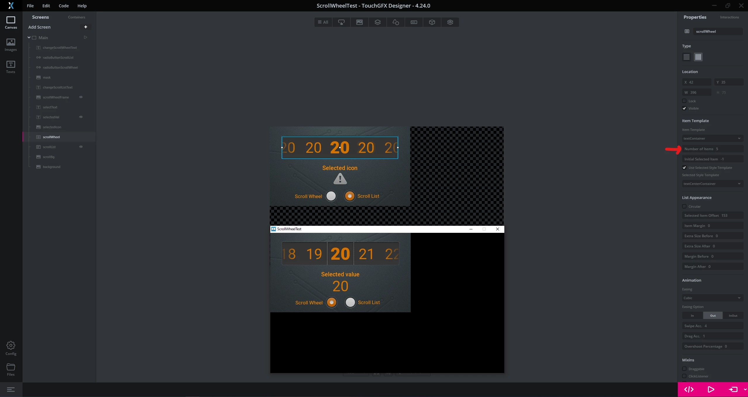

Hello @brymat ,
Sorry for the late response,
I realized that you need to set the 'Number of Items' in the designer, as large as the number of visible elements in the designer or bigger. So, for instance, in the example that you have provided, you just need to set the number of elements to 5 in the beginning and then change it later.
The simulation working correctlyThe simulation working correctly
There should a bug that causes this behavior, in other words, there is a dependency on the first call to setNumberOfItems. We will dig into it more, and hopefully fix the issue as soon as possible. But, I hope the current solution can help you progress.
Good luck

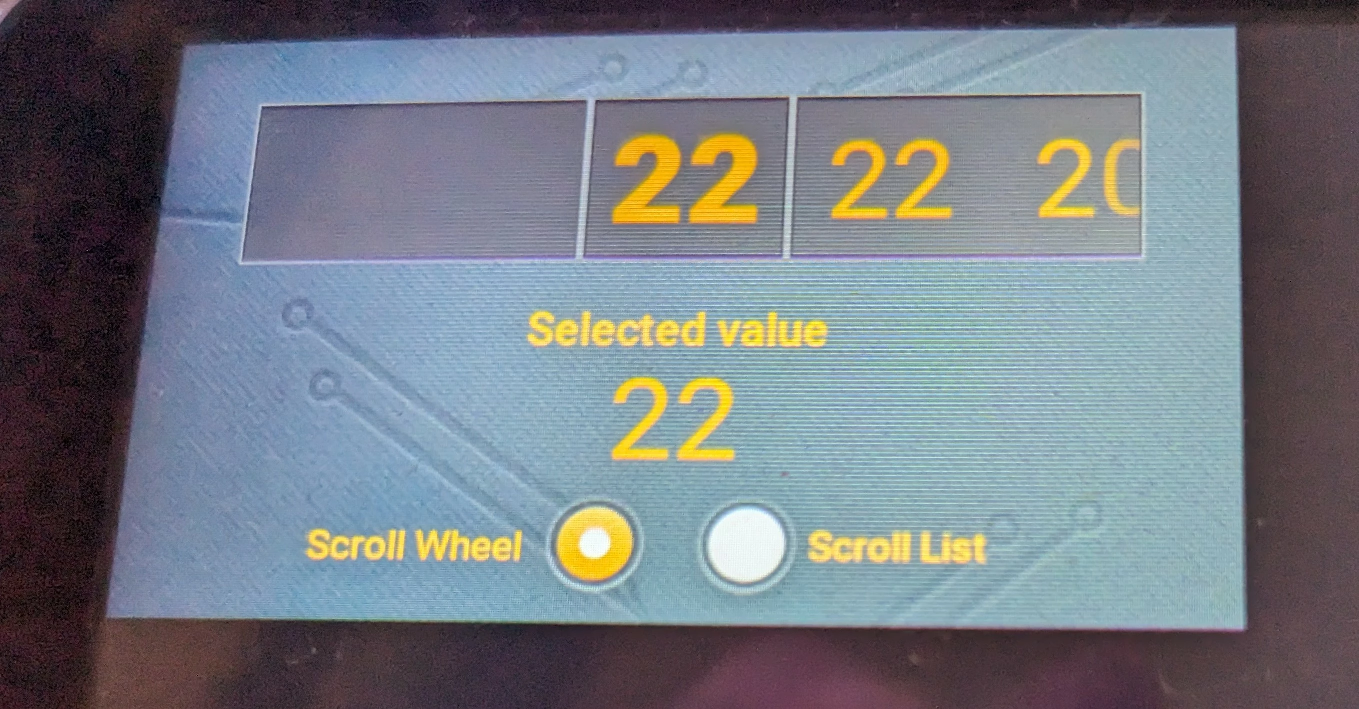

brymatAuthor
May 17, 2024 9:32 PM UTC
I have attached a simple example based on the Scroll Wheel example in TouchGFX and targeting the STM32H747I discovery kit.
If you switch to the "Scroll Wheel" option in the display, you will see the duplicated values in the list right away.  Scrolling back and forth shows many odd values in the list.  Although the selected value is always correct.
I have also attached a photo as an example.  In the photo, I would have expected to see the values 22, 23, 24, not 22, 22, and 20.

Jun 26, 2024 11:39 AM UTC
Hello @brymat ,
Good luck
Mohammad MORADIST Software Developer | TouchGFX
