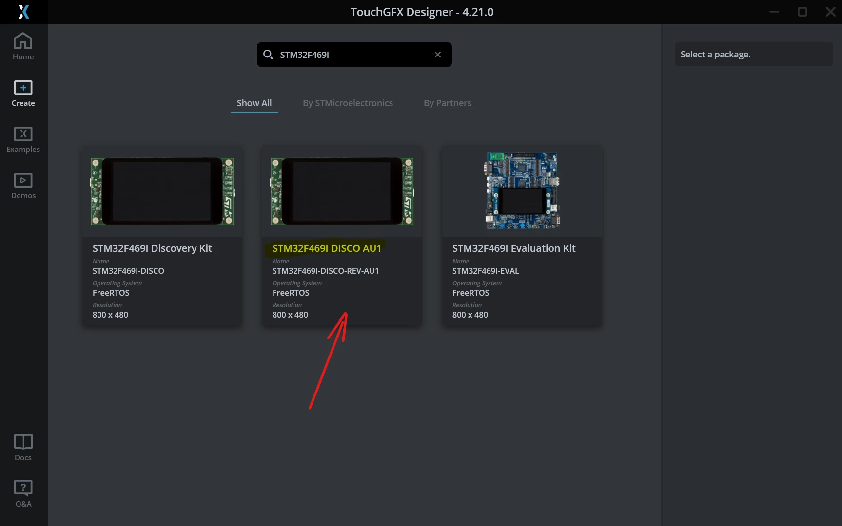

Does TouchGFX Designer support DK32F469@AU1 blue pcb board? (NOT 32F469DISCO green pcb)
To test the Examples provided by TouchGFX Designer v4.20.0,
I purchased the STM32F469I Discovery Kit.
However, the TouchGFX Designer's Canvas screen is not loaded on the LCD screen.
Downloading is perfectly completed.
(Already I installed STM32CubeProgrammer v2.11.0 and
I have experience in developing using STM32G071_NUCLEO board and X-NUCLEO-GFX01M1.)
It seems to be related to UM1932 Chapter 6.2 32F469DISCOVERY prodct history.
The board I have is (blue color pcb) DK32F469I@AU1 and MB1189-F469NIH6-B08
But It seems that only (green color pcb) MB1189-F469NIH6-B07 is supported by TouchGFX Designer.
Revision B-07 products are currently not purchasable.
I'm in big trouble because It seems to be not supported by TouchGFX Designer.
How can I test TouchGFX in DK32F469@AU1 Rev-B08 blue pcb board?
Please help me.

Hello JKim.27,
A new TBS is now available on TouchGFX Designer 4.21.0 for this STM32F469I-Disco $AU1 revision (B08)
/Osman

Osman SOYKURT
Jan 2, 2023 10:23 AM UTC
Helllo JKim.27,
Indeed we're aware that this revision of this board is not compatible with the TBS we provide online. We're currently working on this issue. I'll get back to you when I'll have more info.
The STM32F769I Disco board is supported by TouchGFX Designer yes. If you have not already done it, I recommend you to download TouchGFX Designer 4.21.0, and you'll be able to see all the TBSs we created, meaning that they are board we natively support in TouchGFX Designer, and you'll also see which screen resolution they have.

Jan 3, 2023 9:48 AM UTC
No, they're probably not compatible with our TBS either. If you refer to the UM2033 "Discovery kit with STM32F769NI MCU" and precisely Section 8.3.6 Board MB1166 revision A-09, you can conclude that:
The revision A-09 MB1166 board (included in the of the DK32F769I@AU1 and DK32F769I@AU2 products) corresponds to:" LCD FRIDA FRD397B25009-D-CTK replaced by FRIDA FRD400B25025-A-CTK".
The TBS we have is based on a board MB1166 revision A-03 so my guess is that's it's not compatible. I've found a thread talking about this subject as well.

Osman SOYKURTBest answer
Jan 9, 2023 10:44 AM UTC
Hello JKim.27,
