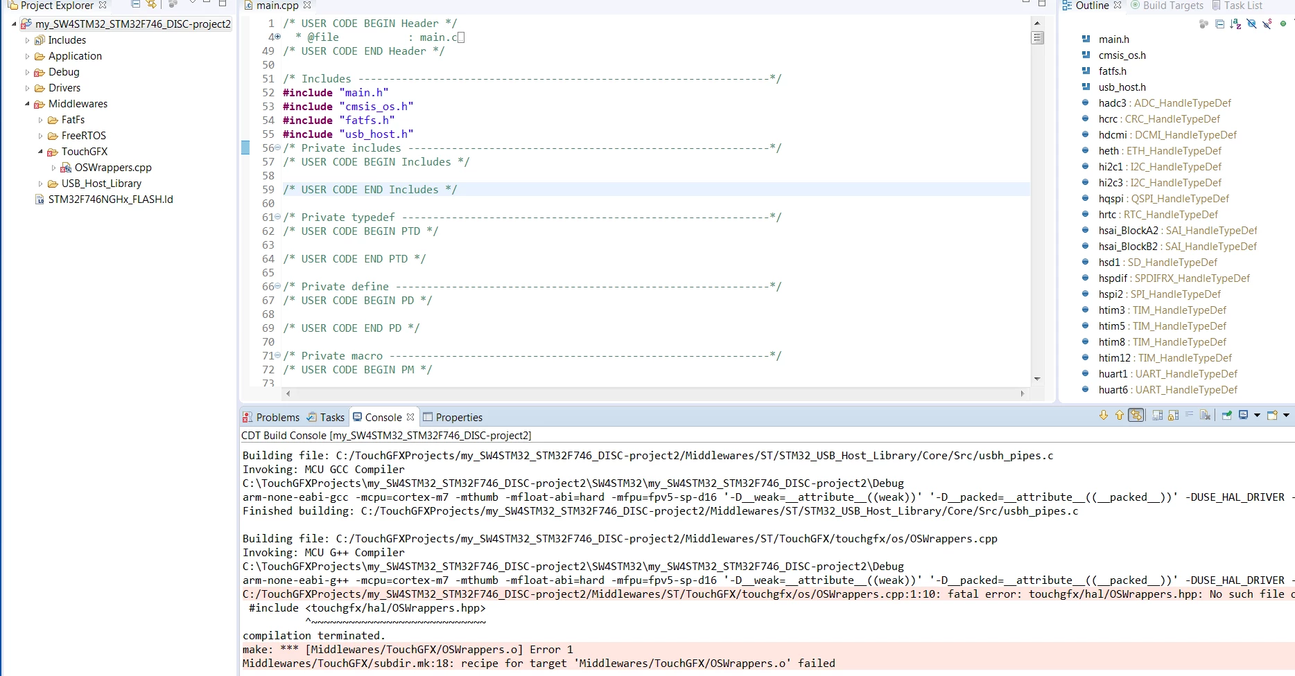

Clark Sann
Dec 9, 2018 6:21 PM UTC
@PPiar​
For some reason, when I do what you suggested, I still cannot build. Here is exactly what I am doing:
  1. Use CubeMX to create a TouchGFX project using SW3STM32.
  2. In CubeMX, click the Execute button, and use TouchGFX Designer to create a simple GUI with a couple buttons and a couple sliders.
  3. Close CubeMX and open SW4STM32.
  4. In the Project Explorer, navigate to Project->TouchGFX->simulator. Right click the simulator folder, select Resource Configurations->Exclude from Build. The folder and all of its contents are grayed out and the icon has a slash through it.
  5. In the Project Explorer, navigate to Project->Middlewares->ST->TouchGFX->touchgfx->framework->source->platform->hal->simulator->sdl2. Right click the simulator folder, select Resource Configurations->Exclude from Build. The folder and all of its contents are grayed out and the icon has a slash through it.
  6. Build and get the following error: C:/Users/Administrator/workspace/Test_SW4STM33/Middlewares/ST/TouchGFX/touchgfx/framework/include/platform/hal/simulator/sdl2/HALSDL2.hpp:22:10: fatal error: SDL2/SDL_video.h: No such file or directory #include <SDL2/SDL_video.h>. This is apparently caused because the project does not have the SDL2 folder in the include path.
  7. Add the following to the include path in Project Properties->C/C++ Build->Paths and Symbols-> CNU C++->Includes: Middlewares\ST\TouchGFX\touchgfx\framework\include\platform\hal\simulator\sdl2\vendor\
  8. Rebuild. This time the compiler finds the missing files but still produces this error:
Building file: ../Middlewares/ST/TouchGFX/touchgfx/framework/source/platform/driver/touch/SDL2TouchController.cpp
Invoking: MCU G++ Compiler
C:\Users\Administrator\workspace\Test_SW4STM33\Debug
arm-none-eabi-g++ -mcpu=cortex-m7 -mthumb -mfloat-abi=hard -mfpu=fpv5-sp-d16 '-D__weak=__attribute__((weak))' '-D__packed=__attribute__((__packed__))' -DUSE_HAL_DRIVER -DSTM32F746xx '-DUSE_BPP=16' -I"C:/Users/Administrator/workspace/Test_SW4STM33/FATFS/Target" -I"C:/Users/Administrator/workspace/Test_SW4STM33/FATFS/App" -I"C:/Users/Administrator/workspace/Test_SW4STM33/Core/Inc" -I"C:/Users/Administrator/workspace/Test_SW4STM33/TouchGFX/target" -I"C:/Users/Administrator/workspace/Test_SW4STM33/USB_HOST/App" -I"C:/Users/Administrator/workspace/Test_SW4STM33/USB_HOST/Target" -I"C:/Users/Administrator/workspace/Test_SW4STM33/TouchGFX/generated/fonts/include" -I"C:/Users/Administrator/workspace/Test_SW4STM33/TouchGFX/generated/texts/include" -I"C:/Users/Administrator/workspace/Test_SW4STM33/TouchGFX/generated/images/include" -I"C:/Users/Administrator/workspace/Test_SW4STM33/TouchGFX/generated/gui_generated/include" -I"C:/Users/Administrator/workspace/Test_SW4STM33/TouchGFX/gui/include" -I"C:/Users/Administrator/workspace/Test_SW4STM33/Middlewares/ST/TouchGFX/touchgfx/framework/include" -I"C:/Users/Administrator/workspace/Test_SW4STM33/Drivers/STM32F7xx_HAL_Driver/Inc" -I"C:/Users/Administrator/workspace/Test_SW4STM33/Drivers/STM32F7xx_HAL_Driver/Inc/Legacy" -I"C:/Users/Administrator/workspace/Test_SW4STM33/Middlewares/Third_Party/FatFs/src" -I"C:/Users/Administrator/workspace/Test_SW4STM33/Middlewares/Third_Party/FreeRTOS/Source/include" -I"C:/Users/Administrator/workspace/Test_SW4STM33/Middlewares/Third_Party/FreeRTOS/Source/CMSIS_RTOS" -I"C:/Users/Administrator/workspace/Test_SW4STM33/Middlewares/Third_Party/FreeRTOS/Source/portable/GCC/ARM_CM7/r0p1" -I"C:/Users/Administrator/workspace/Test_SW4STM33/Middlewares/ST/STM32_USB_Host_Library/Core/Inc" -I"C:/Users/Administrator/workspace/Test_SW4STM33/Middlewares/ST/STM32_USB_Host_Library/Class/CDC/Inc" -I"C:/Users/Administrator/workspace/Test_SW4STM33/Drivers/CMSIS/Device/ST/STM32F7xx/Include" -I"C:/Users/Administrator/workspace/Test_SW4STM33/Drivers/CMSIS/Include" -I"C:/Users/Administrator/workspace/Test_SW4STM33/Middlewares/ST/TouchGFX/touchgfx/framework/include/platform/hal/simulator/sdl2/vendor" -Og -g3 -Wall -fmessage-length=0 -ffunction-sections -c -fno-exceptions -fno-rtti -MMD -MP -MF"Middlewares/ST/TouchGFX/touchgfx/framework/source/platform/driver/touch/SDL2TouchController.d" -MT"Middlewares/ST/TouchGFX/touchgfx/framework/source/platform/driver/touch/SDL2TouchController.o" -o "Middlewares/ST/TouchGFX/touchgfx/framework/source/platform/driver/touch/SDL2TouchController.o" "../Middlewares/ST/TouchGFX/touchgfx/framework/source/platform/driver/touch/SDL2TouchController.cpp"
In file included from C:/Users/Administrator/workspace/Test_SW4STM33/Middlewares/ST/TouchGFX/touchgfx/framework/include/platform/hal/simulator/sdl2/vendor/SDL2/SDL_video.h:31:0,
         from C:/Users/Administrator/workspace/Test_SW4STM33/Middlewares/ST/TouchGFX/touchgfx/framework/include/platform/hal/simulator/sdl2/HALSDL2.hpp:22,
         from ../Middlewares/ST/TouchGFX/touchgfx/framework/source/platform/driver/touch/SDL2TouchController.cpp:17:
C:/Users/Administrator/workspace/Test_SW4STM33/Middlewares/ST/TouchGFX/touchgfx/framework/include/platform/hal/simulator/sdl2/vendor/SDL2/SDL_stdinc.h:261:50: error: size of array 'SDL_dummy_enum' is negative
    typedef int SDL_dummy_ ## name[(x) * 2 - 1]
C:/Users/Administrator/workspace/Test_SW4STM33/Middlewares/ST/TouchGFX/touchgfx/framework/include/platform/hal/simulator/sdl2/vendor/SDL2/SDL_stdinc.h:290:1: note: in expansion of macro 'SDL_COMPILE_TIME_ASSERT'
 SDL_COMPILE_TIME_ASSERT(enum, sizeof(SDL_DUMMY_ENUM) == sizeof(int));
Middlewares/ST/TouchGFX/touchgfx/framework/source/platform/driver/touch/subdir.mk:21: recipe for target 'Middlewares/ST/TouchGFX/touchgfx/framework/source/platform/driver/touch/SDL2TouchController.o' failed
make: *** [Middlewares/ST/TouchGFX/touchgfx/framework/source/platform/driver/touch/SDL2TouchController.o] Error 1
I have no idea how to fix this error.
Was your compiler able to find a path to the SDL2 folder? Do you have any ideas why you are able to build your project and I cannot build mine?
Thank you in advance for any further help you can provide!
PPiar
Visitor II
Dec 11, 2018 6:41 AM UTC
exclude file platform/driver/touch/SDL2TouchController.cpp from compilation
Clark Sann
Dec 13, 2018 9:58 PM UTC
Thank you for that advice! I did that and everything compiled!

Jan 3, 2019 7:12 PM UTC
​Hi Kumar,
As per your instruction, I did everything.
There were few differences between F429 and F746 discovery boards, like I had to use SPI2 instead of SPI5.
But MX created the code without any warning. But when do clean and  a build, I get following build error and it gets terminated.
C:/TouchGFXProjects/my_SW4STM32_STM32F746_DISC-project2/Middlewares/ST/TouchGFX/touchgfx/os/OSWrappers.cpp:1:10: fatal error: touchgfx/hal/OSWrappers.hpp: No such file or directory
#include <touchgfx/hal/OSWrappers.hpp>
compilation terminated.
make: *** [Middlewares/TouchGFX/OSWrappers.o] Error 1
Middlewares/TouchGFX/subdir.mk:18: recipe for target 'Middlewares/TouchGFX/OSWrappers.o' failed
10:57:47 Build Finished (took 5s.982ms)
Following is the build screen. Please let me know how to fix this issue.
Thanks
Kiran
Mon2
Senior III
Jan 3, 2019 7:32 PM UTC
Hi Kiran (@KMunj​ ). Please review the article from Clark Sann (@Clark Sann​ :
https://community.st.com/s/question/0D50X0000AAHSjZSQX/how-to-get-a-working-touchgfx-project-working-with-stm32f746gdisco-board-and-sw4stm32
Hope this helps. Post back if it does not.
Kumar
KMunj
Jan 3, 2019 11:17 PM UTC
​Hi Kumar,
Thank you very much for the link. That was good. I managed to do the 1st two labs from the ST  seminar, I attended using EWARM. Everything worked as explained by Clark Sann in the document.
Hi Clark Sann,
Thank you very much for the article.
I will try other two labs tomorrow. They should work.
Thanks,
Kiran
