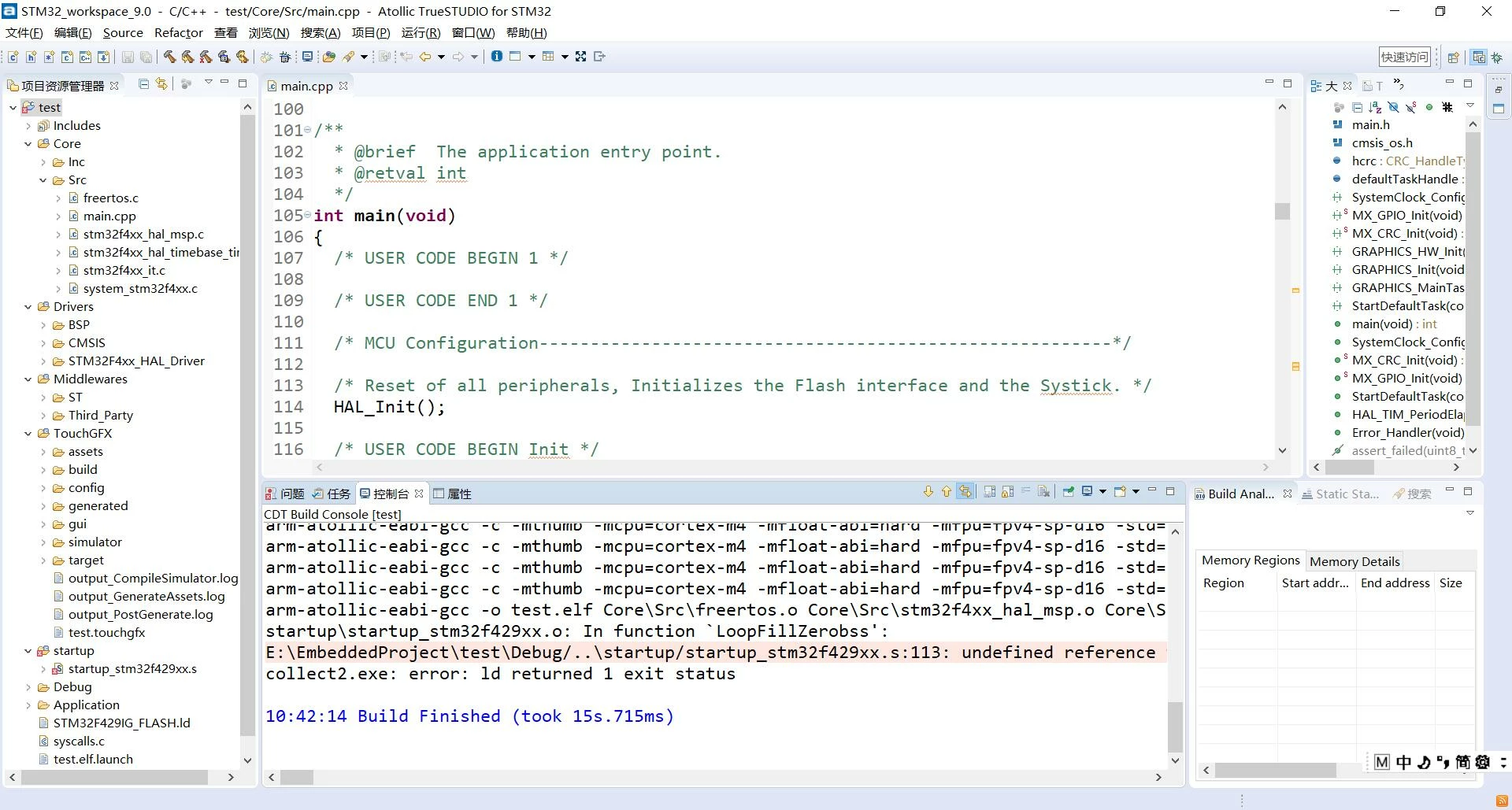

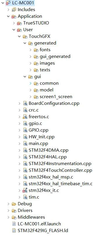

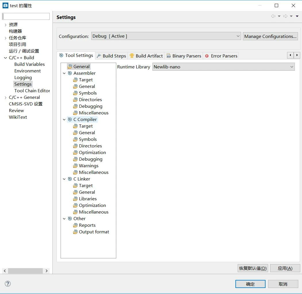

1. When opened the project, there were *.c , *.cpp , *.h and *.hpp files. But in C/C++ Build - Tool Setting , neither C++ Compiler and C++ Linker existed. So if I build the project under this settings, I will get a link error say something like main function undefined. Because main function is in main.cpp file and wound't be compile by GCC like other cpp files.
2. So I converted the project to C++ project, by using File - New - Convert to a C/C++ Project (Adds C/C++ nature) method. Now the C++ Compiler showed up and C++ Linker replaced C Linker.I built the project again, but a ton of error message like head files couldn't find show up. I fixed by copied and changed include path from C compiler directories to C++ compiler.But things not go well,some directories in Project Resources Manager's Includes still in grey which implicate those directories did not exist in that location.
3. Then I use TouchGFX Designer to generated a simple project which is only contains a single screen of a text and a background image.After code generation, I put the entire folder in TrueSTUDIO project's root. Now the "Includes" didn't has grey directories any more.I dragged all the cpp files which is generated by TouchGFX Designer into TrueSTUDIO project path [Application-User-TouchGFX-generated|gui].Things going in here is a bit out of my ability, since I am new in TouchGFX and new in mixin C(GCC) and C++(G++) code together.

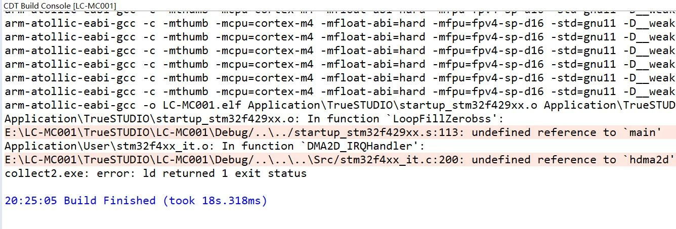

4. I tried out lots of combination of Assembler, C Complier, C++ Complier, C++ Linker settings which mention in TouchGFX website.I can't describe all of them.The best result I can get is all c files compile into *.o successfully by GCC and all C++ files compile into *.o successfully by G++, but when executed
arm-atollic-eabi-g++ -o LC-MC001.elf *.o ...
command,which as we know is linking, tons of error show up.
d:/program files (x86)/atollic/truestudio for stm32 9.0.0/armtools/bin/../lib/gcc/arm-atollic-eabi/6.3.1/../../../../arm-atollic-eabi/bin/ld.exe: error: LC-MC001.elf uses VFP register arguments, Application\User\Core\main.o does not
d:/program files (x86)/atollic/truestudio for stm32 9.0.0/armtools/bin/../lib/gcc/arm-atollic-eabi/6.3.1/../../../../arm-atollic-eabi/bin/ld.exe: failed to merge target specific data of file Application\User\Core\main.o
d:/program files (x86)/atollic/truestudio for stm32 9.0.0/armtools/bin/../lib/gcc/arm-atollic-eabi/6.3.1/../../../../arm-atollic-eabi/bin/ld.exe: error: LC-MC001.elf uses VFP register arguments, Application\User\TouchGFX\generated\ApplicationFontProvider.o does not
d:/program files (x86)/atollic/truestudio for stm32 9.0.0/armtools/bin/../lib/gcc/arm-atollic-eabi/6.3.1/../../../../arm-atollic-eabi/bin/ld.exe: failed to merge target specific data of file Application\User\TouchGFX\generated\ApplicationFontProvider.o
5. The last information about this I can find is related to floating point implementation? I already tried to switch all implementation to HW or SW the same time.But no luck.

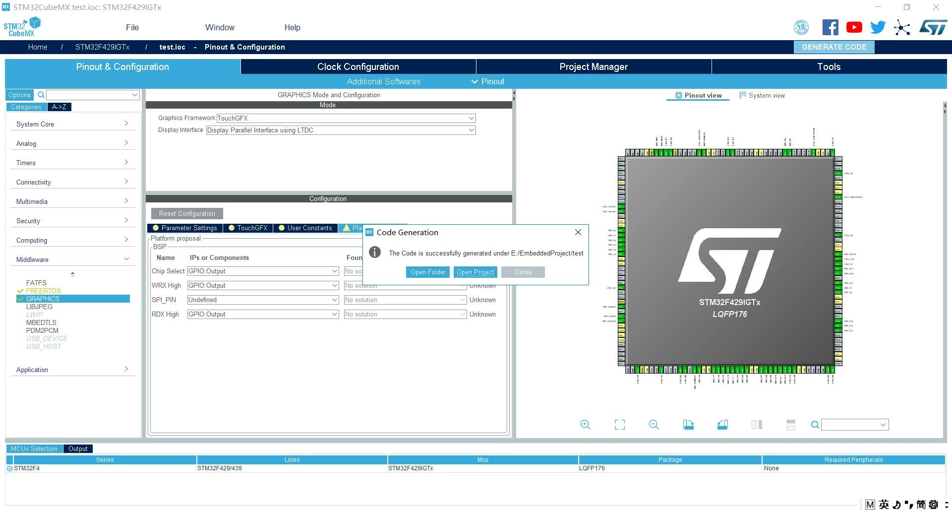

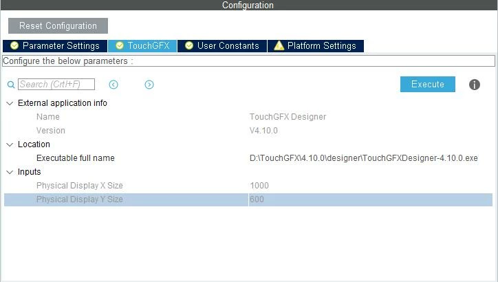

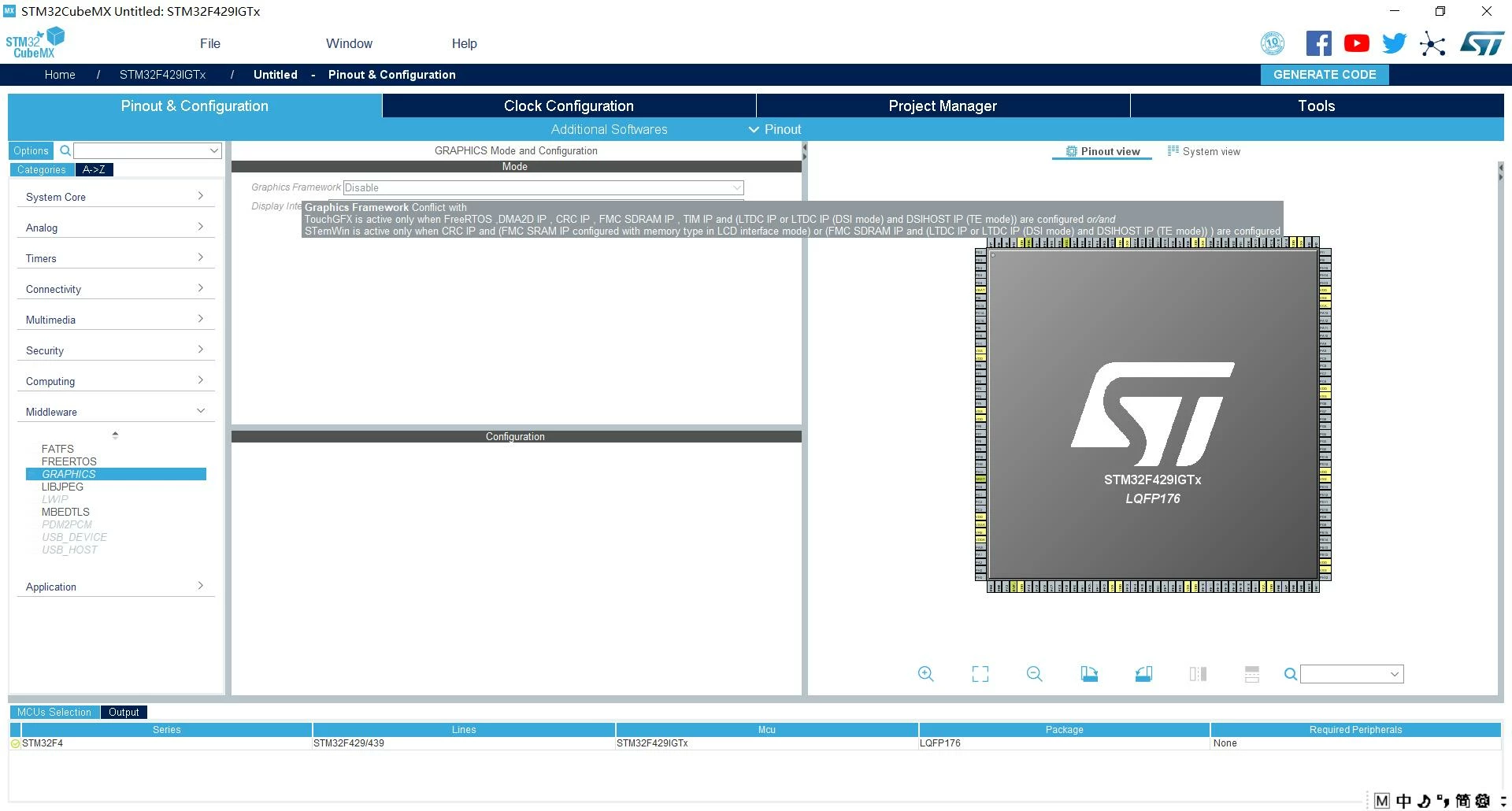

1.In the tutorial 10, CubeMX's GUI seems is an "old version" style. According to the software release note, the support of TouchGFX is start by v5.0.0, and I assume that is an internal version of CubeMX. So I just use what I can get, the v5.0.0.
2.After I configure pinout by my own, I move to Step 3. In the tutorial, the writer install a software called "ST-TouchGFX-4.9.4" in STM32Cube_FW_F4_V1.20.0 firmware package. I can only get F4 V1.22.0,and the "TouchGFX-4.10.0.msi" in it, which I already installed before.So I decided to "Repair" the designer by the *.msi, in case of I messed up something.

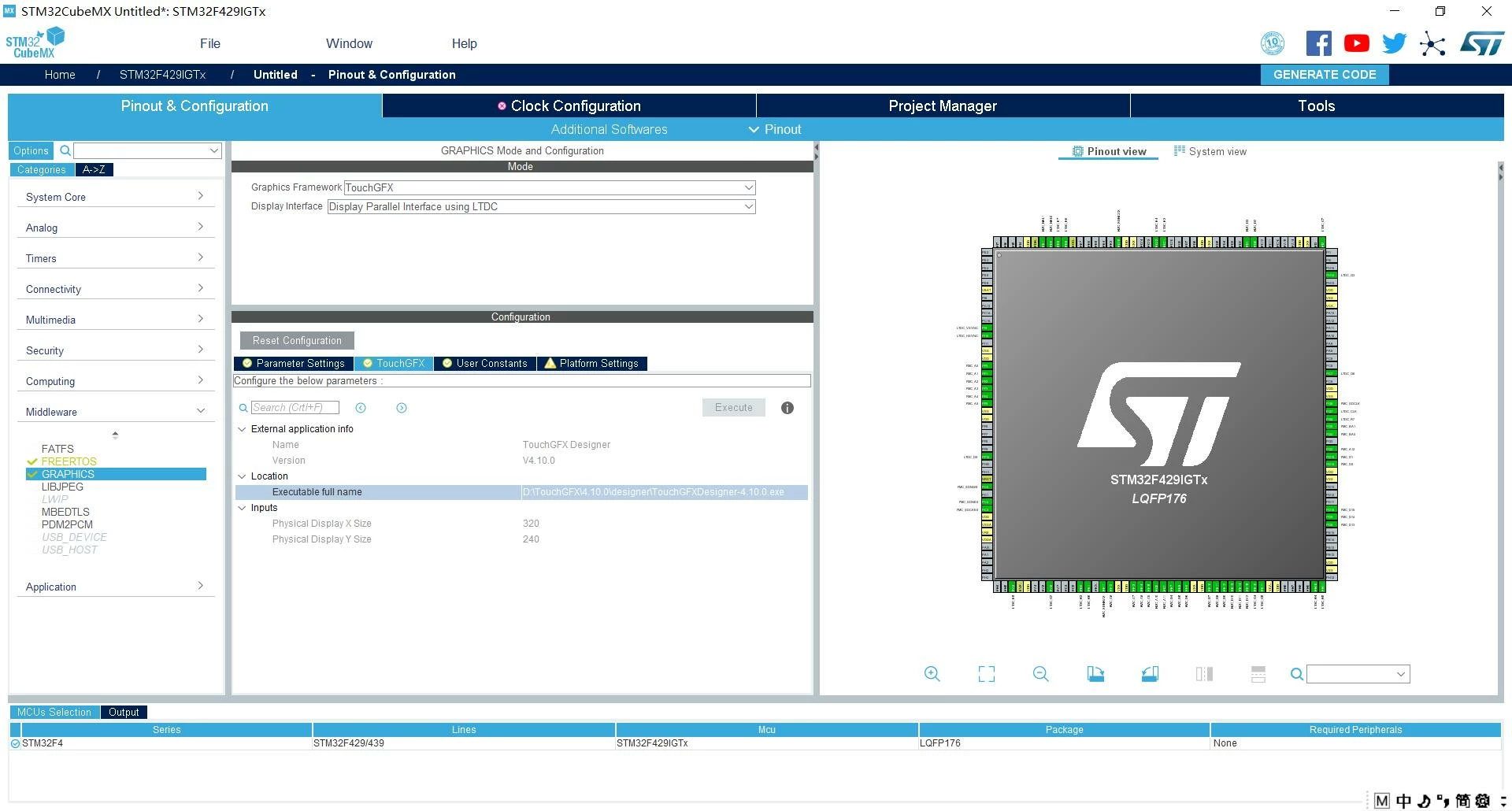

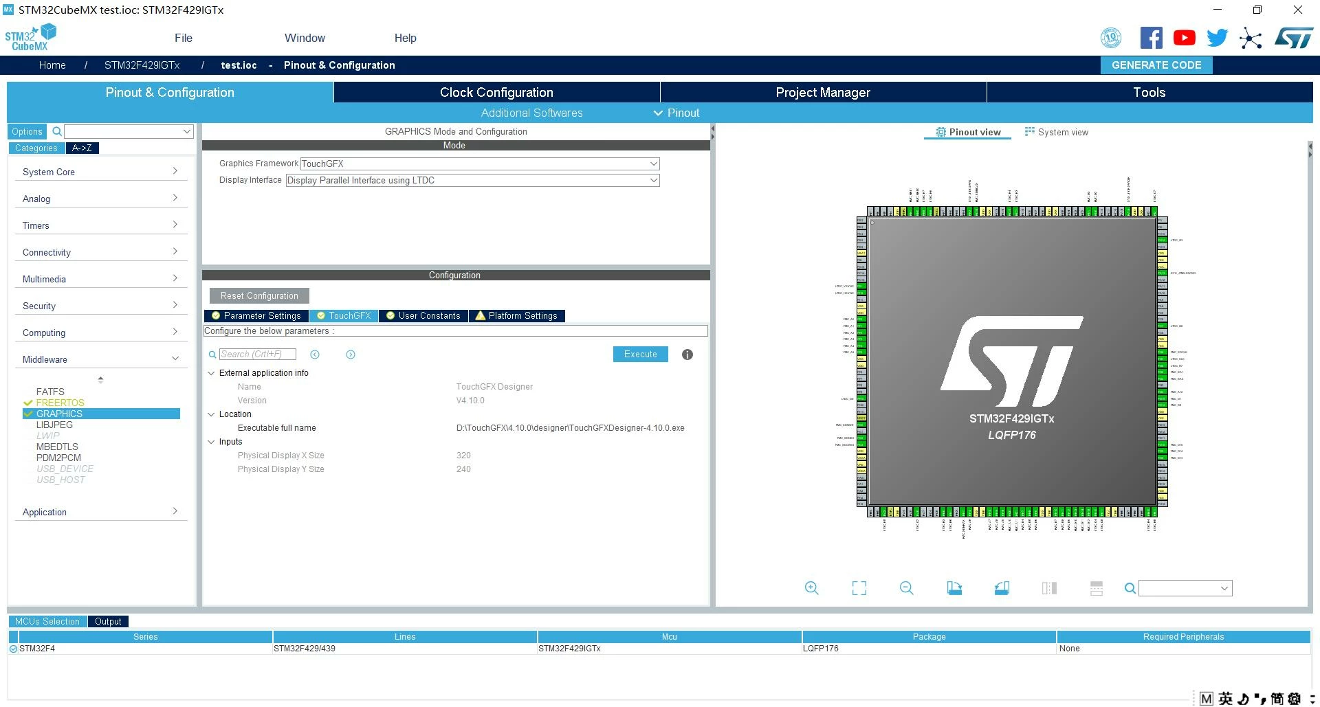

3.Then I linked the designer to GRAPHICS Configuration as the snapshot below.

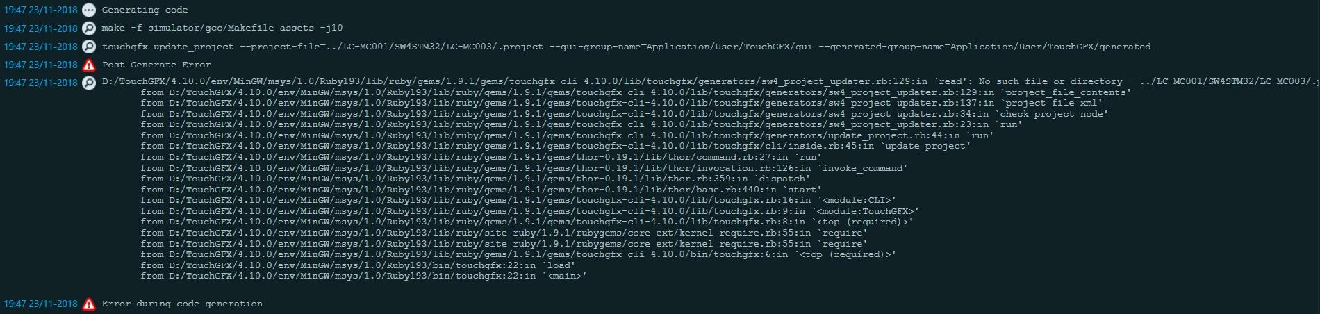

0690X000006CT3gQAG.jpg4.If the code never been generated, the "Execute" button won't be able to click.That is another difference between with tutorial. So I just click the button, and move to Step 4. After some simple design, I encounter an error of code generation.

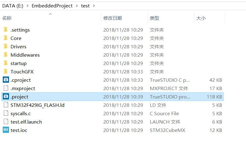

0690X000006CT3vQAG.jpg5.Then I opened the TrueSTUDIO project, the project structure look the same with the original problem mentioned.
6.After another tried, I the designer code generation error didn't occur.And the project now look like this.
0690X000006CT61QAG.jpgBut the C++ compile problem which mention in original problem still exist.

I am attempting to create a CubeMX project for SW4STM32 using a simple GUI created with TouchGFX Designer. When I do this I find that the guy-generated folder in Eclipse contains only place holder code. It does not contain the code that the TouchGFX designer created. In general I cannot figure out how to get the designer created code into the SW4STM32 project. I suspect it should happen automatically. That is probably the reason we have to click the Execute button in the TouchGFX part of CubeMX.
I notice other odd things.... when I create a new CubeMX project, the Execute button is initially grayed out. As far as I can tell, it doesn't not become active until I completely configure the project and click the Generate Code in CubeMX. But of course, at this point the code that was generated did not include any TouchGFX generated code, because the designer hasn't been run yet. So now that the Execute button is enabled, I click it and the Designer comes up.
Now there is a new problem. The designer comes up with a 320x240 pixel sized screen, which is not the proper size for my 32F756GDisco board. For this board, it should be 480x272. It appears that CubeMX did not properly configure the Designer with the required application template. I also just noticed that the TouchGFX tab in CubeMX contains the wrong screen size too. So it seems that CubeMX is not correctly setting the screen size for the selected board. It would be pointless to configure with this screen size so I have tried two things : 1) create a new TouchGFX project with only a button or a slider on it, and 2) use a previously created project. In both cases, the TouchGFX code is not included in my SW4STM32 project.
So, what are we to do to get the TouchGFX Designer code included in our SW4STM32 project? Incidentally, I have also tried this with Atollic TrueStudio and I get the same thing.
Another problem is that the location of the TouchGFX designer must be set each time a new CubeMX project is generated. Since the location of the Designer never changes, it would be good if you could save this setting somehow so it does not need to be set every time a new project is created.

When I build now, I am getting three errors:
Description Resource Path Location Type
undefined reference to `hdma2d' stm32f7xx_it.c /TouchGFX_Test_Atollic/Core/Src line 230 C/C++ Problem
undefined reference to `hltdc' stm32f7xx_it.c /TouchGFX_Test_Atollic/Core/Src line 216 C/C++ Problem
undefined reference to `main' startup_stm32f746xx.s /TouchGFX_Test_Atollic/startup line 113 C/C++ Problem

In my opinion, the CubeMX did not turn on the C++ compiler (G++) for you, so your IDE won't compile files which have cpp suffix.Including the main function which is wrote in main.cpp.
After all c files are compiler by GCC, the process move on and go to the link stage. Then the start file couldn't found main function and reported an error.
You can turn on C++ compiler by your own to fix this problem but more will come after.:grinning_face_with_sweat:

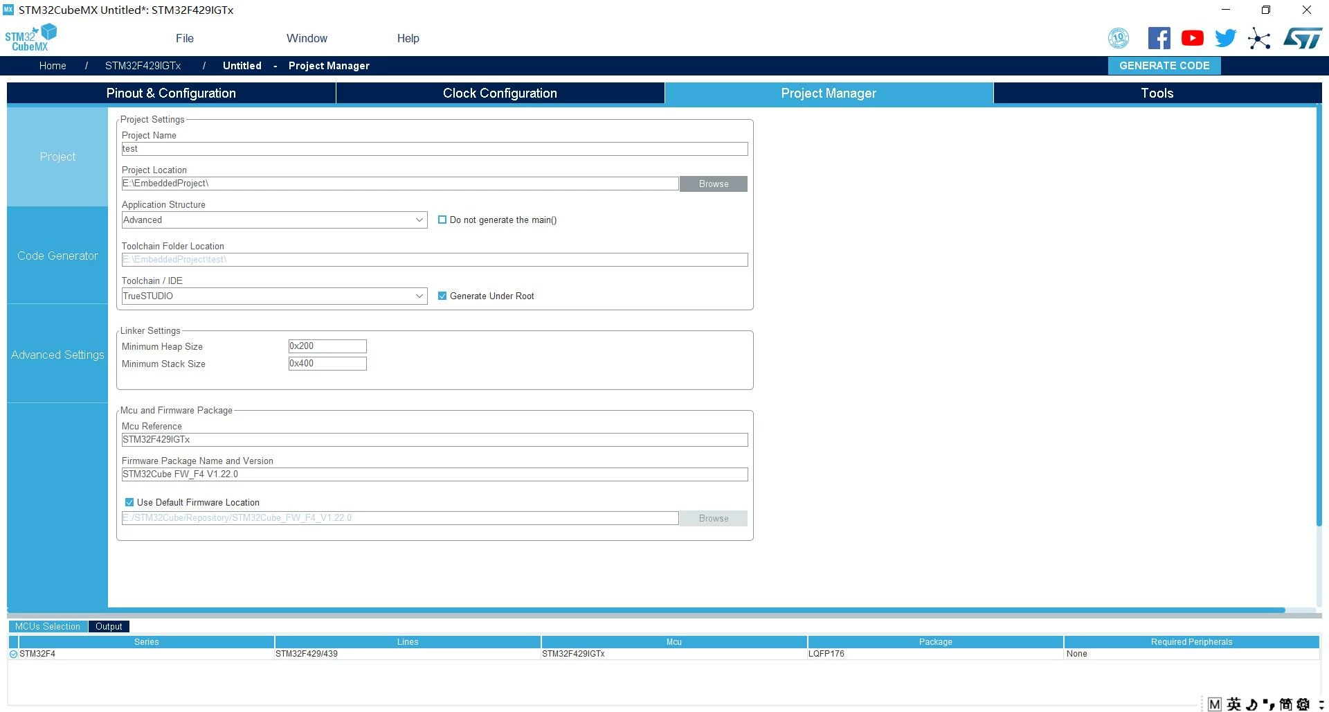

Nawres GHARBI
November 27, 2018
Hi @Zhi Pang​
I finally got your issue, it seems that you have generated first with the option "under root" checked and then you unchecked it.
For any GCC project it is not recommended to do this as it may corrupt the project.
If it is the case please regenerate your project with the previous setting and it will be OK

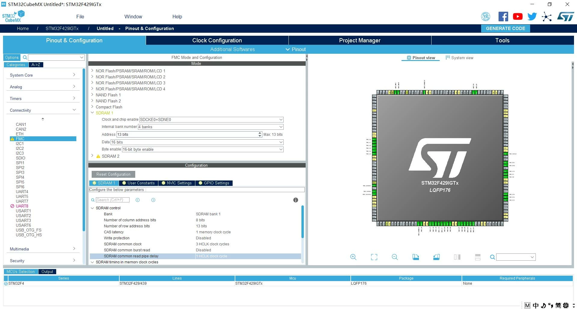

I'm no sure which step is wrong. Now I post every step I did and won't miss any detail. And hope it will help.
1 Start a new project with STM32F429IGTx.
2 Check the conditions that need to be enabled.

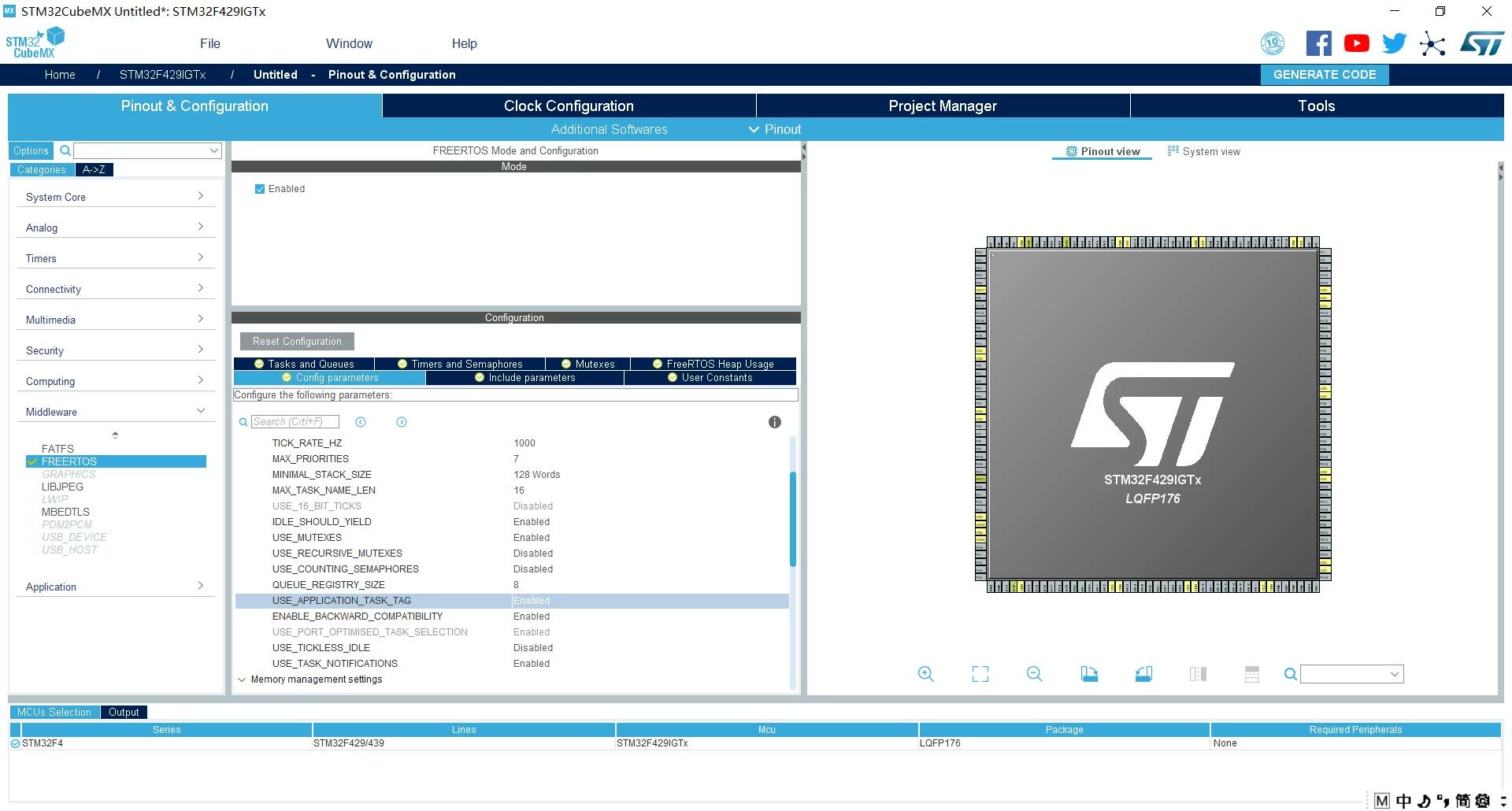

3 Enabled FreeRTOS and Enabled Config parameters - USE_APPLICATION_TASK_TAG.
4 Activated DMA2D and configure Parameter Settings.

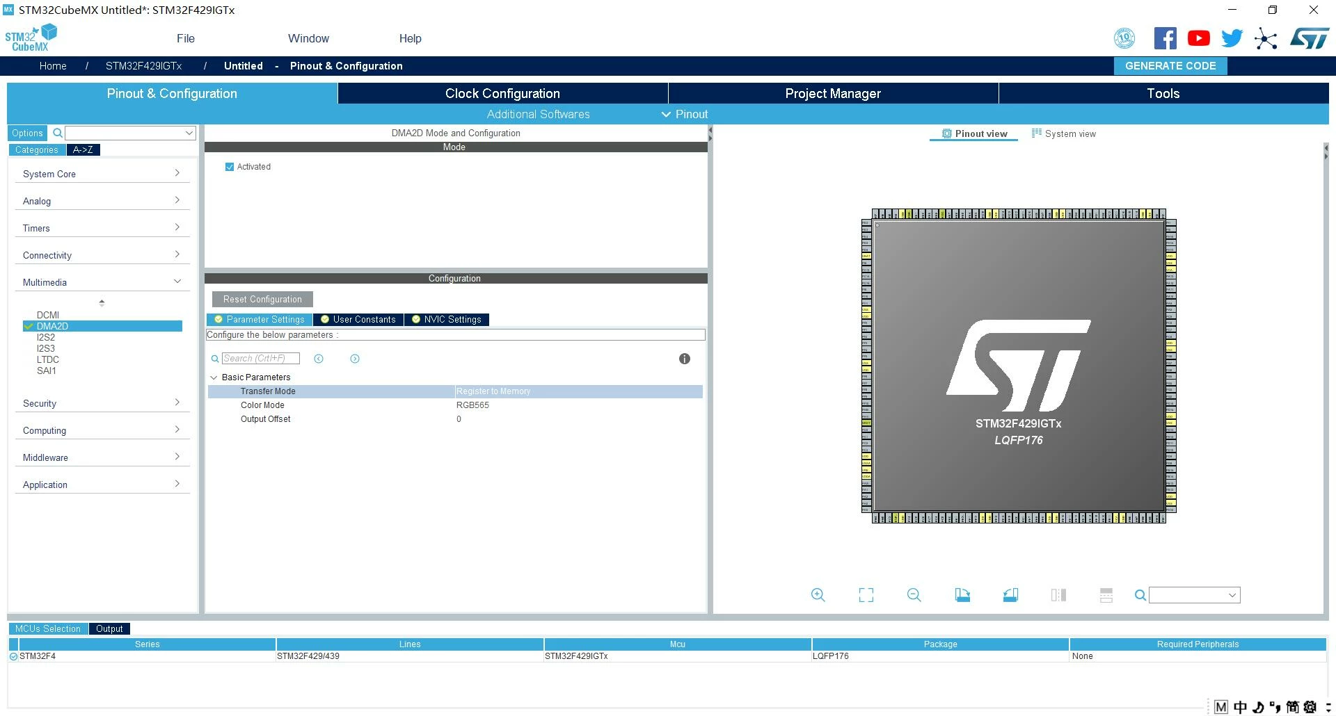

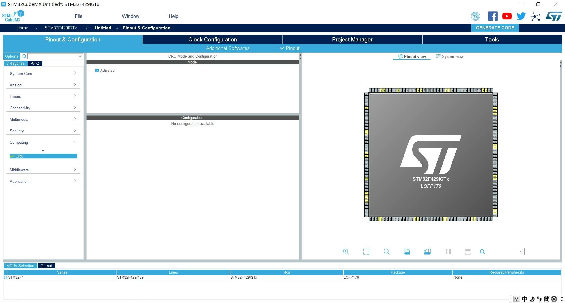

0690X000006CUs1QAG.jpg5 Activated CRC.
0690X000006CUs6QAG.jpg6 Turn on FMC - SDRAM1, and configure settings base on my SDRAM Chip.

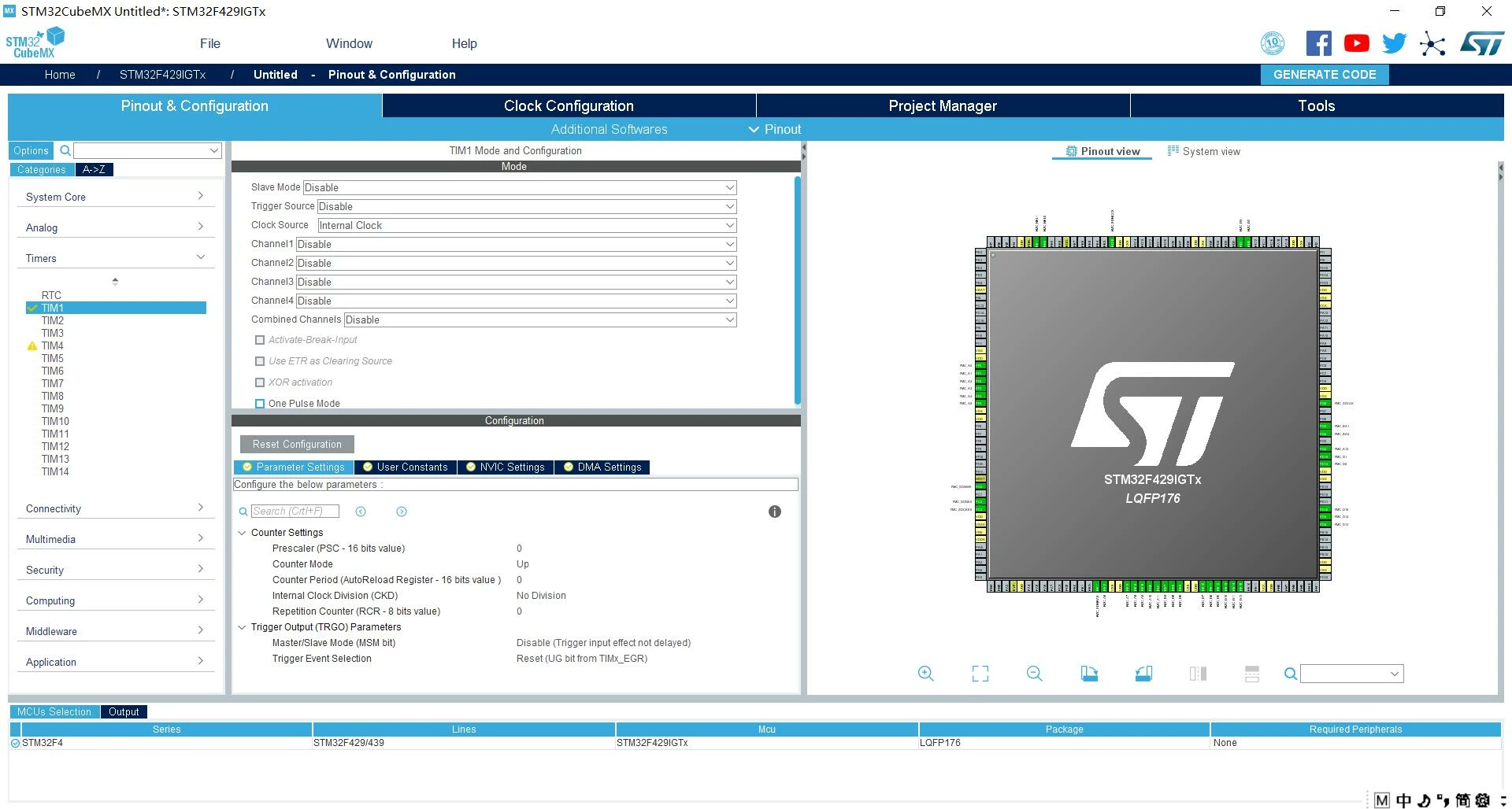

7 Turn on TIM1 and leave the settings by default.

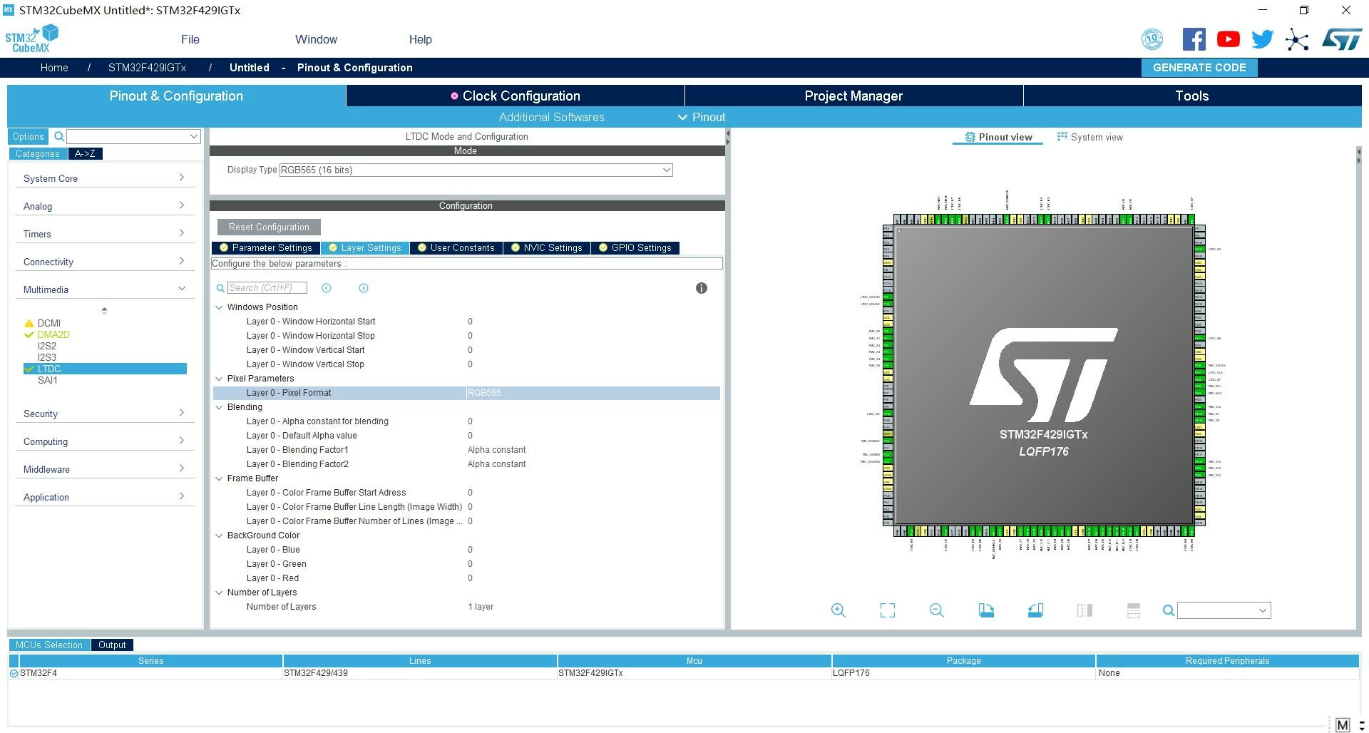

8 Turn on LTDC and configure layer 0 - pixel format to RGB565. Leave Parameter Settings by default.
9 Select TouchGFX as the Graphics Framework. Select LTDC as the Display Interface. Select the path of TouchGFX Designer 4.10.0 .

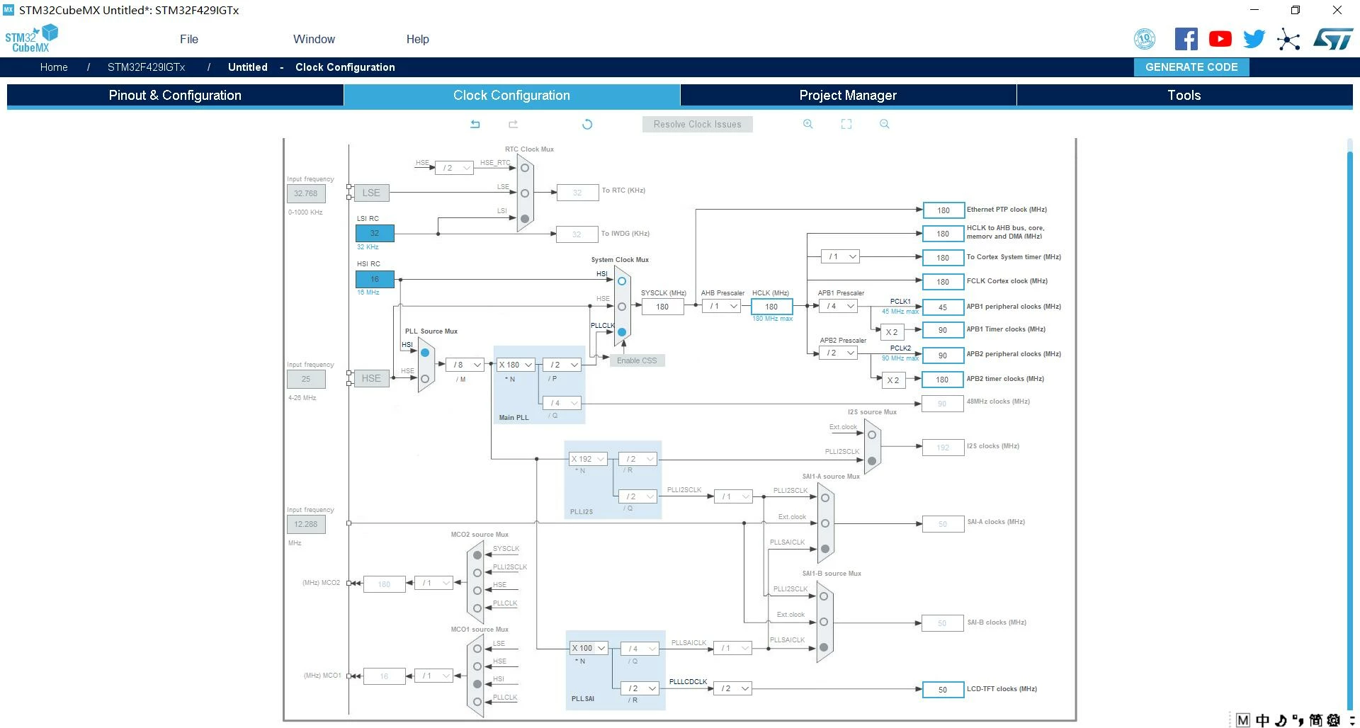

10 Manage the clock configuration.

11 Enter a project name and select TrueSTUDIO as the Toolchain / IDE. Leave other settings in Project Manager by default.

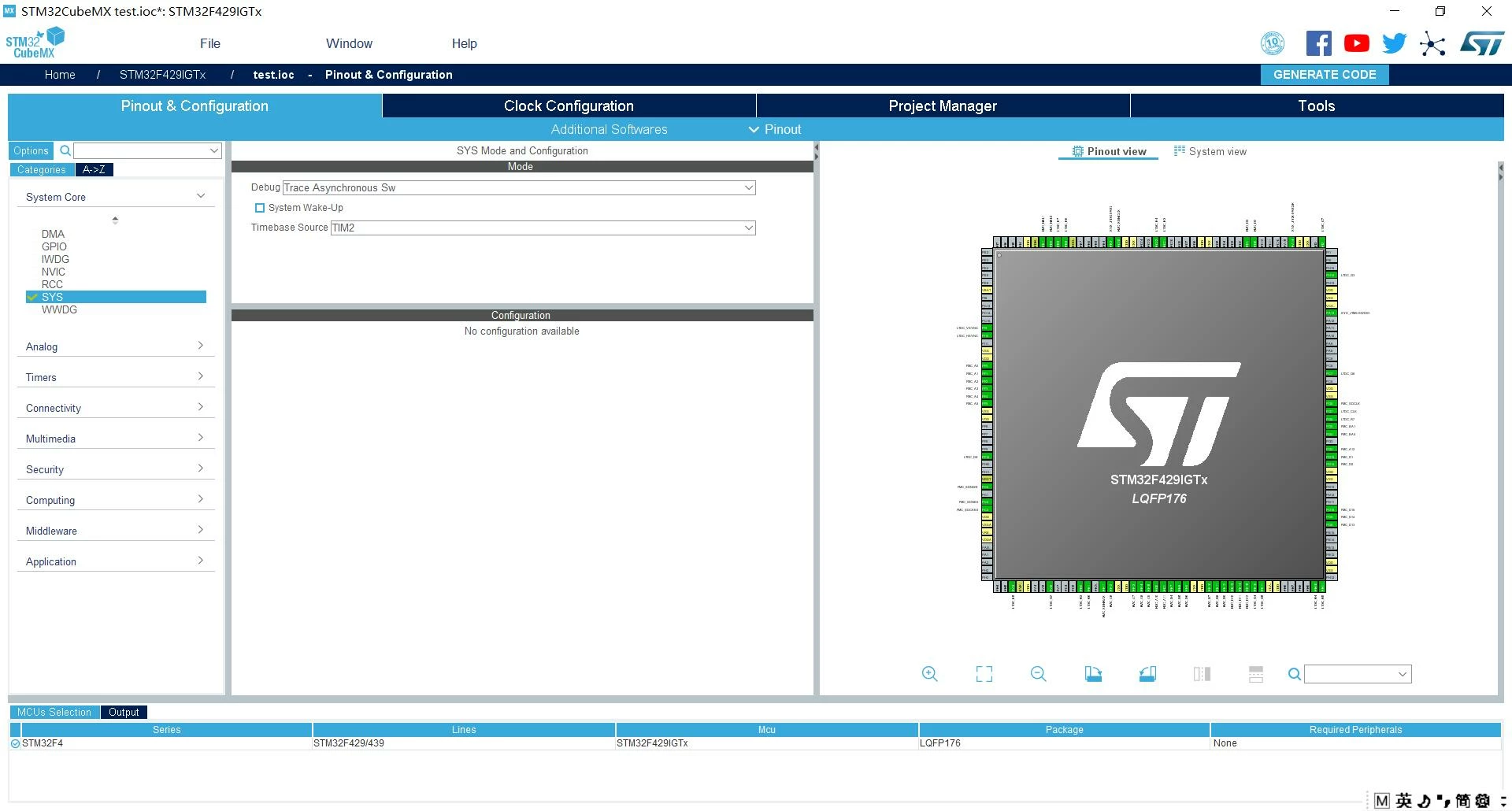

12 Set the debug type and Timebase Source in SYS.

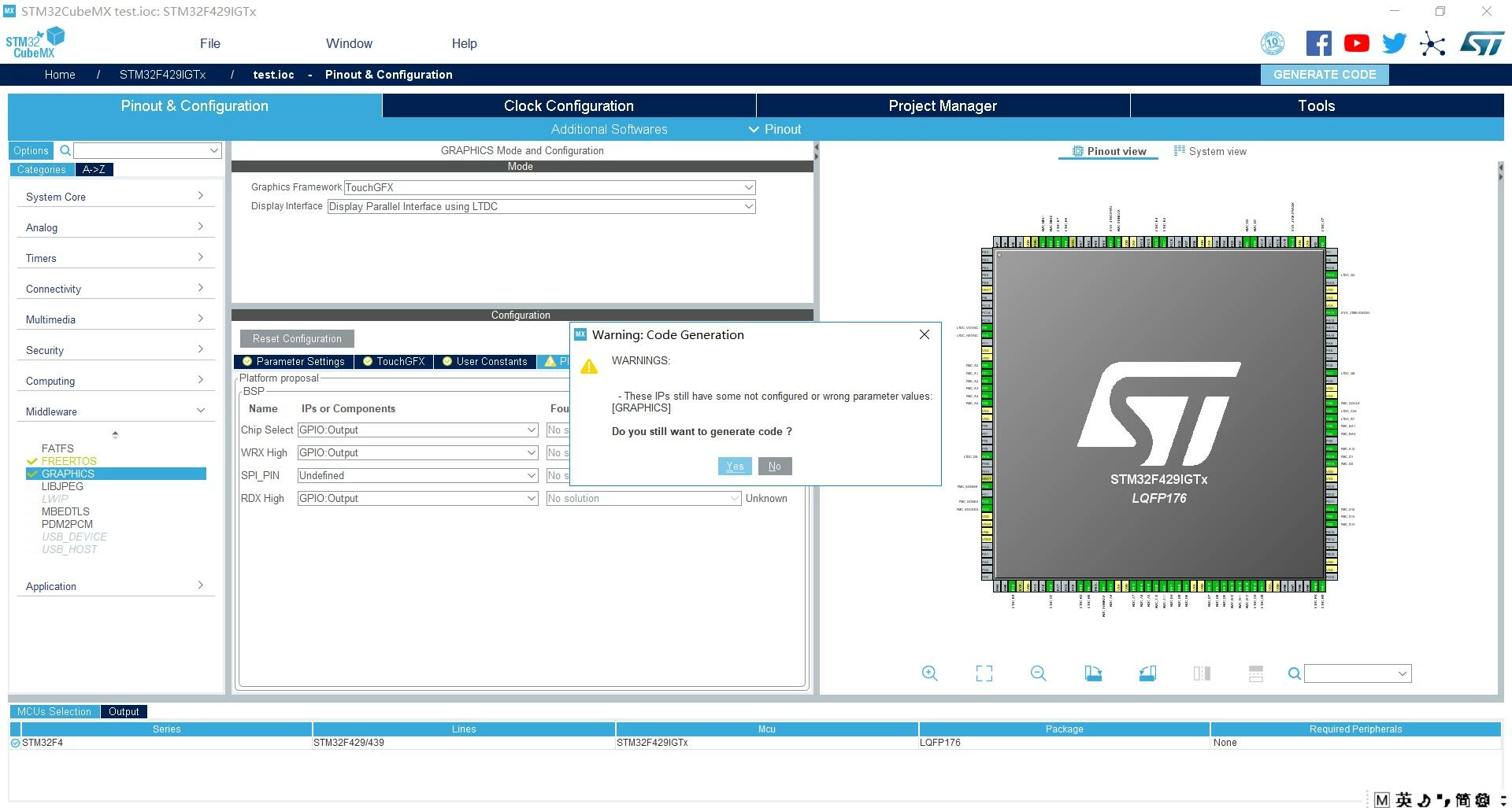

13 Click GENERATE CODE button and ignore the warning.
14 Waiting for the generating process complete the choose close.

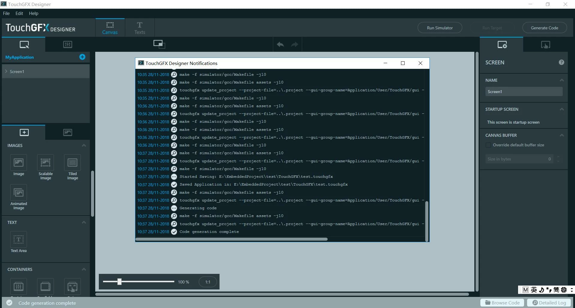

15 Click the Execute button to open TouchGFX Designer since it can be use after code generation.

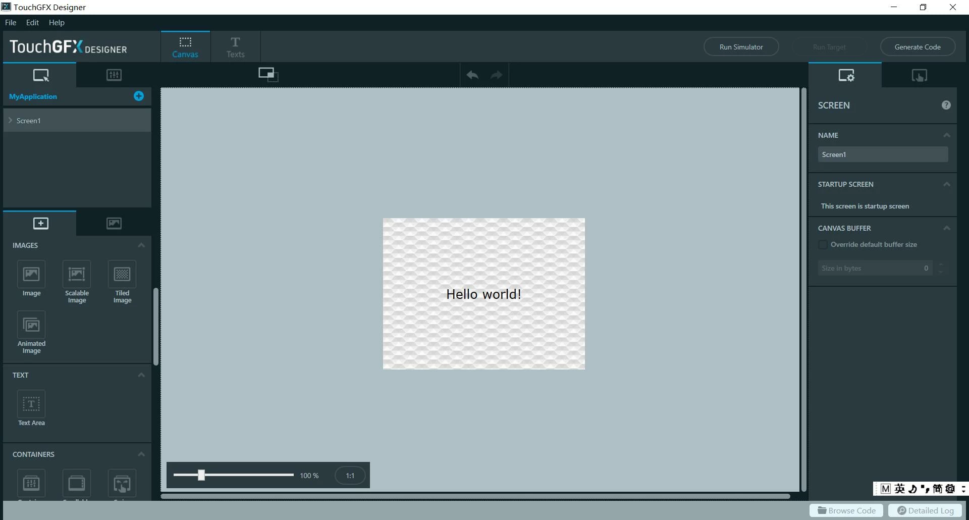

0690X000006CUt9QAG.jpg 16 Drag a image and type a text in the TouchGFX Designer.
0690X000006CUtEQAW.jpg17 Clicke the Generate Code Button in the TouchGFX Designer. And then the status bar mention the process is complete.0690X000006CUtJQAW.jpg18 Open the Project file.
19 Try to build the project. And the same error shows.
20 The C++ Compiler and C++ Linker didn't come out.
