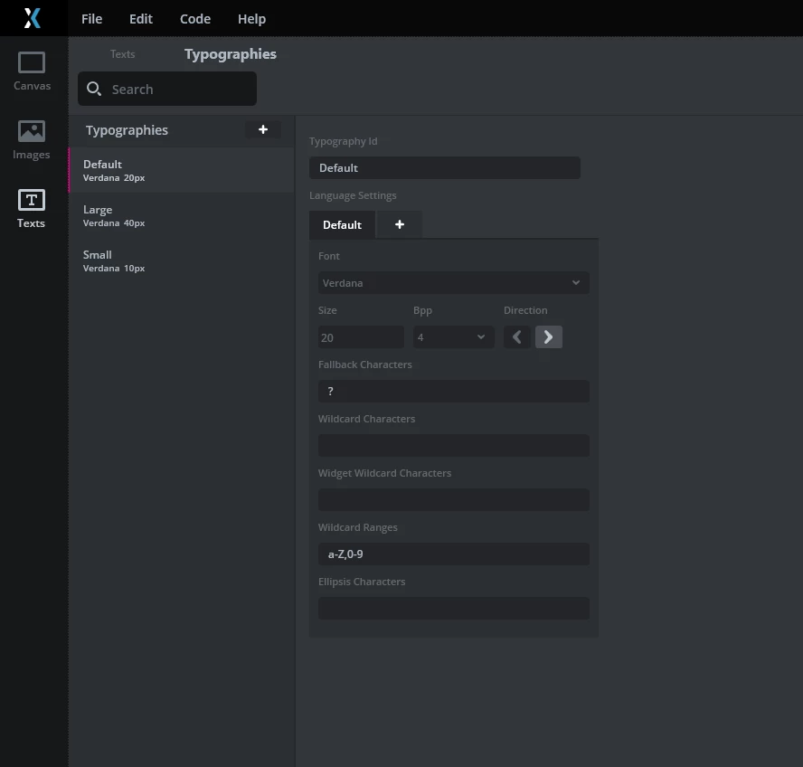

Yoann KLEIN
Apr 26, 2023 6:51 AM UTC
Hello @SGasp.1​,
Since you are using wildcards in your TextArea, you also need to specify the characters and data you wanna pass to your wildcard. For that, go to TouchGFXDesigner > Texts > Typography, then select the typography you are using for your wildcards and fill the Wildcard Ranges section.
E.g. if I want to pass both latin alphabet letters, and numbers to the wildcard :
I'm not sure that will resolve all the problems, but could be something that you forgot to do.
Hope it helps,
/Yoann

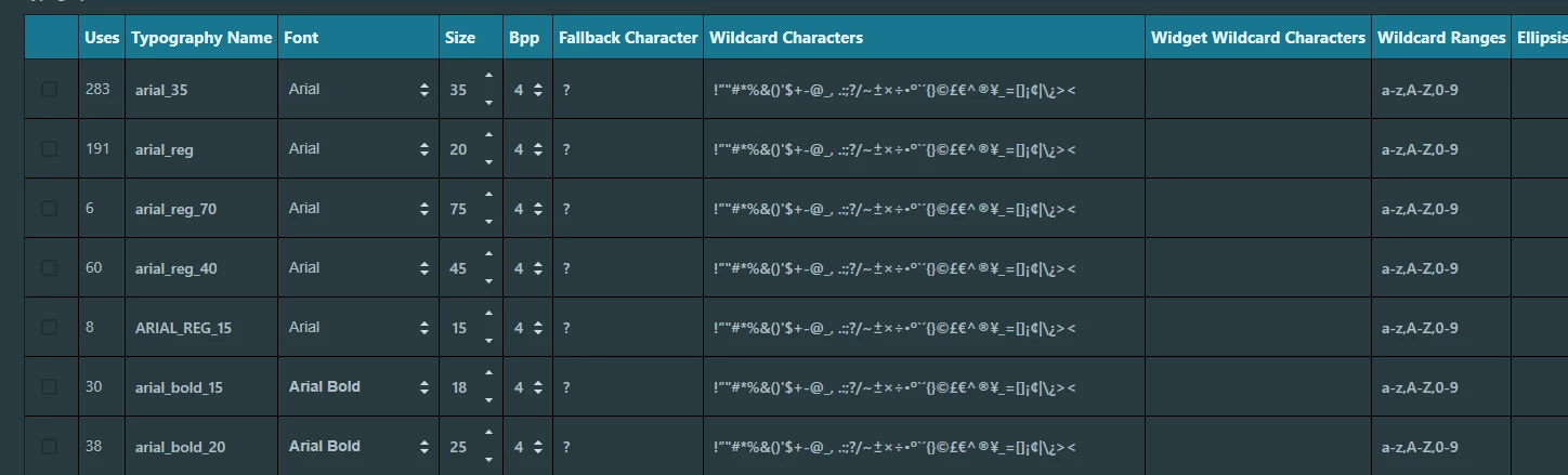

SGasp.1
SGasp.1Author
Apr 26, 2023 7:48 AM UTC
Hi @yoann KLEIN​ ..
Thanks for your answer..

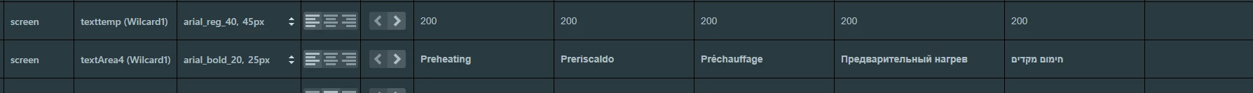

My situation is the following for the textArea4
So if i am understanding right i have to check arial_bold_20..
This is my situation
Is it correct ?
Shall I change something here ?
Thanks for the support
