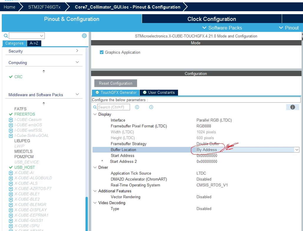

After Doing all of the suggetion given above... still i was getting Flash over flow errors.... then i checked my CubeMX Configuration throughly and found that ... In touchGFx middelware section , i have selected Buffer location as "By allocation" ..... So i changed it and selected "By address" so my errors gone.
_legacyfs_online_stmicro_images_0693W00000blC9vQAE.pngno errors coming when im not using any background image ... but when im adding background image ... im getting flash over flow error again...
