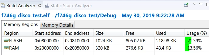

Martin,
I am pretty new with the STM32 in general. I was adding some images into your example with TouchGFX and got the following error:
............ region `FLASH' overflowed by 45788 bytes
collect2.exe: error: ld returned 1 exit status
make: *** [makefile:99: f746g-disco-test.elf] Error 1
"make -j8 all" terminated with exit code 2. Build might be incomplete.
I have created other projects with TouchGFX that used more images in the past so it is likely your example project has something setup up differently that is causing it to use the flash differently. In those previous examples, I used the TouchGFX "run target" option which had no problems. When running your example, the "run target" button is disabled.
Any ideas on how to resolve this would be greatly appreciated.
scottSD
Senior III
May 31, 2019
It looks like the flash is not setup with nearly enough flash space as is available for the STM32F746G-DISCO:
I found the following TouchGFX link discussing configuration of the STM32F746G-DISCO and it said to set this to 24 instead of 1:
https://touchgfx.zendesk.com/hc/en-us/articles/360019884752-Configuring-STM32F746G-DISCO
However, when I tried the configuration (by using the STM32CubeMX perspective in STM32CubeIDE) I got a different compile error altogether. This time, it is failing for not knowing where the TouchGFX simulator files (SDL2/SDL_video.h) . I ran into this error when trying to use STM32CubeIDE in the past and did not find a way to resolve this.
Interestingly, I ran into this same or a similar error when trying to get Atollic TrueSTUDIO to work with TouchGFS.
Any suggestions?
