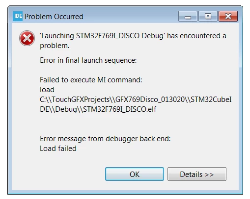

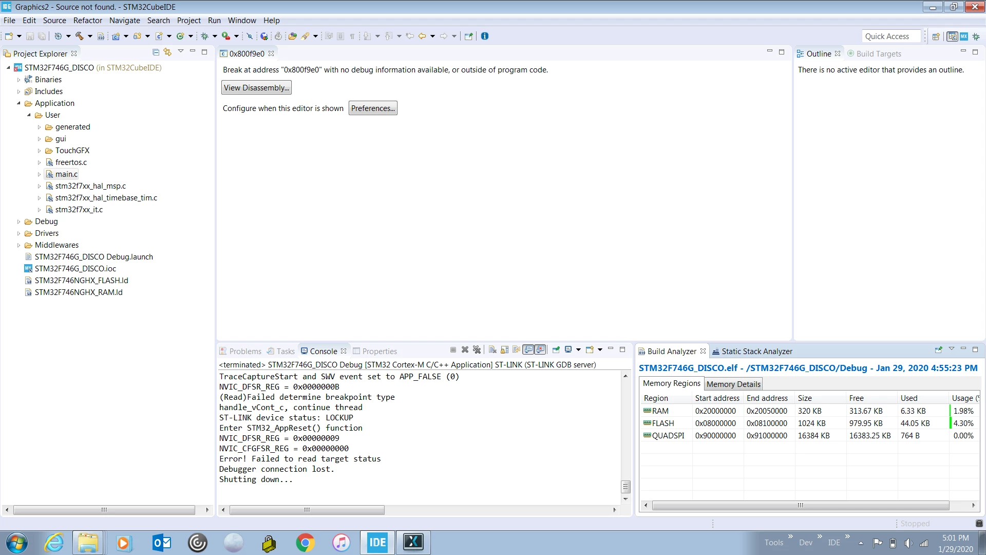

Hi -- just wondering if anyone has tried importing a project generated by the Designer to the Cube IDE, and then had any success running it using the GDB debugger on either a 746 or 769 Discovery board? Everything seems to build fine in Designer and IDE, and the projects can run on the target board directly from Designer, but I can't get the IDE debugger to work after importing them. On the 746 Disco board, I get this message, right as the switch is being made from flash to debug mode:
Download verified successfully
(Read)Failed determine breakpoint type
Error! Failed to read target status
Debugger connection lost.
Shutting down...
On the 769 disco board, I don't even get that far. There is a popup saying "Error in final launch sequence. Failed to execute MI command"...
Pictures of the screens are attached.
Maybe I misunderstand what is supposed to happen between the Designer build phase and the IDE debugging phase? I thought IDE is supposed to import the GFX generated project, create the hex code, and all is good, no? If anyone knows how to get to this stage, please share details. Thanks to all. **Cube IDE 1.2 GFX 4.13, all templates version 3**

Before i finalize this and upload it, i just want to make sure it's working for you as well in CubeIDE (Version will be bumped to 3.0.1).
Unzip the file and find a .tpa, template file inside. Overwrite your existing .tpa file at %APPDATA%/TouchGFX-4.13.0\STM32F746G_DISCO\3.0.0.
Make sure to define an external flashloader for the external flash on the F746G-DISCO in the CubeIDE debugger settings.

I know that I can get that error if I try to start the debugging before the flash is done verifying.
Usually there's a percentage in the lower right corner on how far the progress is. I know it's a longshot but doublecheck that its really done with everything before you start (or resume) from the main breakpoint.

The error in final launch sequence is because the linker script generated in CubeIDE doesn't allocate a memory space for QUADSPI, so it just places all that at the beginning of the file and tries to overwrite reserved memory. Copy the linker script from the gcc folder into your CubeIDE project and it should solve that issue.

For now, manually add the startup code (.s) file to your project for linking. The issue is that Eclipse based IDEs somehow define a weak symbol for the reset handler (in the .s file), but the .s file is not in the Application Template.

Thanks a lot, this works well !

I have confirmed that this works, as Diego B. has also attested. The new tpa file, used in conjunction with selecting the correct external loader option in the debugger configuration, fixes the problem. We now have a fully integrated, seamless connection between IDE and GFX, at least for the 746 board (also of note, I am using IDE v1.3.1, for what it's worth). I will assume this is rolling out across the spectrum of all the available templates. At long last, this is a beautiful working system. Thanks to all.

I think i forgot to update the external flashloader configuration in version 3.0.1 of the AT. It'll get updated while you do it manually in the meantime.
