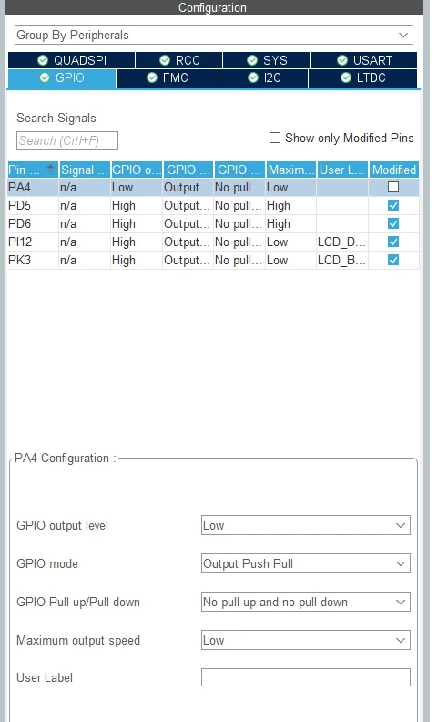

I am newbie in Touchgfx and I try developing first project.
I am willing to data transfer stm32746 to pc via usart and control pins.
When I click the button stm doesnt send data via usart or stm doesnt control pins.

I set uart2 D5 and D6 pins.115200 baud and polling connecting not IT or DMA.
I coded like you but same result . i cant send data from stm32746 to pc via uart.

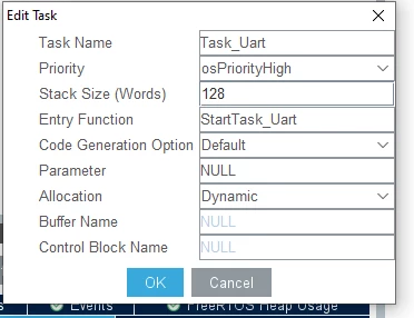

uart task i created in main.c
/* USER CODE END Header_StartTask_Uart */
void StartTask_Uart(void const * argument)
 /* USER CODE BEGIN StartTask_Uart */
 /* Infinite loop */
 for(;;)
	 if (giden[0] != 0) {//icinde deger varsa
		 HAL_UART_Transmit(&huart2, (uint8_t *)giden, 10 ,30);
		 giden[0] = 0;
 osDelay(1000);
 /* USER CODE END StartTask_Uart */

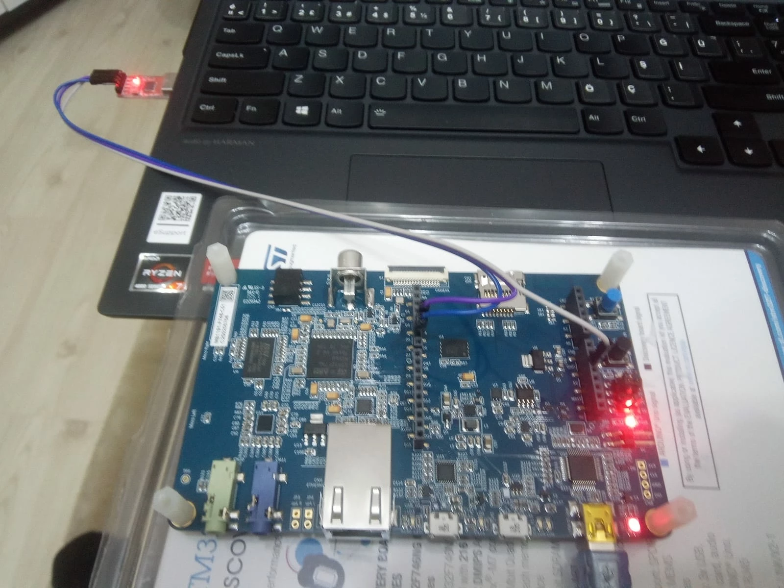

@zzzzz​ Yes this work too, but only for short strings for example on 115200 to 100 chars. Then with bigger data you need task.
@FLine.1​
And i see you maybe have problem on PC COM port , not in your code.
Please check with scope connected to TX signal.
And for connect to PC you need converting 3,3V TTL to RS232 . You cant connect directly. Plus your PC COM software must be properly set.
