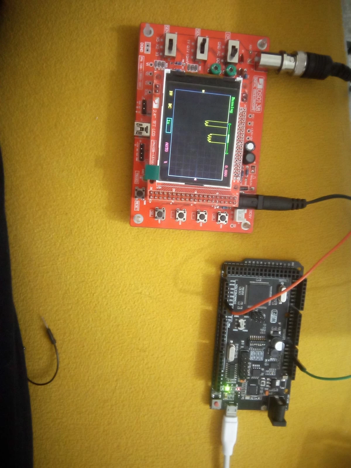

Arduino:

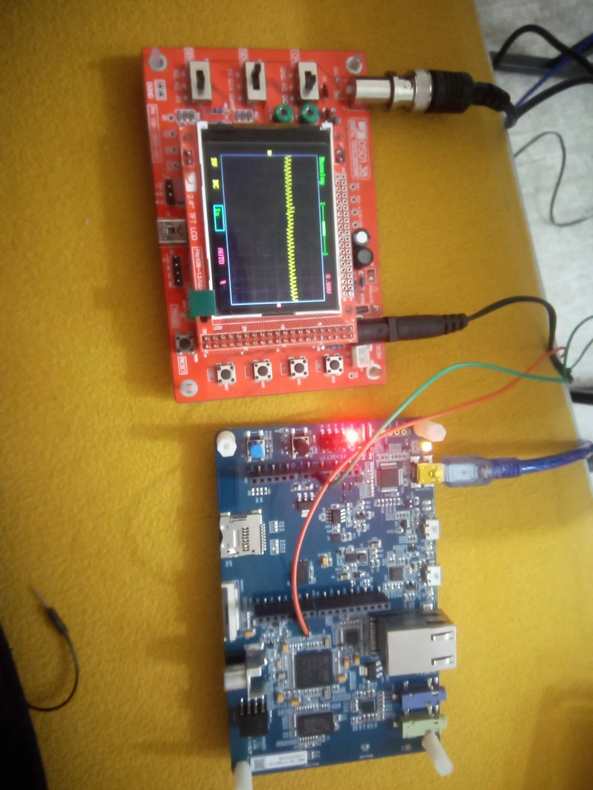

0693W000006HLSTQA4.jpgSTM:

Maybe i dont understand your photo, but where you have touchGFX display and where you click ?

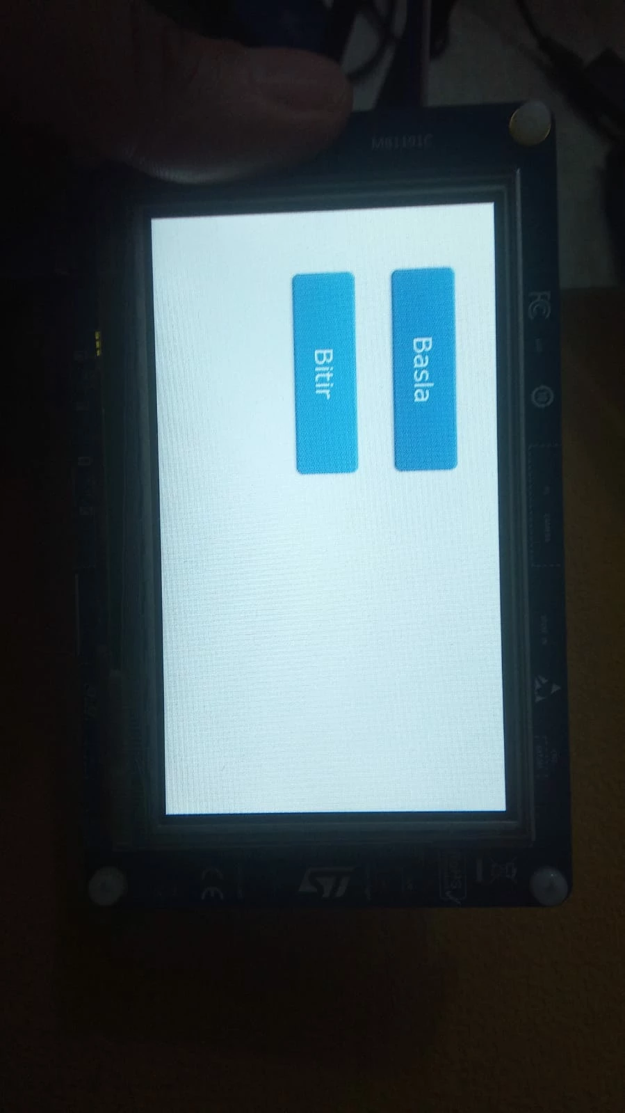

FLine.1
FLine.1Author
January 3, 2021

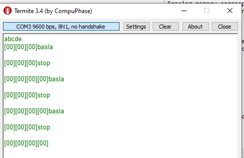

January 5, 2021
Finally
MM..1
January 5, 2021
Yes this is because
HAL_UART_Transmit(&huart2, (uint8_t *)giden,10,30);
when you not need send binary zero then change line to
HAL_UART_Transmit(&huart2, (uint8_t *)giden,strlen(giden),30);
