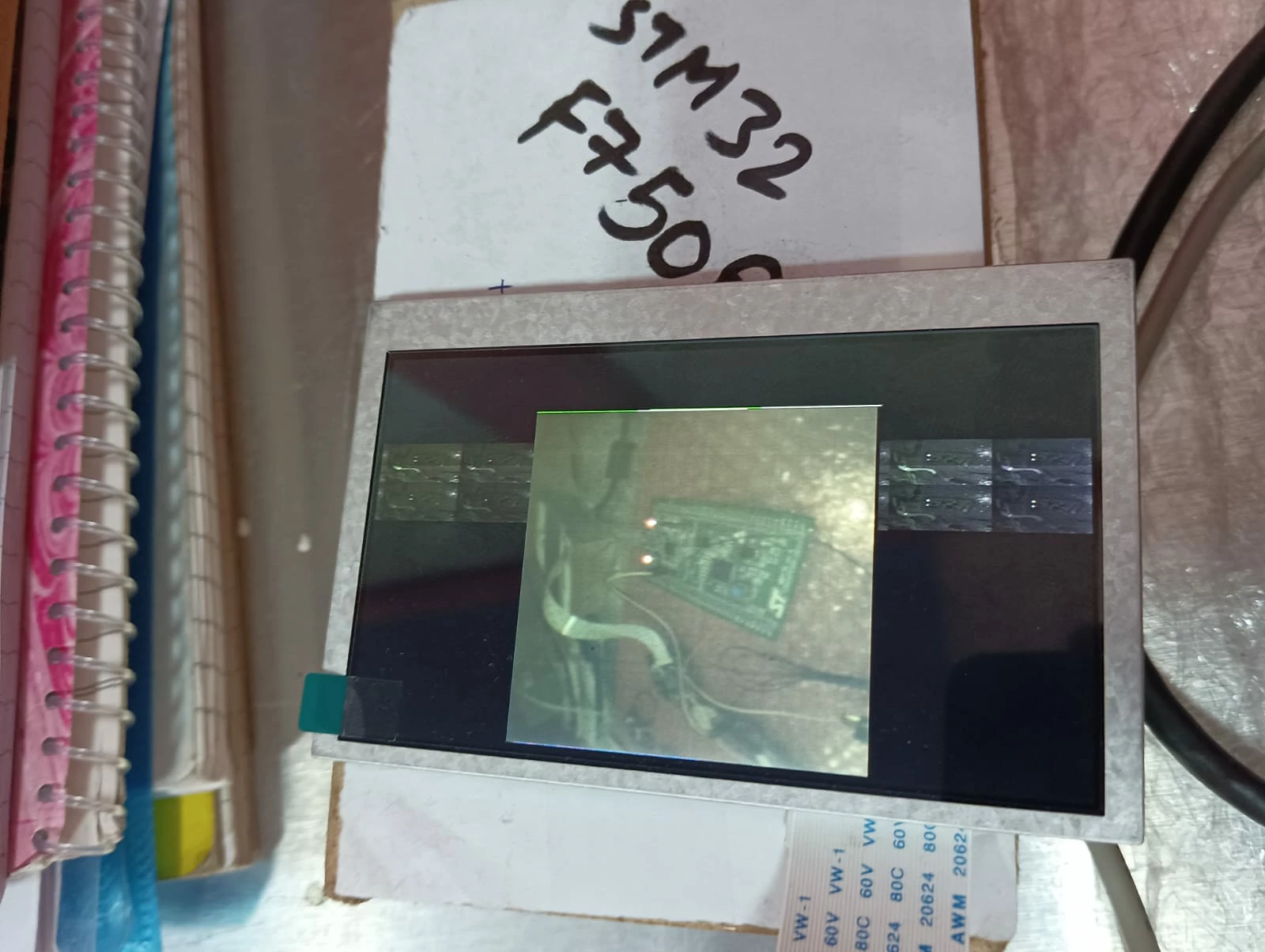

configuration camera with 800*480 "RK043HR005" lcd with stm32f7508
I'm trying to interface 400*400 camera with 800*480 lcd display.
i have done changes for lcd as per the datasheet but still im not getting output as expected.
before i have already interfaced 400*400 camera with 480*272 lcd display it's working fine, but now I'm trying to interface with 800*480 lcd.

Hello @Bhanu​,
Make sure that the VSYNC, HSYNC and LTDC clock are well configured.
I advise you, when you configured the LTDC, to get inspired from this article.

Hi kaouthar,
I have already configured VSYNC,HSYNC and LTDC clock as per the datasheet.
but still I'm not getting camera image output as excepted. you can see below lcd output image which I'm getting and please find below attached video file for your reference. 0693W00000WK95DQAT.jpgthank you.

Hi kaouthar,
i have configured the display now its working by changing the lcd and camera buffer size.
