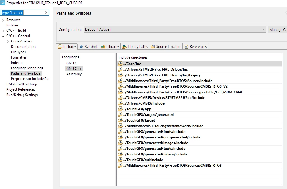

Best answer by MCA_Dev
I've managed to build the project comparing the CubeIDE setup with one generated from a ST demoboard.
CubeMX doesn't automatically include in the CubeIDE project the TouchGFX "Libraries" and the "Library Paths" that must be set manually.
These options can be found under (right click on the project)-> Properties ->C/C++ General -> Path and Symbols

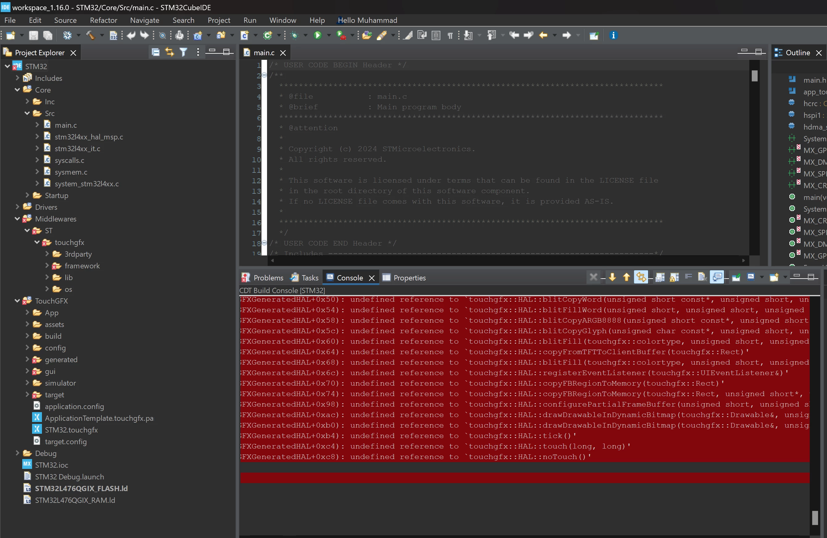

I'm facing the same issues and I'm a bit new to STM32.
Can you please help me to add library and library path? What should I add there?
Thank you in advance
