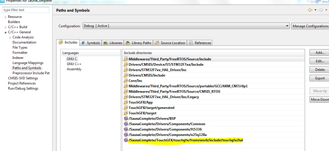

I try to build a TouchGFX project with the CubeIDE but during compilation I always get weird errror messages like that:
./TouchGFX/touchgfx/os/OSWrappers.cpp:1:10: fatal error: touchgfx/framework/include/touchgfx/hal/OSWrappers.hpp: No such file or directory
This file is definitely in the project (just like the others which create errors as well). The shortkey F3 guides me to the file. So CubeIDE in principle knows where to find it.
I already included the path - see attachment.
I'm using CubeIDE1.4.2 and TouchGFX 4.13. I know that they are not compatibel but I can't open TouchGFX 4.14. Neither manually nor automatically.

Could you check if the library is correctly indicated in the libraries and library path tab ?
/Alexandre

Hi Alexandre,
indicating libraries and library path manually doesn't help. Now I reinstalled CubeIDE and repeated it, but that didn't help as well. Creating a TouchGFX with CubeIDE still leads to weird errrors that files can't be found which are definitely defined..
Implementing a Project which was created by TouchGFX works but this shouldn't be the workflow...
