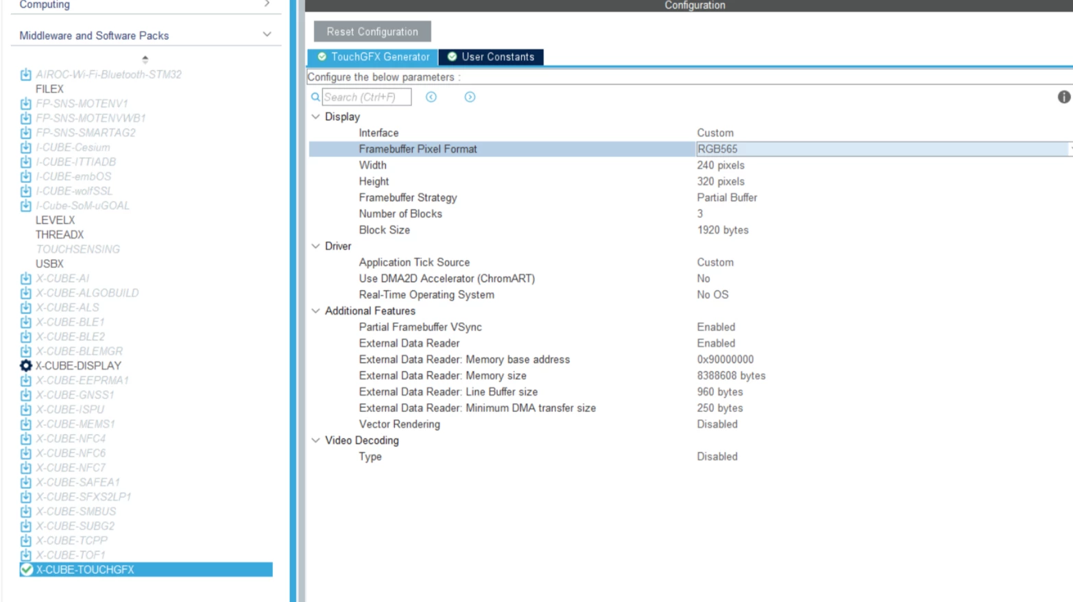

I'm trying to avoid memory-mapping my external memory. I've modified the block copy function to directly read from the memory using HAL, but when I set up Extra Section in ExtFlashSection region, the framework seems to bypass the block copy and use direct memory access instead. However, the "Section" region, which also resides in external memory, is still being read correctly via custom blockcopy.

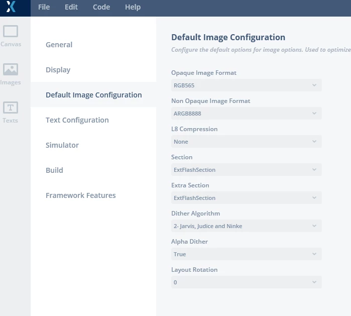

Hi Gaetan,  I've done even more tests to answer you, so now consider this situation:
1) Full black background (RGB565): no problems, it works both using internal memory or external flash throught my BlockCopy function.
2)  Black background with tranparency (any) (ARGB8888), as you mentioned:
  • Section int | extra section int => success
  • Section ext | extra section ext => hardfault
  • Section ext | extra section int=> hardfault

 This is my Designer configuration:
This is x-cube-touchgfx configuration in STM32CubeMX :

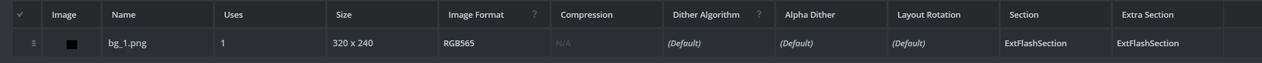

This is the image section:

Can you try to change your images so that the black area is a color (ex: red) instead. Because, by default, the background of a TouchGFX is black. This will help us verify that everything worked properly when it does run correctly.
The extra section should be useless if not using L8. However, for image 1, your extra section is 75Kb. Can you check what those 75Kb are, what data is in there.
In your first post, you show a hardfault at the function blitCopyAlphaPerPixel but after, the hardfault is at blitCopyARGB8888solid. This function converts a ARGB8888 image into a 16 bits bitmap and copies it into the frame buffer. However, the "solid" at the end of the functions means that no transparency have been detected.
Also, for your information, first blockcopy is called and then blitCopyARGB8888solid.
Can you try to debug your blockcopy function, try to, see what size is asked, what the data looks like, etc.
Can you try to set the image without transparency to ARGB8888 and see if it runs.
Also, see if you get hardfault at blitCopyARGB8888 or at blitCopyARGB8888solid to see if the image is considered with or without transparency.
Finally, can you check that your images are actually what you want them to be (full solid color for one and half solid color plus half transparency for the other one).
