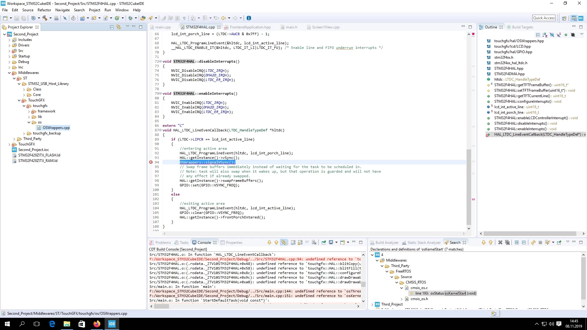

Hi
I am trying to use TouchGFX with my 32F429IDISCOVERY, DISCO1 according to the video https://www.youtube.com/watch?v=VOs2LYO7wSA) and the description https://touchgfx.zendesk.com/hc/en-us/articles/360021620431-Configuring-STM32F429I-DISCO
I use STM32CubeIDE Version: 1.0.2 and TouchGFX 4.12.2
Unfortunately It does not work still I have the following errors.

Martin KJELDSEN
Principal III
Nov 7, 2019 8:19 AM UTC
Some of those linker issues could stem from the fact that you did not "Generate" Code from within the Designer. Since 4.12.0 users have to generate code manually.
Other errors seem to stem from the fact that you are not compiling the source code for FreeRTOS. Check that the files are present in the project.
/Martin
Martin KJELDSEN
Principal III
Nov 8, 2019 7:46 AM UTC
Can you find OSWrappers.cpp in your project? That's where the missing symbol is coming from.
/Martin
Artur_B
Artur_BAuthor
Nov 8, 2019 1:46 PM UTC
Martin KJELDSEN
Principal III
Nov 8, 2019 2:09 PM UTC
Is your project set to compile C++ or just C ? Seems like there are a lot of symbols from cpp files missing.
/Martin

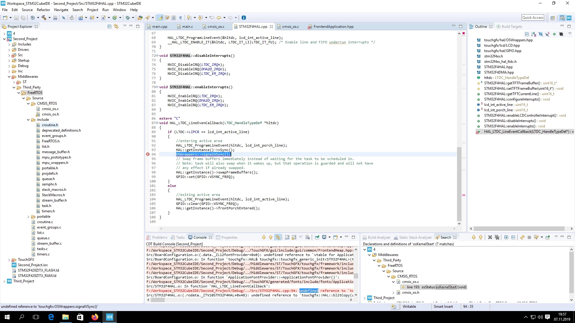

BZab
Visitor II
Nov 14, 2019 8:41 PM UTC
I'm having the same problem on F746G. I've succesfully built and loaded demo from: https://community.st.com/s/question/0D50X0000At0N95SQE/cubeide-100-touchgfx-4100-working-project-inside-stm32f746gdisco
Then I've added few more GUI items, generated code in GFXDesigner and saved .ioc, generating the code.
In STM32F7HAL.cpp I get few undefined references, all to touchgfx::OSWrappers methods.
To linker's path variables I've added new one: ${PROJECT_LOC}\Middlewares\ST\TouchGFX\touchgfx\framework\include
And OSWrappers.hpp is in: /Middlewares/ST/TouchGFX/touchgfx/framework/include/touchgfx/hal/
Adding path variable didn't help.
However GPIO.hpp included from the same folder doesn't throw undefined references error.
EDIT: In example project, OSWrappers.cpp was excluded form build, what led to linker errors. To fix it, had to right click the file in project tree and then edit Resource Configurations.
