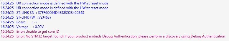

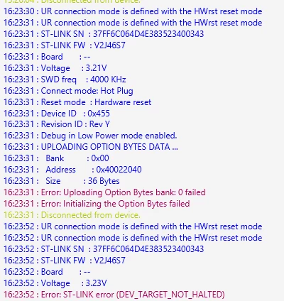

I flashed a custom secure application with TFM onto the device, but it was not working. I wanted to disable TrustZone and return the chip to a “normal” state. Following AN5347 (Section 9.1.2) and an ST Community post, I attempted to perform a regression.
Everything worked until I set the RDP to Level 1. However, after power-cycling the target, I could no longer connect to the device. Regardless of how I reset the target or change the ST-LINK connection mode (Hotplug, Under Reset, etc.), I only receive errors such as the following:
BOOT0 to VDD:
BOOT0 to the ground:

Best answer by Lezhi
The issue is resolved — the BOOT0 pin was not properly connected to 3.3V.
Sorry for the bother.
