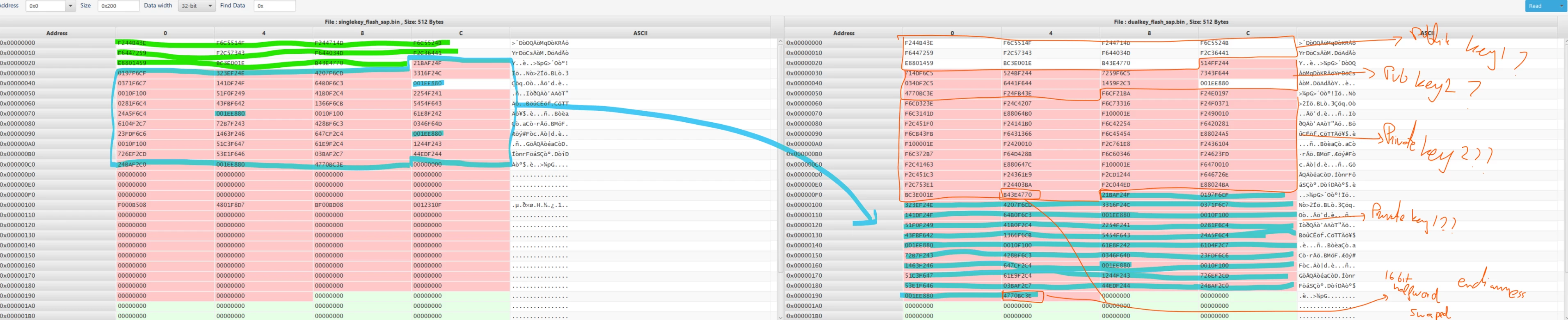

when i compile SECcore & SBSFU for two sets of identicall keys i was expecting duplicated flash memory content, but it seems prepareimage.py modifies nonce.bin each time is called? anyhow, it creates different key.bin for the same keys
