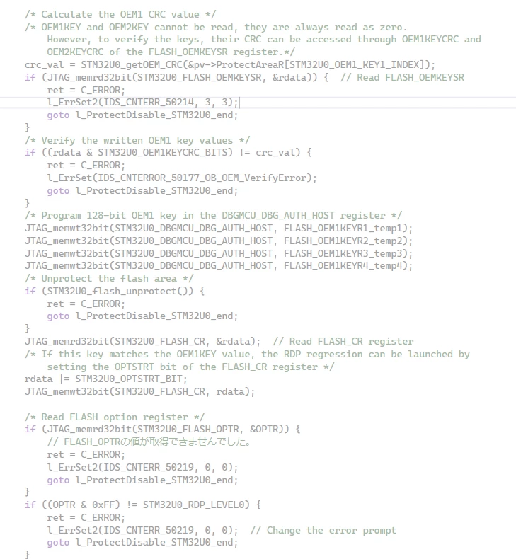

Hi teams,
CPU: STM32U0
Current RDP level: Level 1
OEM1 RDP lock: Enabled.
I had set the 128bit OEM1 key to the OEM key registers  [FLASH_OEM1KEYWyR ]accordingly, and the written OEM1 key values was verified using their CRC values by reading  OEM1KEYCRC register.
Now I am trying to make the regression from level 1 to level 0 according to the user manual description [section: 3.5.1 FLASH read protection (RDP)].
But the operation was failed using my source code. Which is attached below
#define STM32U0_DBGMCU_BASE 0x40015800 // Accessible to the software via the APB access port AP0
#define STM32U0_DBGMCU_DBG_AUTH_HOST (STM32U0_DBGMCU_BASE + 0x100) // Debug authentication mailbox host register
Could you please clarify the following doubts,

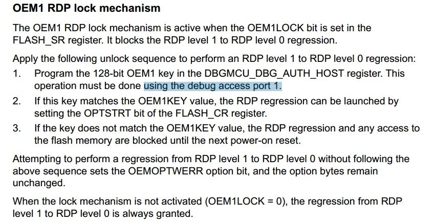

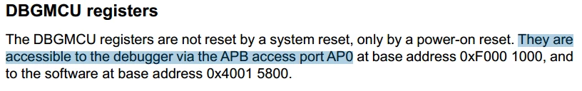

1. The unlock sequence says, debug access port 1 has to be used for programming the 128-bit OEM1 key in the DBGMCU_DBG_AUTH_HOST register,
but when I checked the  DBGMCU_DBG_AUTH_HOST register base, it says
So, what is the base address for DBGMCU_DBG_AUTH_HOST register and which AP should be selected during OEM key write process.

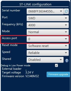

2. After connecting the target from the following settings via STM32 Cube programmer. I have tried to change RDP level using secure programming page.
What could be the reason behind this?

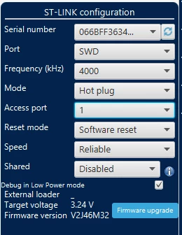

3. If I select the AP to 1, target connection is not feasible and the following error prompt was occurred.
Right now the flash memory is not accessible, please let me know how can I recover from this issue.

Hi @Akhil0812,
I believe the problem is setting 'Mode: Normal'. Normal mode is indented for normal debugging. For regression, the connection mode should be 'Under reset'. This way the code is not executed and regression can proceed.
BR,

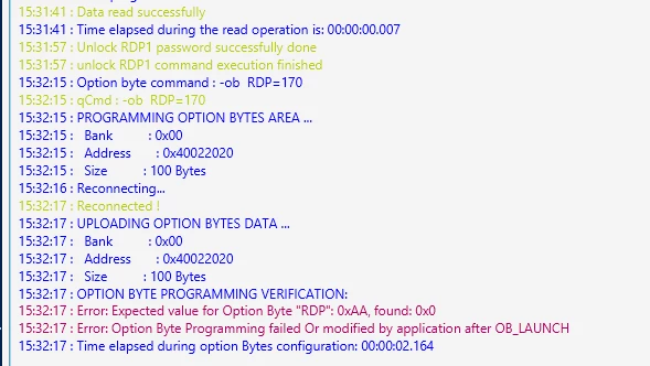

2. And I have tried to make the RDP regression according to the steps mentioned in the  UM2237 User manual,
and the result is as follows,
Upon connecting to the target, the RDP level was recorded as 0. Subsequently, when I attempted to modify the OB RDP level to 0xAA immediately after writing the OEM1 key, the following error was observed.

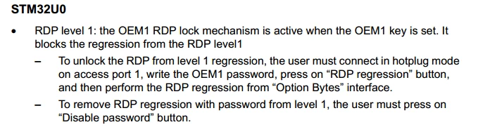

Additionally, after clicking "Unlock RDP1", I notice that the field "The OEM1 lock mechanism is" says "not active" when connection via access port 1 but "active" through access port 0! In both cases, regression from BB to AA via OB window always leads to the same error ("Option byte programming failed Or modified by application after OB_LAUNCH"). And the application does NOT change anything regarding the OB.
The different documentations are not consistent. And the scripts given in UM2237 Rev 28, §3.2.31 don't work either.

I made a test on a Nucleo U083RC.
It looks like you need to use ap=1 to provide the key.
Then to set RDP=0xAA, you need to use ap=0
Providing the password:. Here ap=0 and ap=1 both work

Regression with ap=0 or without specifying ap:
STM32_Programmer_CLI.exe -c port=SWD mode=HOTPLUG -ob RDP=0xAA

I made one more test. What I could see:
You need to use ap=1 in the command only to provide the password when device is in RDP1.
If you use ap=1 to set the password, programmer returns ok but password is not actually set.
So, when changing the password, I would suggest first disabling the password (I used GUI Disable password) and then provide new password. You can then double check password is active with same GUI.
I didn't have issue flashing the target after regression.
I used the GPIO toggle example to check firmware was running find. So, after setting RDP1, I power on reset the board to make the led blink again.
Then I provide the password with ap=1, then -ob RDP=0xAA on another command line.
Never had any issue.
The result of -unlockRDP will always be success. You can only check password provide is the good one by performing the regression. If it works it means password was ok
