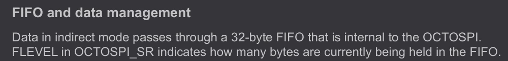

Just to be sure, I read this in the reference manual. It seems to be used only when XSPI FIFO is used to transfer data... but in my case I am using DMA transfer.

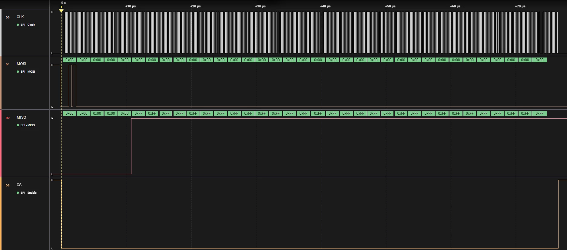

Just to clarify, when I tried to read 32 bytes, I can see the frame on the XSPI peripheral... Here is a screenshot of the logic analyzer. When I tried to read more than 32 bytes, I cannot even see the frame on the MCU pins.

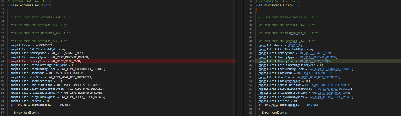

After spending some time reviewing the OCTOSPI peripheral configuration, I realized that the memory size was configured incorrectly.
After changing it, it seems I can send any number of bytes through the DMA peripheral.
Thank you. I hope this will at least be useful for other people.

The FIFO is sized into the targeted product, typically either 32 or 64 bytes depending on the product.
For the STM32H5 series, the FIFO size is 32 bytes.
If the burst size is 32 bytes, the FIFO threshold should be set to 32 bytes. In the read operation, when the FIFO accumulates 32 bytes of data, it triggers an interrupt or a DMA transfer to read the data.
Note that it is recommended to set the FIFO threshold to half of the FIFO size buffer to ensure that there is always sufficient space in the FIFO for receiving or sending a new burst of data.
For more explanation, look at How to configure FIFO with the OCTOSPI interface FAQ.
